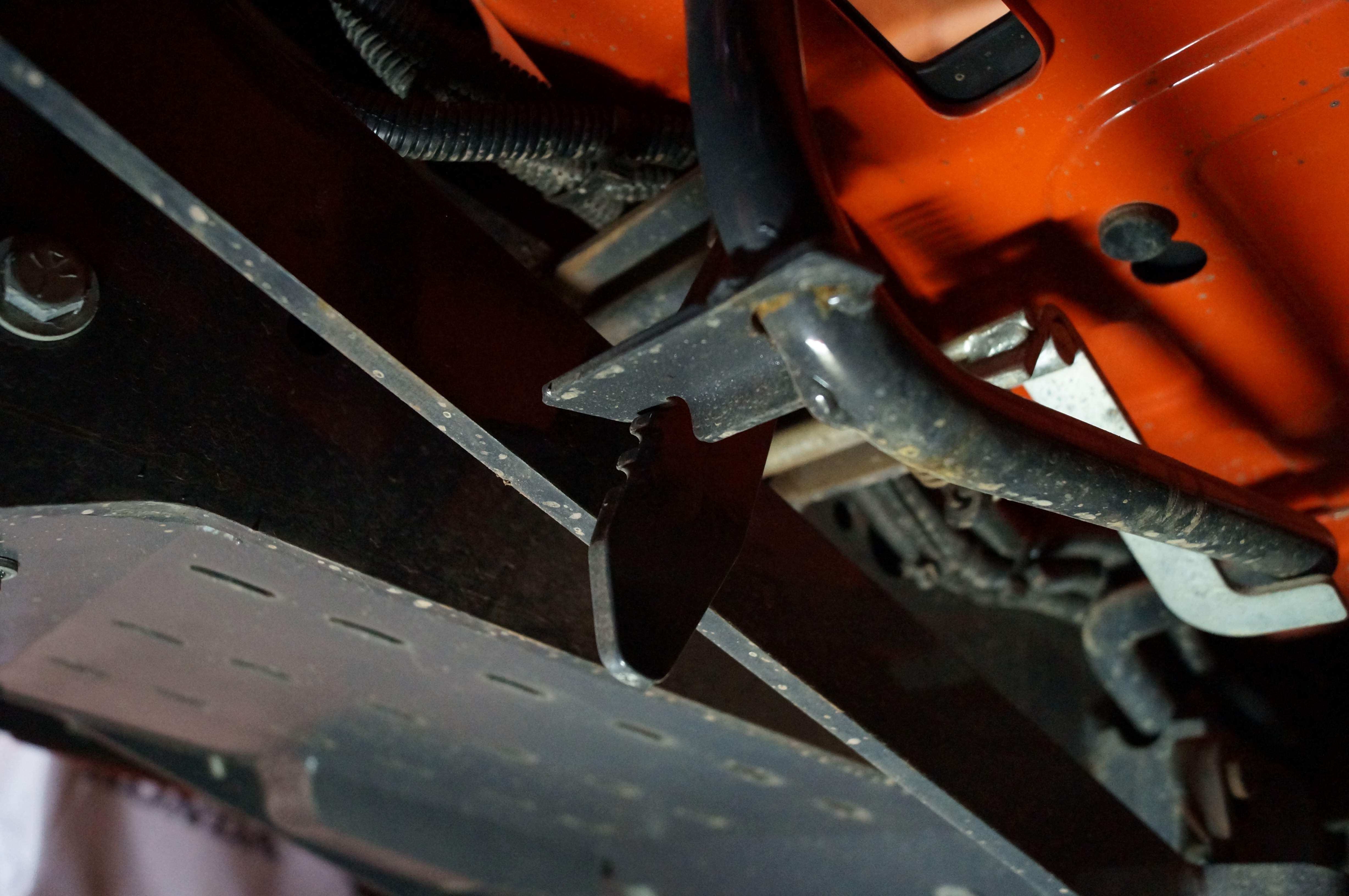

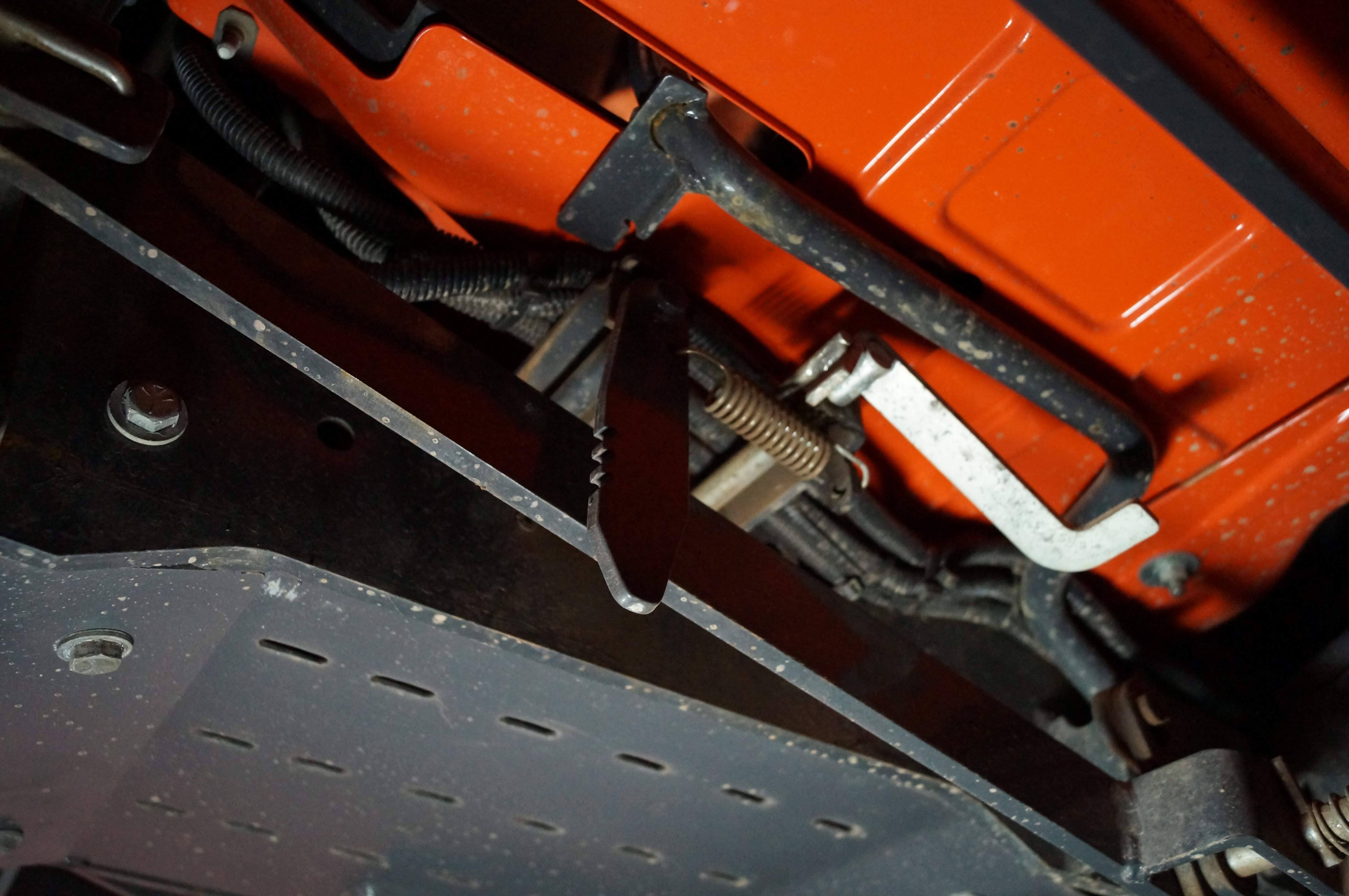

Now if I can just figure out this dang parking brake problem. :confused3:

Okay guys! Hoping someone would chime in on this parking brake issue before morning! Otherwise I guess I am headed to my local dealer to climb under a new BX on the lot and take a look for myself. Yeah I know... why didn't I do that today while picking up filters? :mur: With all you BX guys out there though I thought I was going to get answer almost immediately. This conundrum (which shouldn't be) is bothering me.

I didn't know you needed a photo? You should have emailed me! I don't follow threads much on here anymore and it's 4:30am here but as soon as I get out I'lol snap a few photos of the park brake system on mine for you.

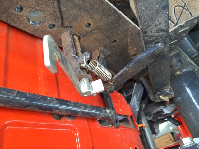

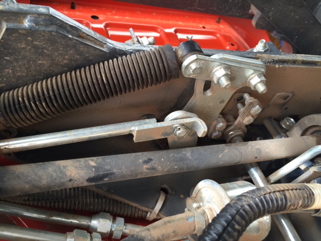

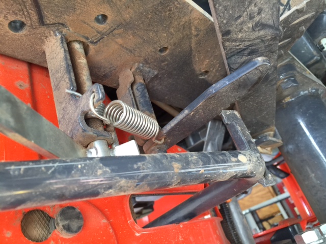

Here's a few photo's of the parking brake set up. I couldn't get any of the middle of the machine due to the skid pan. Insistently the silver piece you see is for the cruise if you were wondering. Last photo shows the park brake in the "On" position.
