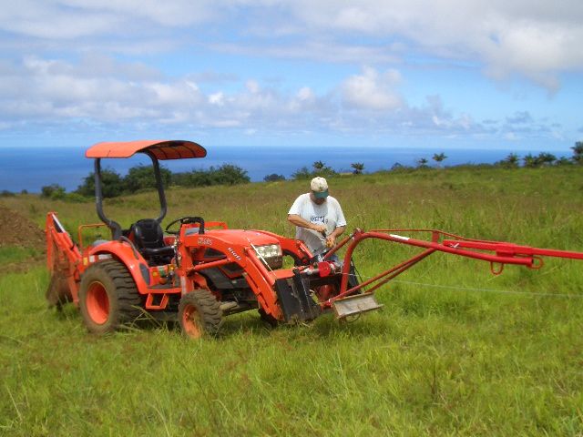

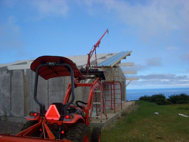

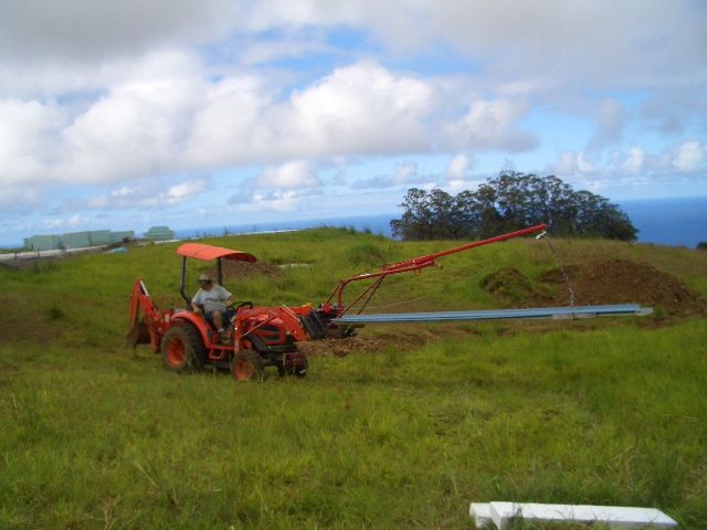

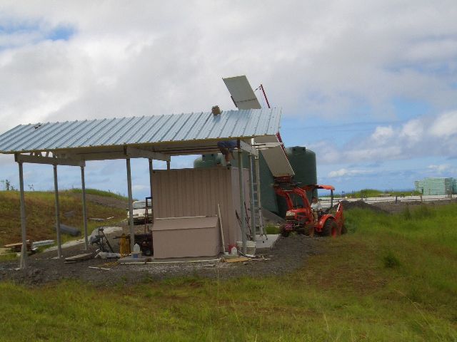

Here's some pics of my attempt. Boompole w/extension on quick hitch on FEL quik attach. I also used a 12vdc cable winch that I could control from tractor seat. Put up a bunch of wooden beams, positioned some 4K gallons tanks, placed over 8K sf of roof panels. Always took our time, checked everything and put safety first. This was my only "crane" for entire house build.
Best of luck with your project
David
