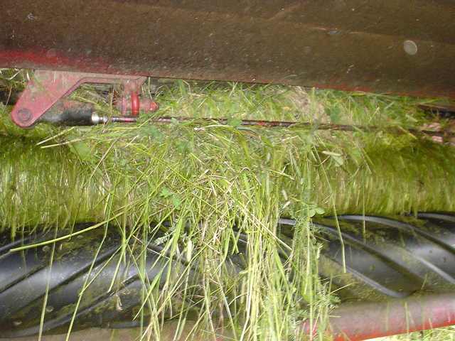

Well we had some fun last night, anyone have any tips for preventing the conditioning rollers from plugging when the rubber has come off them?

You knew it was clogging as soon as the hay started spitting over the top. This is a NH 489 haybine. I got home to find the other users of it broke the cutter bar at the ball joint. We found a junk bar with a good ball joint on the end so I only had to pull it out a couple of feet to replace it.
Notice I have the unit picked up as high as it will go to try and clear the plug out the back. My hand is pretty bruised from yanking the lock pin in and out and hitting the lift cylinder!

Two words, disc mower. Seriously sorry to see that. I can relate to it. Before the disc mower conditioners came out I spent many a day digging out plugs. No way I would ever have another sickle bar mower.
   / First day of cutting hay #14
The bottom roller looks good.. how much rubber is missing on the top roller.. all of it? My neighbor has JD disc mower/conditioner w/ the same problem.. rubber on top roller on one side missing.. that's where it starts to clog. Besides replacing it.. I'm not sure what fix could hold up to the constant spinning crushing motion. I know the rollers have to be lined up correctly so that the top & bottom rollers grooves match w/in each other.
I thought of maybe using some type of soft foam rubber.. 2 inches thick.. then wrapping ducktape around it.. it wouldn't crush the grass much.. but maybe it would help shoot the grass out better w/out it wrapping around the roller. I've seen the replacement roller cost.. lot's of $.

I had a bit of heat stroke maybe or I was just too hot but I set the lock, and sat in the shade in the discharge with my pocket knife cutting and pulling. The top lump of grass gets a reverse roll to it and get caught in the frame. Did use the claws of a hammer too to pull on it.
On the top roller I just cut it down to the steel every time. I sure wish whoever borrowed the box cutter out of the tool box brings it back! That was much faster!
   / First day of cutting hay #16
You need to start watching the rollers more closely. Our top rollers are in the same condition on the same exact machines and I watch backwards almost as much as I do forwards. If the roller starts to wrap I just stop and back up one foot and it will clear itself out. If you don't catch it in time then you have what your pictures show. Also, I have found that if it is too wet then you will have a lot of these problems. I just got in from cutting 12 acres and did not have any problems other then a plug getting caught between the bottom roller and the axel shaft when I backed into a swath. Of course the weather has been better lately and the grass is drying well. I started around 1 pm and it was smooth sailing till I quit about 30 minutes ago. Around 8 pm the dew started setting in and the grass wanted to start to cling so I shut down for the night. Good luck and remember to smile as you sit in the shade cleaning that plug out (I have done it a few times this year already /forums/images/graemlins/smile.gif)

I'm travelling in the lowest gear, watching the entire time. We cut it completely free several times and within 10 feet it had wrapped again. I tried backing up but the conditioning rollers grab hay from the windrow behind and plug it worse! Best I can do it raise it and run it for 2 or 3 minutes, it will clear the side with the rubber still on.
We are getting a neighbour with a 13 ft disc bine to knock it all down, we'll have to do something about the haybine later.
