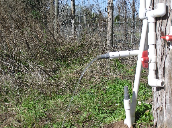

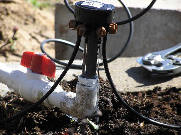

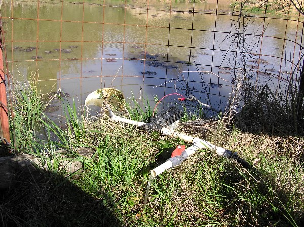

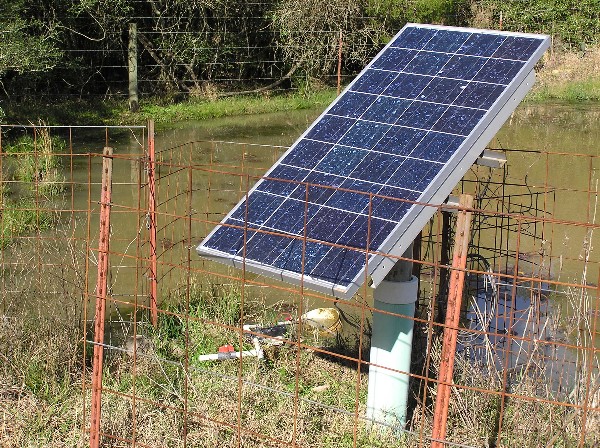

GeauxLSU, here are a few pictures I took today. I usually have the pump in a plastic box but I took it off for the picture. The fence is to keep the cows out. The Solar panel is a Kyocera 120. You can see the flow at the garden. The last picture I'm hooking up another trickle flow for the Blueberries.
Thanks txdon! It looks very nice and that it could be just the ticket! Just curious, how big is that solar panel?
The flow looks pretty decent and I'm sure would definitely help address my summer time concerns. Don't mind spending a little more either if it'll appreciable help the capacity.

[FONT=Verdana, Arial, Helvetica, Sans-serif, geneva]GeauxLSU, my solar panel is the:[/FONT]
Kyocera 120 KC
[FONT=Verdana, Arial, Helvetica, Sans-serif, geneva]Specifications:[/FONT]
  • [FONT=Verdana, Arial, Helvetica, Sans-serif, geneva]Current at max power 7.10 amps[/FONT]
  • [FONT=Verdana, Arial, Helvetica, Sans-serif, geneva]Voltage at max power 16.9 volts[/FONT]
  • [FONT=Verdana, Arial, Helvetica, Sans-serif, geneva]Short circuit current 7.45 amps[/FONT]
  • [FONT=Verdana, Arial, Helvetica, Sans-serif, geneva]Open circuit voltage 21.5 volts[/FONT]
  • [FONT=Verdana, Arial, Helvetica, Sans-serif, geneva]Size in inches 56.1x25.7x2.0
    [/FONT]
It still looks as good as the day I bought it eight years ago. I bought it with the adjustable mounting frame that tilts up and down and attached it to a 5" fence post which I set into a 6" piece of PVC pipe so I can swivel it both ways.
Link Kyocera 130 Watt solar electric panel
The 130 has replaced the 120.
Here is the link to the pump Shurflo deluxe 12 volt delivery pump

The only thing I can't figure out (or at least visualize) is the intake in the river? :confused: How would I do something to keep it trash free and I assume it should float? Again, this river rises at least 6 feet in real heavy rains and has a pretty stiff current.

The distance and height should be no problem for the suggested pump setup. I have a steady height spring fed pond so hopefully someone else that has tried something else will respond.
I attached a 2" PVC pipe to the 3/4" intake PVC with a reducer (unglued so I can clean it). I drilled many holes in the 2" PVC. I then used nylon tywraps to secure a window screen around the 2" PVC. You might be able to use the same setup revised with a flexible hose and a float on the 2" PVC.
