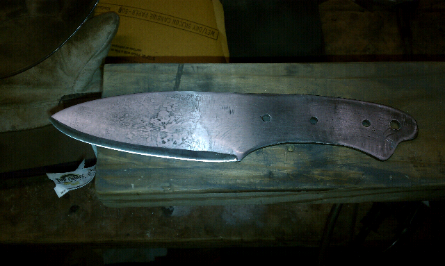

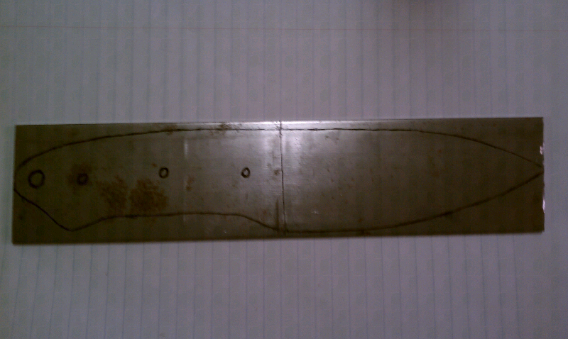

Thanks very much to all. Starting on the next one to give to my dad. Pic is of steel with outline and one with roughed out profile. Next is drilling the handle pins and lanyard holes, grind the edge and then start heat treating.

What steel/alloy are you using for the blade? Do you know how hard you are getting it to when you are all said and done?

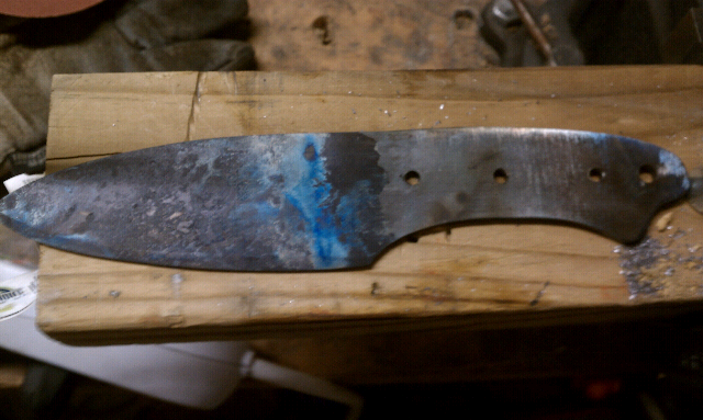

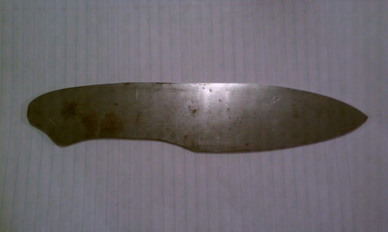

Thought I'd put a couple of pics on a second similar knife. First is a pic of the stock I use, second is after grinding and heat treating and third is after cleaning off the scale and doing some light sanding, but still able to see the effects on the metal after heat treating. Next is the handles.

Here is the third pic I mentioned.

NICE ! What temp do you heat to and how long do you quench...quench in oil or water ? where did you find the forge ? what is it's fuel ? oxygen ? sorry bout all the questions...but inquiring minds gotta know ! :laughing:
Rich
   / first knife so far. #19
Nice shape to the knife. What type of steel is it?
#20
The temp is around 1800 degrees or so, not really sure. I use the magnet test. When the metal is about whit hot I touch the blade to a magnet and if there is no attraction then its ready. I quench it in canola oil. The forge is a small fire brick I made. Been trying to post a short vid but can't get it to work. The steel is 1095.
