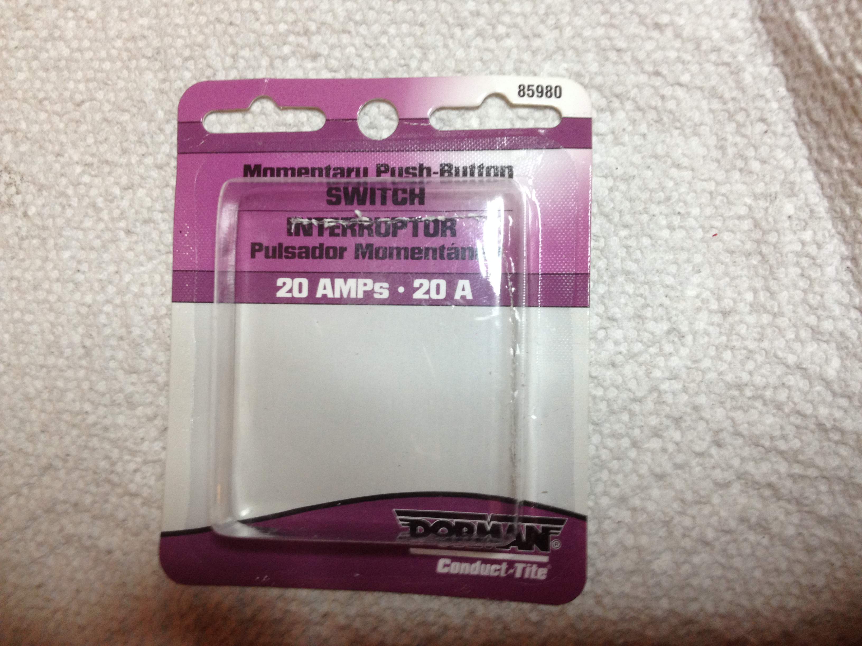

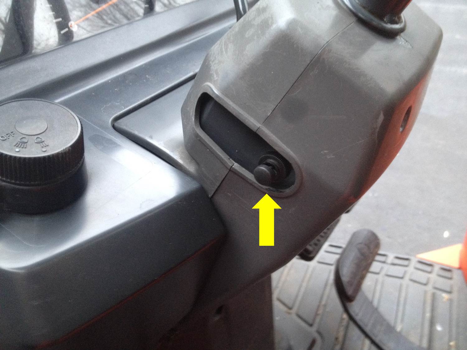

Added a cheap air horn to the tractor today and thought I would share the experience.
Bill of Materials:
1) 135 dB Super-Loud Air Horn from Harbor Freight (item#40134, $14.99) 12 Volt Super-Loud Air Horn
2) Momentary Switch purchased from Tractor Supply ($2.99)
3) Miscellaneous wire (12 and 18 Gauge) and connectors
4) 30 Amp relay (one comes with the horn but many people complain about it and recommend using higher quality)
5) 30 Amp Fuse Holder (12 gauge wire size)
6) Wire ties
Overall it went fairly uneventful once the switch, compressor and horn locations were selected. Only one hole needed to be drilled and that was for the switch. The compressor, relay and homemade horn bracket used existing attachment points.
The horns were mounted to the headlight assembly and sit below the lights behind the grill (basically in front of the battery). A piece of 1/8" x 1" x approximately 12 long piece of aluminum was uses to hold the horns to the headlight assembly studs.
The Compressor was mounted to the left of the battery (while facing front of tractor) on the off-white radiator/hydraulic cooler support. It is out of the way and there was an existing mounting hole.
The horn button was installed on the left side (while seated) of the steering column. I'd preferred a red button switch, but couldn't find one at the 5 stores I visited. (Didn't want to wait for a switch to arrive via the mail)
It functions as it should and is reasonably loud but the sound quality is not the greatest. Then again I was not expecting it to be. It's functional & loud and therefore meets my needs.
Total cost about $25 less wiring and connectors.
Sorry I did not take more pictures, but it is plenty cold out and wanted to save time Perhaps I will have a chance in the near future if anyone is interested.
Happy New Year!
