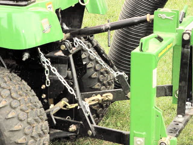

I did some mowing yesterday. I just have to remember they are back there as you could do some damage backing into something. Like the others I only lower the arms enough for the mmm to position as I have some slopes to mow. Someone put short chains on the lower links to keep them at a certain height so you could do that.

Attached is a picture of the chain stops I added to the 3 point on my 2210.

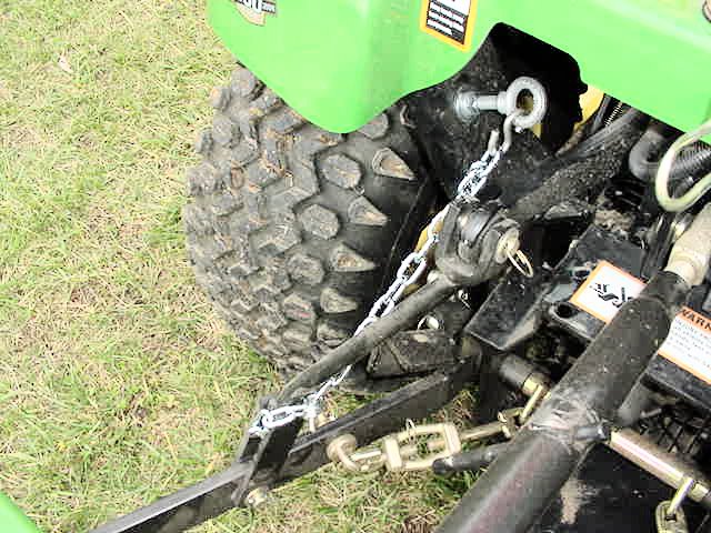

Another veiw.

For those of you that are having a problem with the link arms and hitting things, here is a solution a poster on another forum, thanks Pete /forums/images/graemlins/cool.gif, came up with. The only drawback is that the link arms need to be reinstalled for 3PH work.
