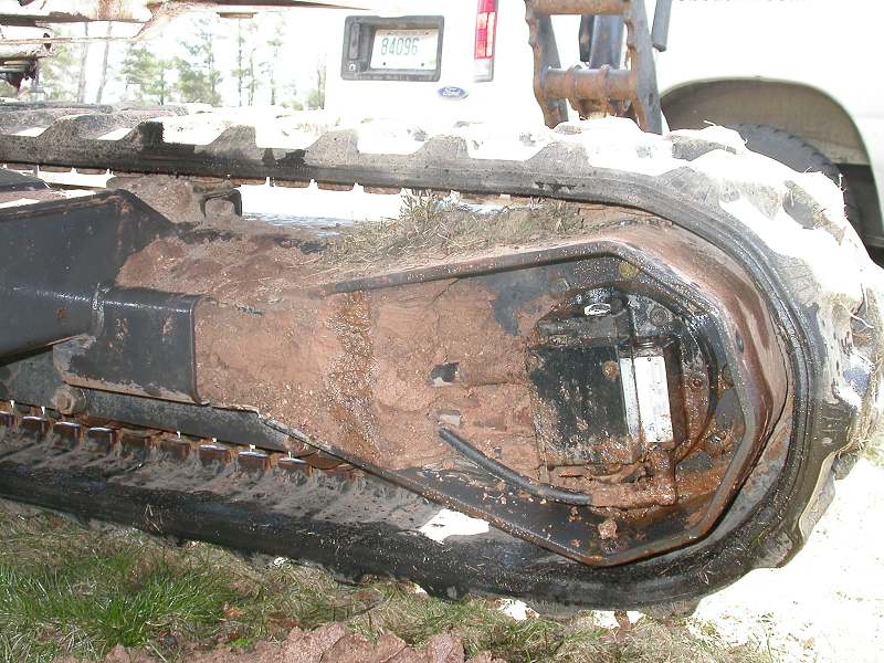

Well Ed at least now you know that it's not just a simple hose blown or a fitting loose. This hole in the side of the motor.. does it look like it's suppose to be there? As for the mud the guard is there to keep big rocks out from bashing your motor and hoses not really to keep mud out of there. WEll maybe to a minimum. /forums/images/graemlins/smile.gif My last Cat E110B was the same way.. I wouldn't think the previous owner packed it in there on purpose but I did periodically clean mine out just to keep track of any oil leaks or ???? I wonder if that is a weep hole like a water pump on a vehicle.. You know when you see a dribble there are seals bad. Well in this case a big leak. I would do as suggested earlier by Dozernut---get yourself some parts, service, repair manuals if you plan on keeping this for any length of time or if you just like learning about things. /forums/images/graemlins/smile.gif Good luck and keep us posted.

Looks like there was no preventative maintanence done by first owner. you'll have to pick up were he left off. good luck and hope it's a minor fix for ya. ask the bobcat guy what should be done and how often to keep it in good shape.

Ed that hole if it loks like its suppased to be there it may be a weep hole. Weep holes are desinged to go between 2 sets of seals incase an inner seal goes out it will leak like that. your repair may just be a seal to replace hopefully its a part there not very fond of. Just be glad its not a Cat v8 just replaced one for the powercompany that had a bad block was 8500. Ill check with a friend to see if he has any manuals he works for Bobcat. Take care Taylor Lambert

The service manager of Bobcat of New Hampshire called today. My traction motor is fixed.
The hole the hydraulic fliud was leaking from was an assembly hole plugged with a steel ball. My motor lost the ball. The fix was to tap the hole and plug it with a screw.
This is far better than what the serviceman they sent out had said. He looked at the leak and asked if I wanted express freight on a new motor or would ground shipping be ok. (He told me express shipping would only add a few hundred dollars to the cost.) He than called the service manager and told him to order a new motor.
There are a few other things which they are taking care of before returning the Bobcat next week. There were some cracks in the alternator belt and the tracks were on backwards. (I have no idea why the previous owner ran the tracks backward.)

You will find that tracked machines tend to pack the dirt around the undercarriage. What you found under the cover was no surprise. If you don't have a power washer I would recommend that you get one. Make it part of your service routine to power wash the undercarriage and pull the covers over the drive motors and clean there. This will greatly extend the life of the track components.
