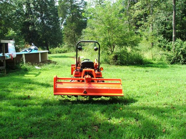

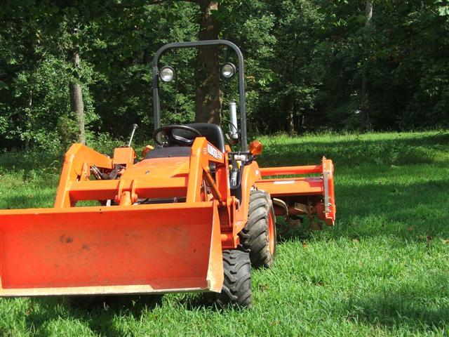

Jay, I don't think I'll try the 8' cutter, but I like the looks of the 6' tiller.:D

   / First post, smallest tractor for 5' brush hog? #17
Milkman:
That book states 7 to 15 PTO HP per foot of tiller depending on the tilling depth. I do not believe this factoid at all as my 23.6 PTO HP drives my 58" tiller through some heavy and rocky NE sod/soil (I do make two passes, 3 with virgin sod.) without difficulty and I can get down 8" in my garden. Theoretically that works out to to a 3' tiller. I believe someone (was it you?) tried this set up and said it worked. I bet a foward rotation tiller that size on your tractor would give an interesting bouncy, teeth chattering, rear end pounding ride. Who knows what a reverse rotation tiller would do? I would love to hear your tilling experiences with that setup :D! Jay

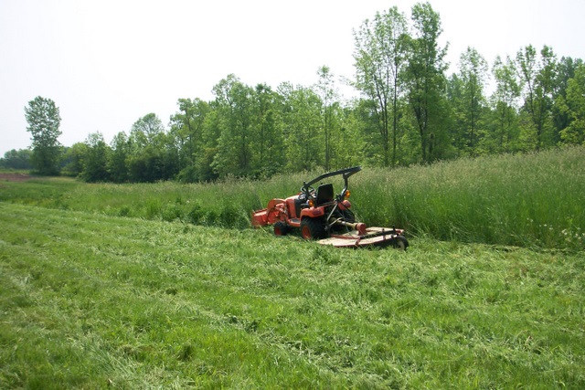

   / First post, smallest tractor for 5' brush hog? #18
I run a 5' light duty cutter on my BX24 with no problems. usually cut weed fields at a height of 3-6 foot. Many times grass is very thick in the spring and never had a problem with power. 17.7 PTO hp, by the way.

   / First post, smallest tractor for 5' brush hog? #19
Thanks for posting that photo, that looks just like the mower that I use, it belongs to my brother, I think it is International Machine something out of Ohio.
