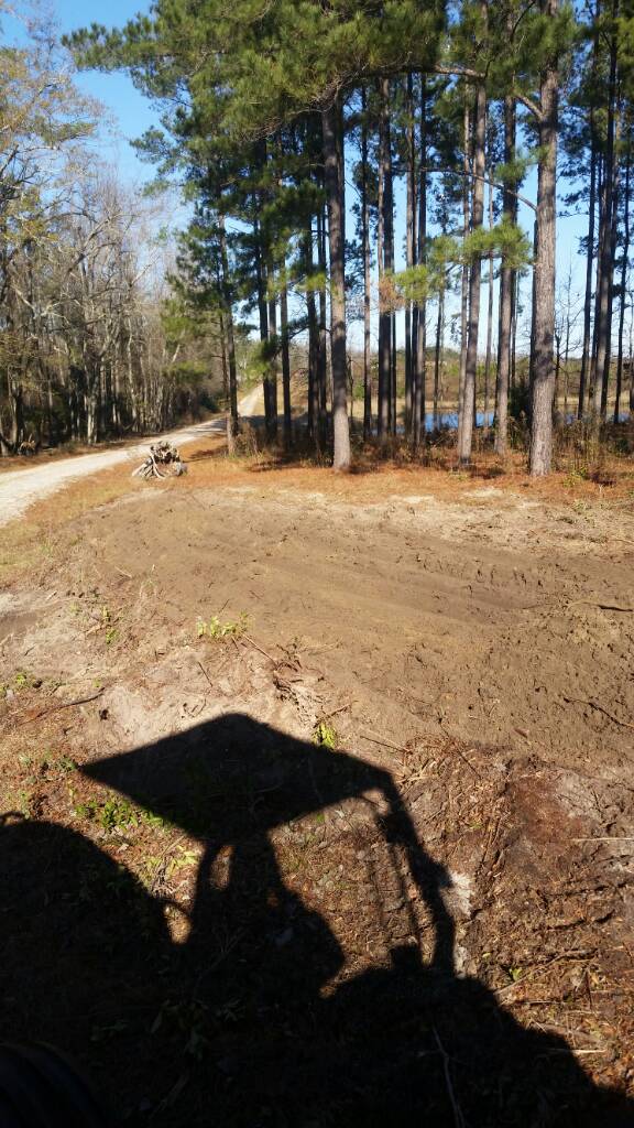

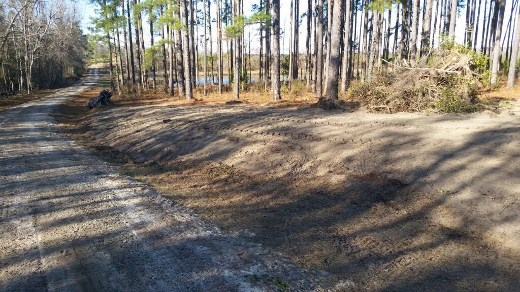

Looking at your pictures I would run parallel with the road for most of it. If there are places that are too steep for you then back up to the hill and pull down to the ditch dropping the dirt in the low spot. That will reduce the angle or tilt enough you can resume running parallel to the road.
If you are new to tractors and this work take your time and stop before you let the tractor tilt too much. Anytime you are digging down with your tractor be aware of utility lines you could unearth. Call before you dig.
It does take some seat time and practice to develop skill with a box blade. Don't let this frustrate you too much, the more you work it the better you will get. Just enjoy your new tractor and keep it right side up.

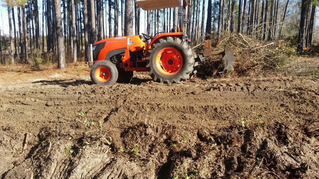

So went over to Pa's to grab the box blade this morning and had to mod it a little to work with the Pats but after I got that out the way I attempted to move some dirt, the roots and straw were making it impossible and I got bent out of shape and jumped off the tractor and started trying to pile the limbs and roots by hand. Then I'm my fury some little voice in my head said "What are you doing you idiot use the root rake!" DUH!
Dropped the box blade ran over to the equipment yard and grabbed the root rake and easily combed the dirt clean amazing how that works. Now I'm inside gonna eat some lunch then fuel the tractor up and try the blade again. In don't think the pics do this justice I'd be amazed if it didn't get done today not really as bad as I thought I can almost side hill it now.

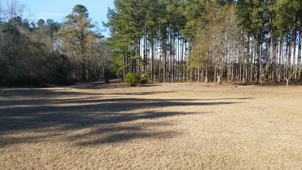

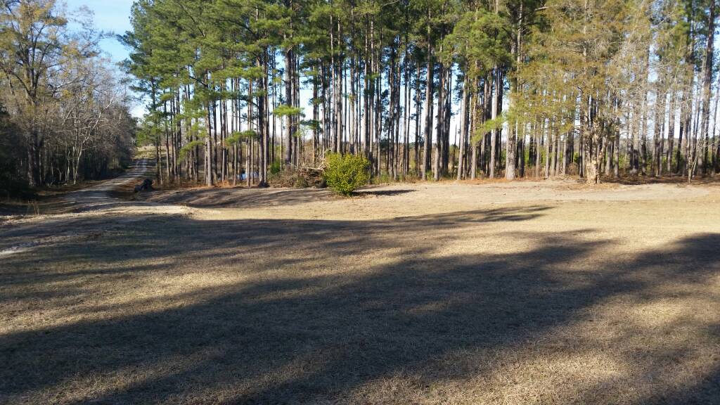

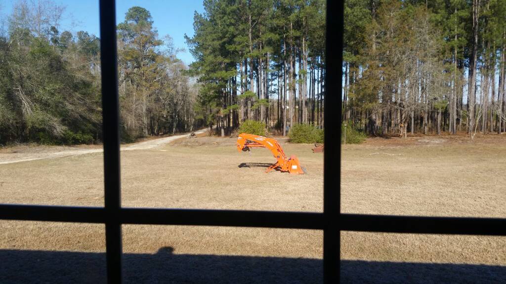

Here's a shot from my window by my chair in the living room you can see I have to look at this every single day. Hence why I'm redoing it.

Looking good! No reason at all to remove the FEL. For ground work 99.9% would leave that on.
If the box was preventing forward progress the front was too low. HOWEVER that rear mounted root rake is doing a great job so keep it going!

Looks good, once you get that done I assume you are going to clean up under the trees to get a good view of the pond?

It may be my lack of finesse with the boxblade but I usually do the rough-in with the box then move to the landscape rake to smooth the transitions and prep a seed bed.

OK enough for today needs more smoothing but I'm not having much luck with that having all the roots and straw to contend with isn't letting the dirt flow like I want so I'll have to back up and punt on the finish work, might just let the rotary mower do the finish work.

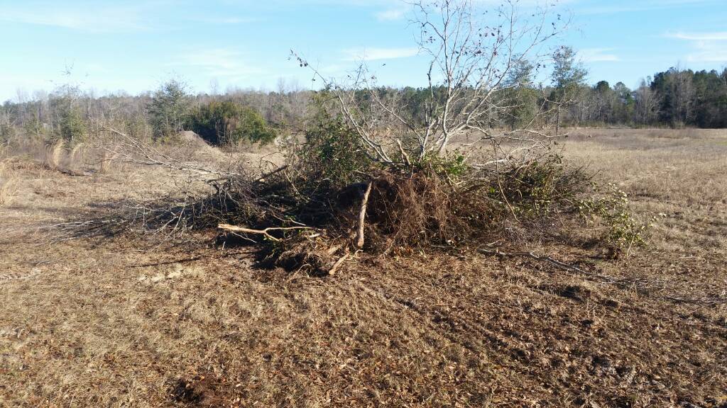

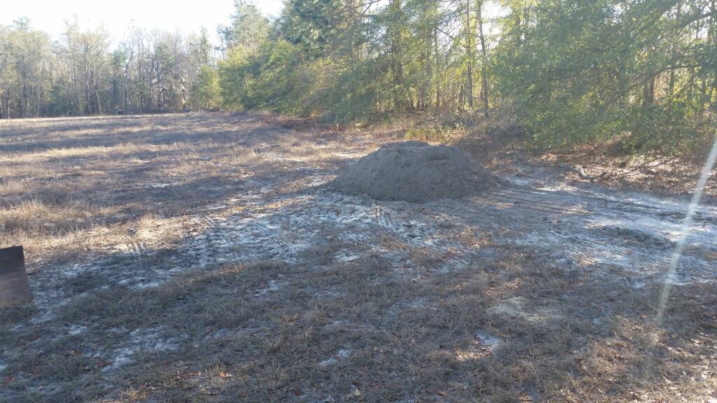

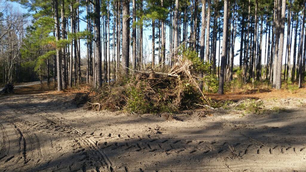

Here's the pile if fill dirt I removed didn't get as much as I wanted took a lot to fill in the root balls from the azelas. Moved at least this much dirt laden roots too that was a job that fustrated me greatly they clung together and were almost impossible to scoop, needed a grapple badly.
And this is the two piles of brush I removed from this hill it was an over grown mess to say the least.
