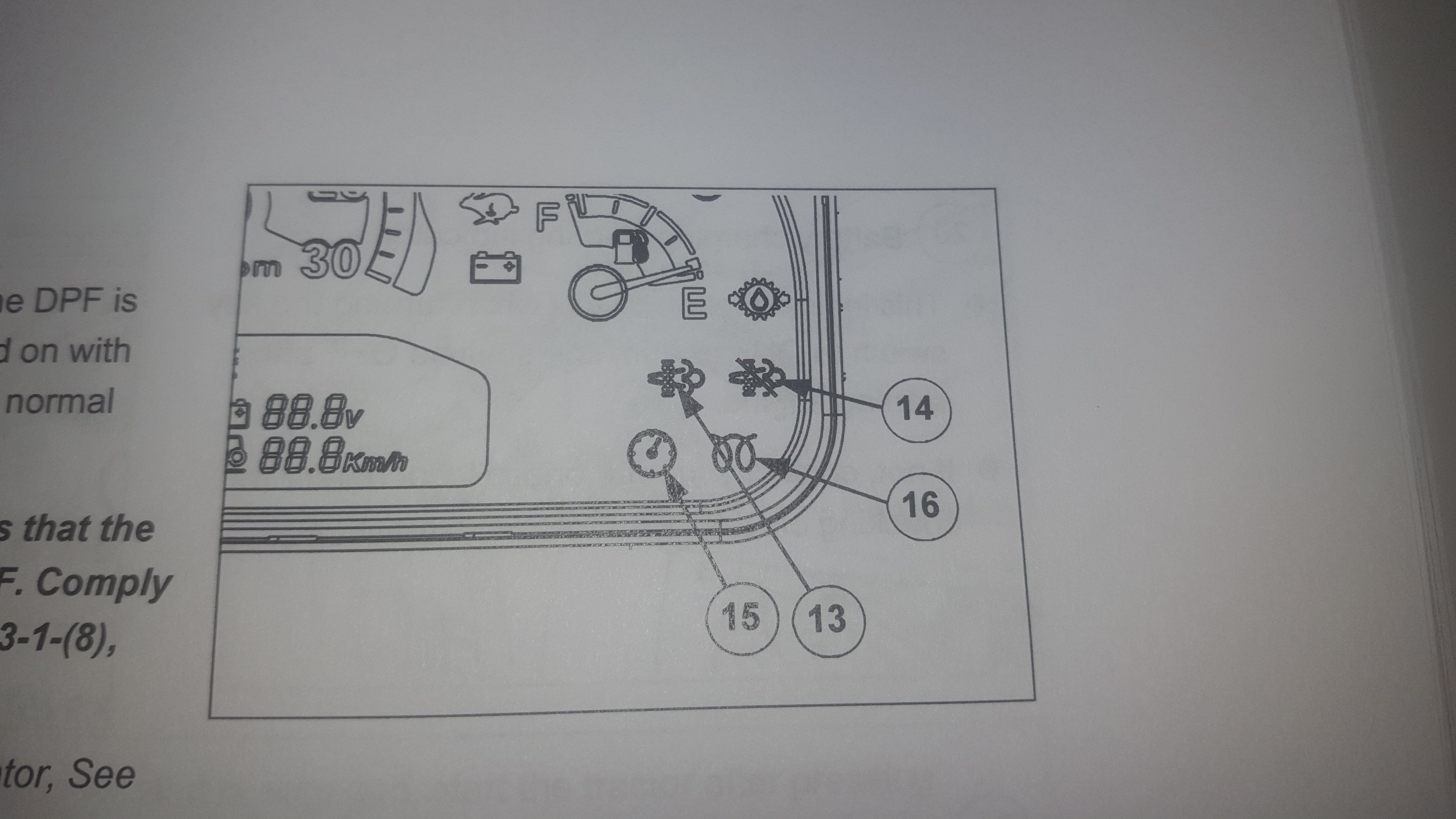

The two lights are actually independent. The one light tells you its regenerating, the other is the light that tells you the exhaust is hot and it comes on after the first.
I don’t think idling is necessarily bad. If the engine is thoroughly warmed up, bringing it down to slow idle for a few minutes doesn’t seem to soot up the dpf.
I don稚 think idling is necessarily bad. If the engine is thoroughly warmed up, bringing it down to slow idle for a few minutes doesn稚 seem to soot up the dpf.
Your explanation makes sense but I am curious where you learned the meaning of the "regen with thermometer" indicator. The Manual just shows "regenerating" and "regen inhibited" indicators. This "regen with thermometer" indicator is a 3rd indicator not shown or described in the manual.
So now I'm curious if I even went into regen or not. I smelled the smell but I never saw the the actual regen indicator turn on. I've had the engine up to this temp plenty of times before and never saw the "regen with thermometer" indicator. Also never smelled the smell (this is my first tractor, first turbo engine, and first diesel engine; I'm not sure that what I smelled was the smell of regen).

I just happened to look at the hour meter on my new XR4155HC when it turned to exactly 50.0 hours. At same time the first “regen” light came on. This light indicates that the diesel particulate filter (DPF) is being brought up to temperature. The second indicator comes on when the DPF is at full “regen” temperature and stays on during the full cycle which was a bit over 20 minutes, as I recall. This was my first “regen” cycle.
My previous XR4046HC would “regen” on about 5 hour intervals.
I run at 1500 rpm plus at all times, and 2400 rpm when mowing.
The only time I “idle” is for a couple of minutes at startup, a bit longer when it’s cold.
A “regen” cycle shouldn’t effect your operation unless you’re doing something in tall dry grass. In that case get out of that area until the cycle is over.
