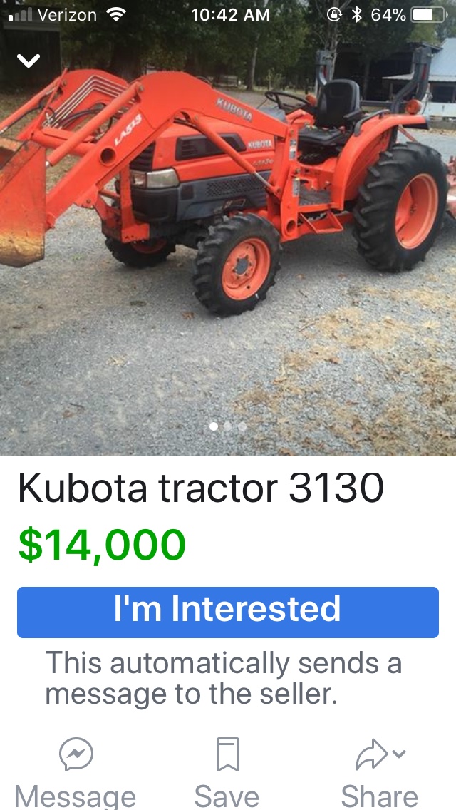

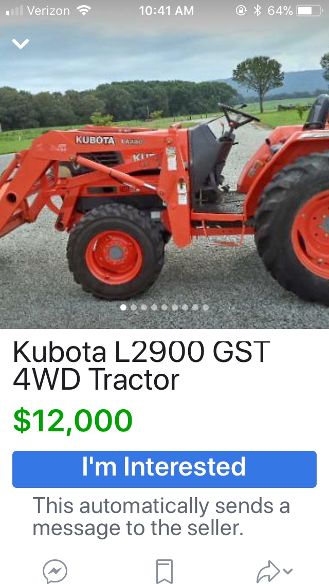

15k or less will buy a pretty decent tractor used. Here’s what I found locally. My x neighbor bought a Kioti dk40 which is a pretty big compact tractor with like 800 hours for $12k. IMG_4445.JPGIMG_4446.JPGIMG_4447.JPG

I hear you. I drove that one to. Just can稚 justify 17000 on cost versus use. If I spend that much I would look hard at RK24 with backhoe.
