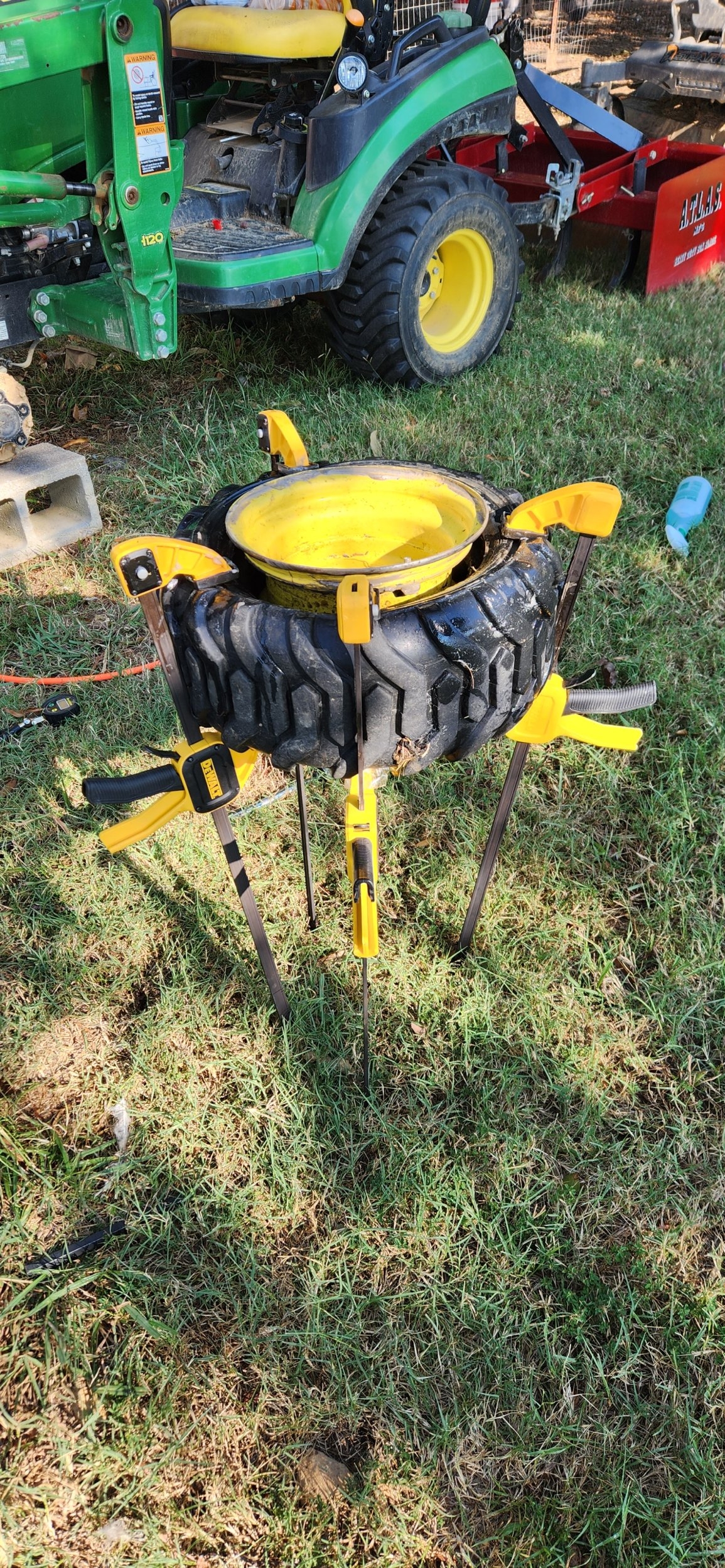

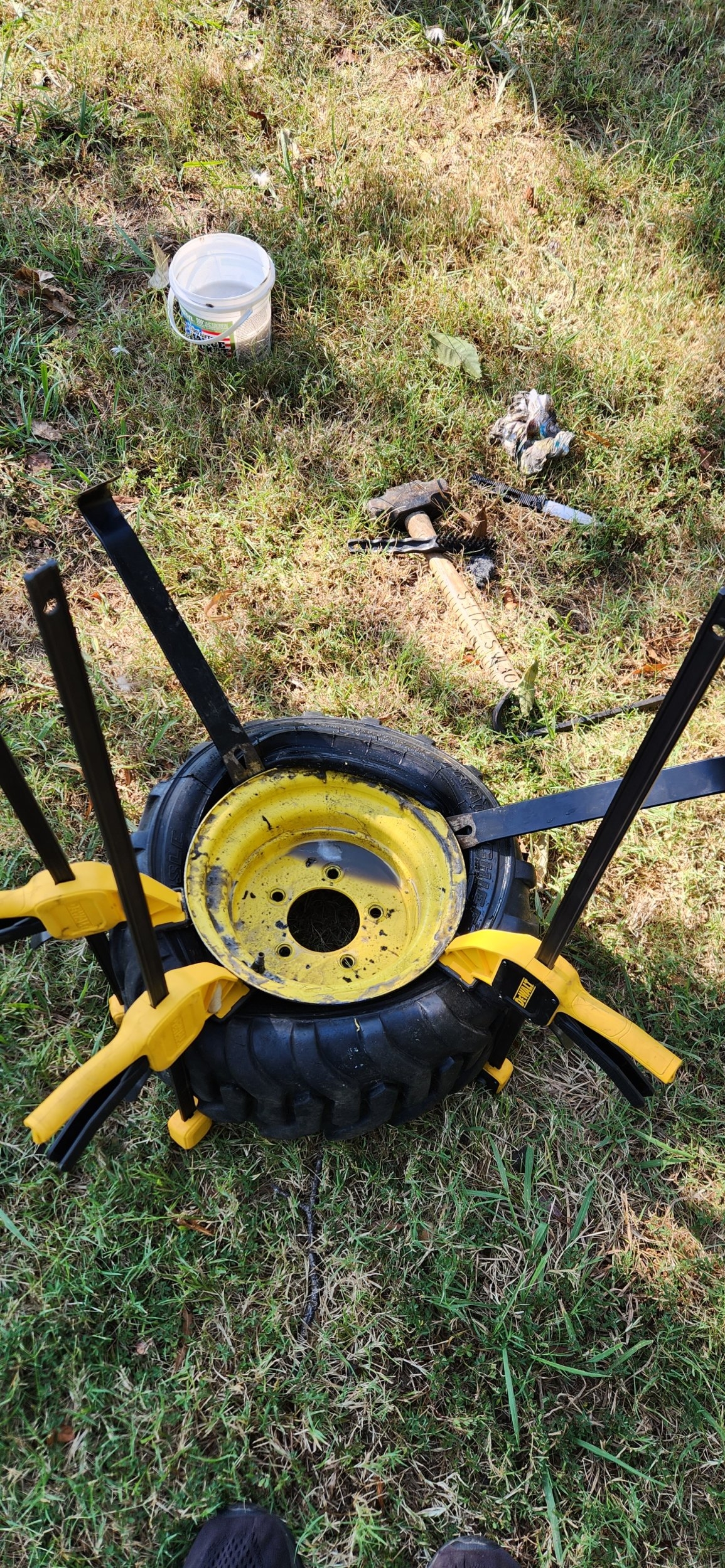

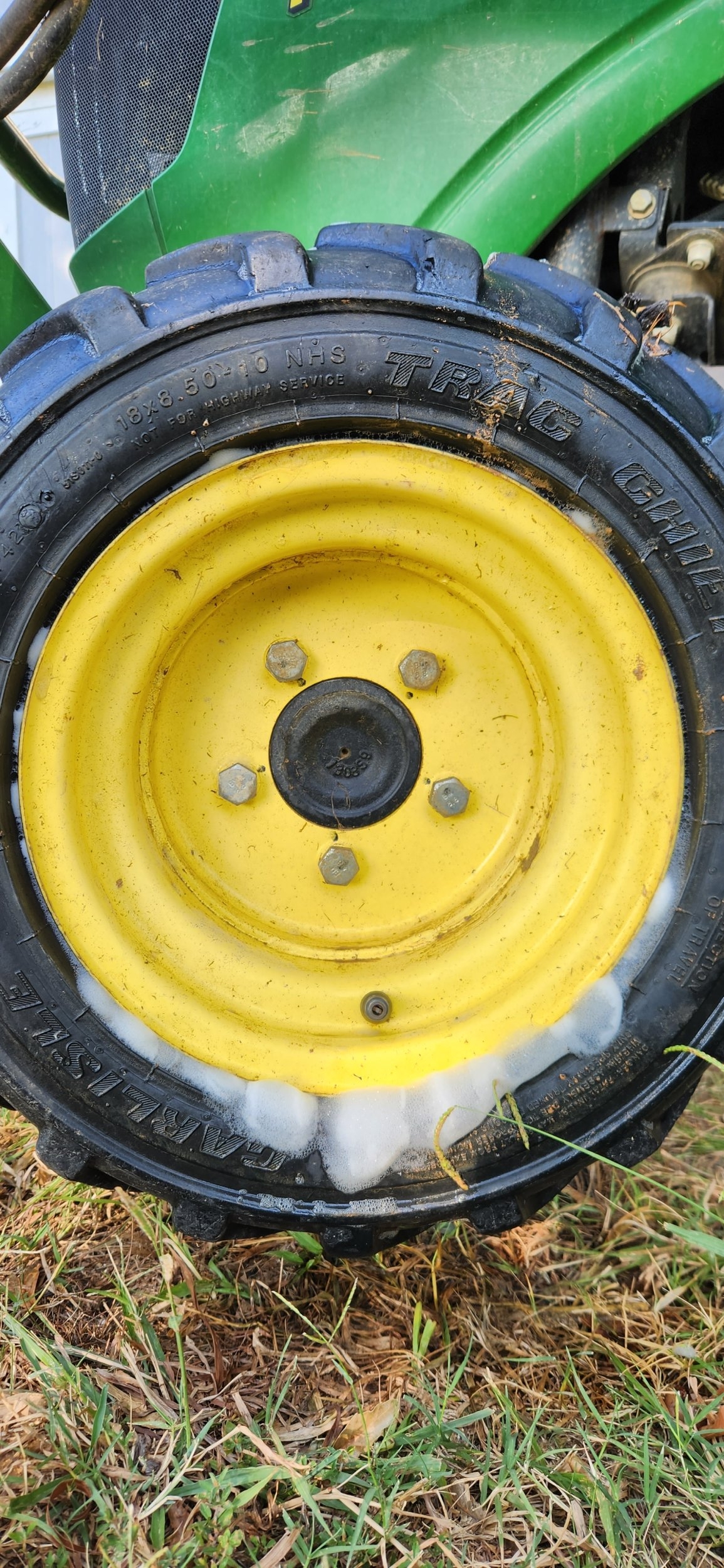

I had a slow leak from some old plugs and decided to finally fix it over the weekend. Pushed the old plugs in and installed new ones with rubber cement. Now it's a fast leak... 2nd plug in each hole. All good, but the soapy water fizzed up along half the bead. I guess dirt got in there when it got low.

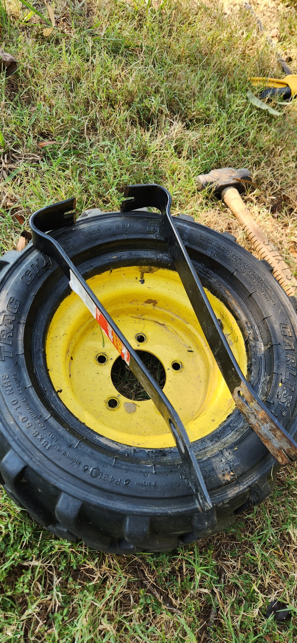

Broke the bead with the loader, pulled bead in with nail puller pry bars, wood clamps to keep the tire out of the way to clean the rim, dis and re mounted the tire with pry bars to clean tire bead, soapy water for lube. And success. At some point I probably need to get better tools for this job...

Safety Seal plugs would've taken care of the punctures, then avoid using water as a lubricant.
Tire irons are cheap, by the way, and less likely to damage the tire bead. Also, if using a Hi-Lift to break the bead, the wheel could stay attached to the tractor. Same with a tool made for the purpose, but those are a bit costly.
