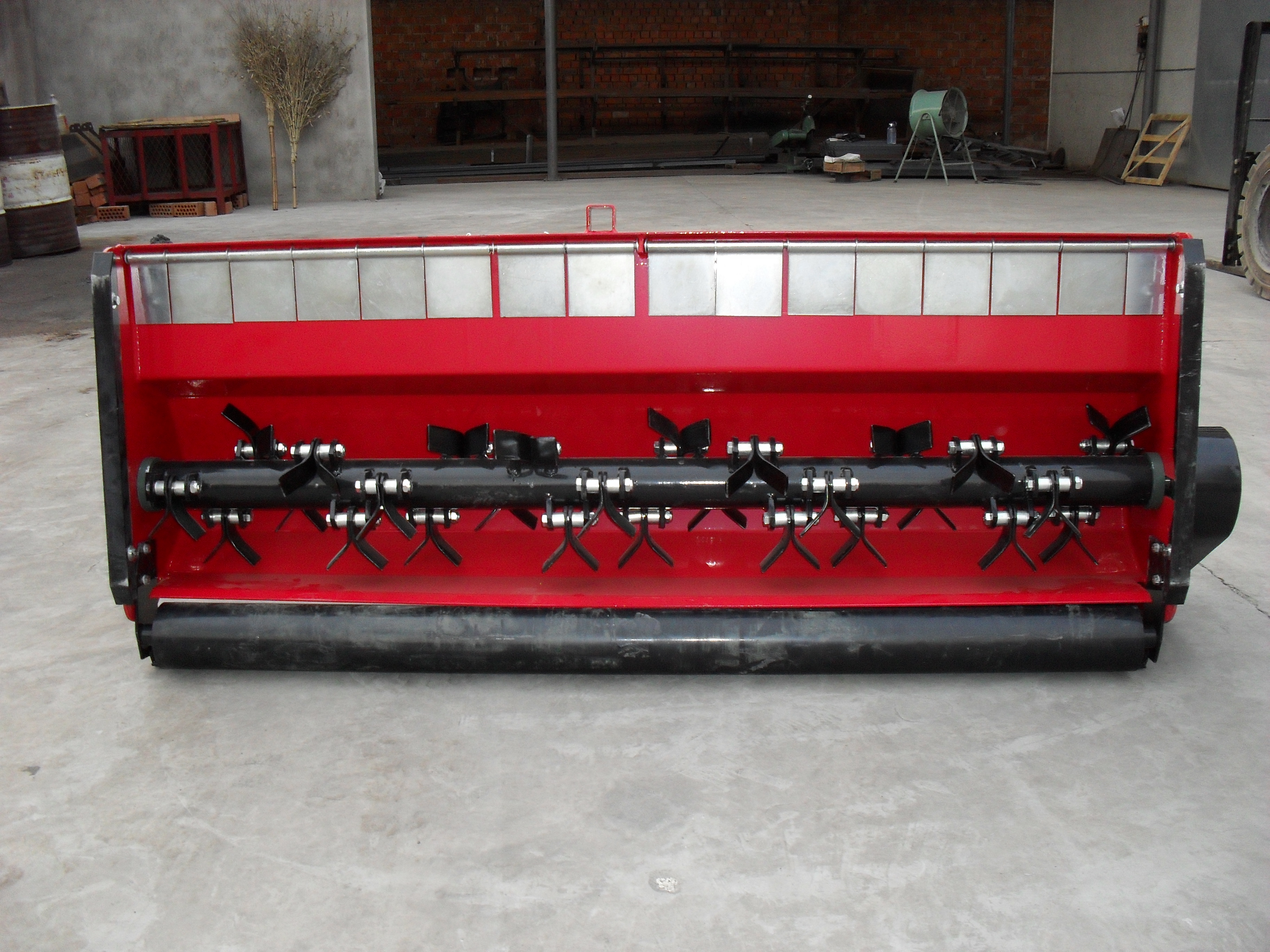

EF mower is light duty flail mower, I only recommend customer cut grass less than 15 inch height if with flail hammer, less height grass if with the small Y knife you bought.
I suggest you to drive slow, sharpen those Y knife, lower down the roller position. Hope this could help you.
Flail hammer is more suitable for you, but not this Y knife.
