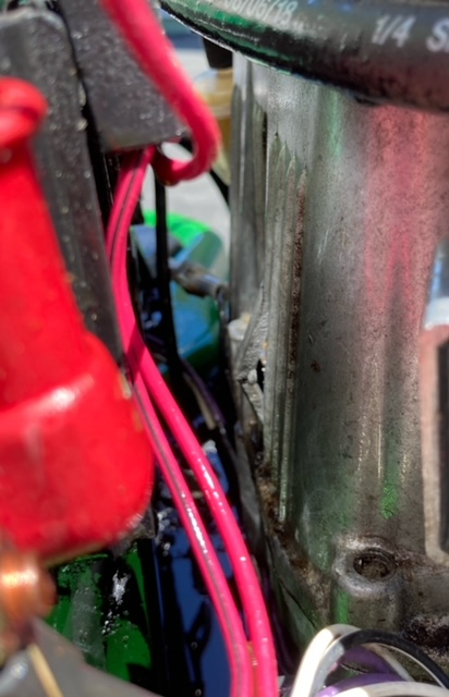

Think I found the problem. Well first, I think my compression release spring valve is busted off, as I don't see a bump when moving the valves by hand.
But I got it to fire up anyway, started mowing and notices some smoke and leaking oil on the ground.
Wonder if that was the compression valve that flew out or something else?

Thank you for your detailed response.
The picture above shows a hole blown in the side of the engine, which is where the oil and smoke was coming from. Ran fine for a few hours after setting the valves. Took a lunch break, had trouble starting it but it eventually turned over.
Made a few passes before noticing the smoke, oil and finally the hole in the engine.
I just drained the oil. Lots of fine metallic shavings.

Sorry to hear that. That's bad,make that really bad. Around my area there are lots of late model lawn tractors for sale because they don't run and shops are so expensive that people buy new. You have to be quick on the trigger for Z-turns but regular tractors are cheap. Your problem might be having a way to mow while precuring and repairing the replacement.
/ First Time Homeowner - E110 Not Starting #13
also looks like its missing the sump bolts. if it makes you feel any better, mine is torn apart waiting for yet another part.
