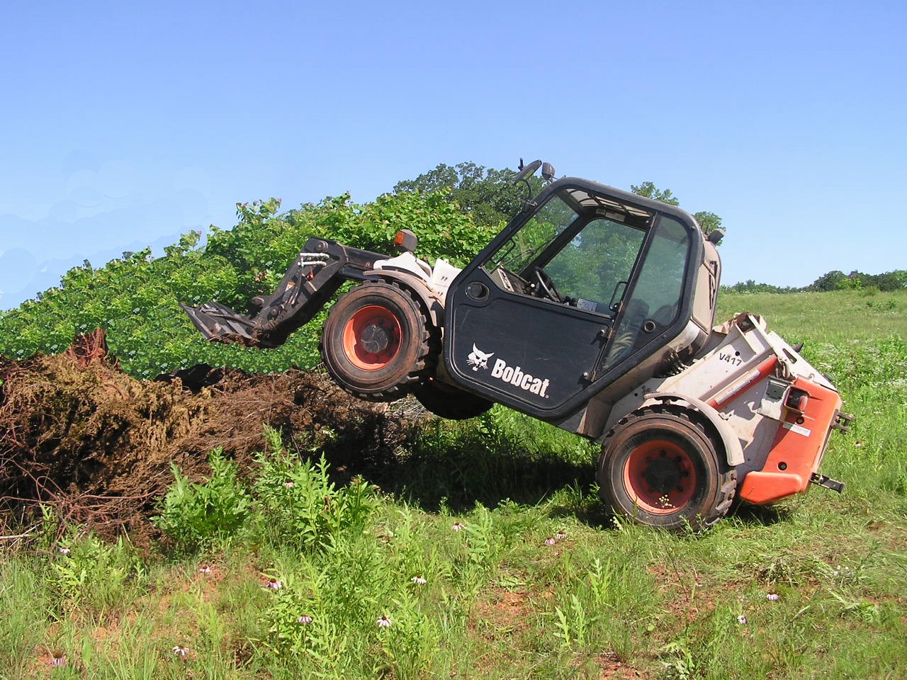

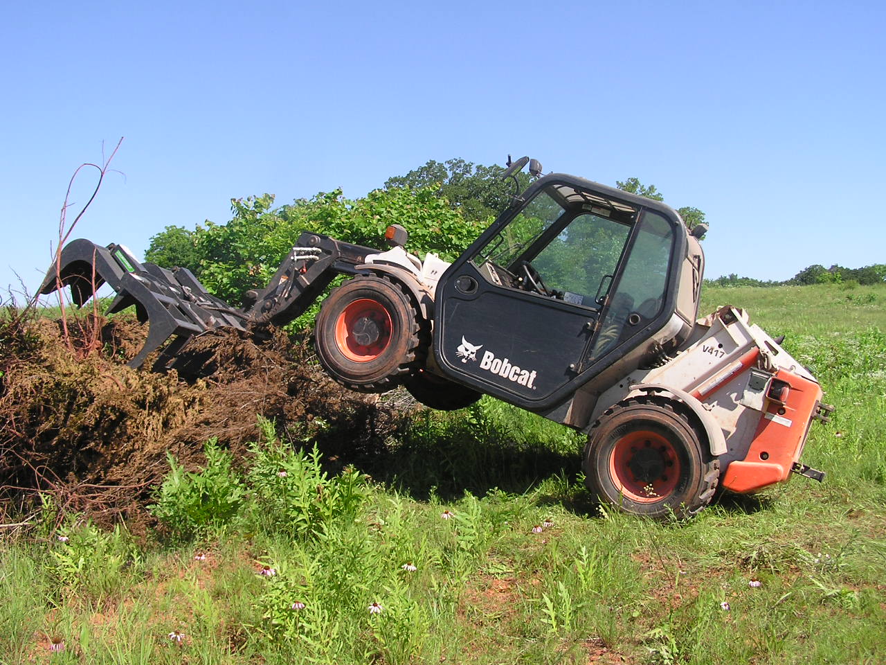

First Time I Really **NEEDED** Rear Weight
   / First Time I Really **NEEDED** Rear Weight #11
Loaded tires are nice but they don't count as ballast for the FEL.
I don't want any ballast in my rear tires!
I carry my 1800+ pound backhoe around everywhere I go!
It is removable, but I don't.
#12
My tires are filled, but small as they are they only add a couple of hundred pounds. I can't have the BH on all the time for clearance reasons. It sticks out and up too far for many tasks when using the FEL. I need to watch what's in front of me and not have to worry about that giant preying mantis running into things. As it was, the finish mower I had back there was causing issues. A weight box might have been ideal in this case, but I don't have one. I could have grabbed the tiller, but that wasn't convenient at the moment and can be a real bear to hook up.
   / First Time I Really **NEEDED** Rear Weight #13
I have 1550# of RimGuard in the rear tires and my Rhino rear blade @ 1050# on the 3-point. That rear blade could easily get to be a real problem if my land was densely forested. When I do navigate thru the trees - turn the blade 90 degrees. It may bang on a few trees but the edges won't catch on any trees.
I have trails to most everywhere on the property. Seldom get off these trails. The M6040 with the rear blade is not a whole lot of fun to navigate thru LARGE pines. I use a long chain when "stuff" needs to be removed from inside tree stands.
I make it a point to do some heavy thinking before I decide whether to take the tractor into a tree stand. I most often use the chain or just leave it alone. "It's" not really bothering anything, anyhow.
   / First Time I Really **NEEDED** Rear Weight #14
Hmmm! Learn something new every day.
PCABE5 - it would do well if you read your tractor Op Manual again. This time with a little understanding ............
Does this help with your understanding of what the manual says?
"When working with front loader or rear heavy loaded attachments installed to the 3-point linkage,
install ballast weights on the counter-part axle to maintain the front and rear weight balance of the tractor.
If not, front or rear axle can be strained by the overloaded weight.
When working with the front loader, place the attached rear weight to the highest position and turn the down speed control knob to the “lock” position."
