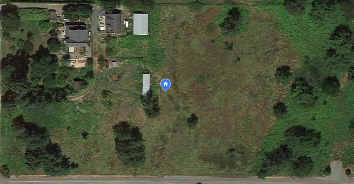

Hi all,
My fiance and I are first-time property owners on 5 acres outside of Bellingham, WA. The property was neglected for a couple seasons, so there is a fair amount of remedial landscaping to do. Here's what we're up against:
  • We have a large section of blackberries to cut back / work on eradicating - probably 200' by 100'.
  • The 5 acres is mostly rough field / pasture which needs to be bush hogged, except for a smallish front lawn (about 1/6) acre which needs mowing.
  • There are several incomplete french drain projects around outbuildings - these were left open, with pipe in place but no gravel. They need completed digging, then backfill with gravel.
  • The digging done on the french drain left large piles of earth between buildings, where we'd like it to be flat and perhaps graveled for easy car access.
  • We have about 300 feet of gravel driveway in fairly rough repair that should be regraded.
  • The area is known to get significant snow at times, and I am wondering in general how to best handle clearing the driveway and walkways between outbuildings (and potentially the barn)
  • In the next year we are hoping to add a herd of around 8 sheep, so will be wanting to bring them hay, and move their fences around periodically.
  • The property is fairly flat, but contains a lot of lumps and rises.
  • There are occasional stumps to pull (at least one dead tree we need to deal with sooner rather than later) and we would like to plant additional trees.
To me, when I look at this list, it seems like we need a tractor. I guess the first question is whether other folks agree on that. We could hire the work out, but when I look at the earthwork especially, it feels like I'd rather put the money into a tractor. So far we have a Stihl Kombi-system for brush cutting, but it feels like no match for the mass quantities of blackberries present.
So I've been looking at Kubota BX and B series machines with loaders and backhoe. Am I barking up the right tree here? How useful would the backhoe be on an ongoing basis? (I've heard that they are small enough to be not so useful.) I hate to get a new machine when so many used ones are floating around, but the financing actually makes it much more approachable for us. I'm mechanically minded (background as an engineer, service my own vehicles, etc) but tractor ownership (as well as property ownership at this scale) is new to both of us.
Questions:
- For the tasks listed, does a tractor cover all my bases? Is it overkill? I get the sense that it's a good 'generalist' tool but not really the best at any of these things (especially clearing snow, perhaps.)
- What sizes and brands should I be looking at? We have good Kubota and John Deere dealers near by, nothing else is super close. I am super turned off by some of the Deere 'held hostage by the software' reports that I've read, but am unclear how relevant they are at this SCUT / CUT scale.
- As complete newbies, what else do we 'not know that we don't know?'
- If we bought a new machine today, what kind of service life could we expect from it if we maintain it properly and house it under cover?
Thanks in advance for helping spend our money! Any advice would be greatly appreciated.

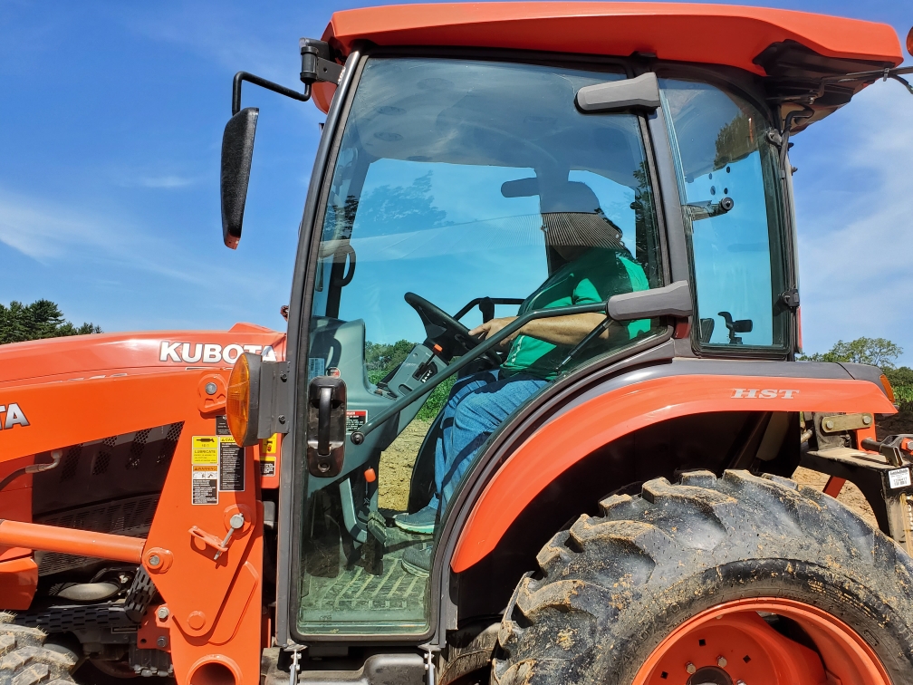

One question I have, are you looking for a cab or no cab? It sounds like the winters could be rough, so was curious what your thoughts are on a cab.
Tractor size, my guess is that a compact would be a better fit than a sub. It looks like you have short term needs for FEL and box blade type work, with a long term need for FEL to maintain livestock. The brush hog (rotary mower) of 5 to 6ft range will meet your needs and will be horse power dependent.

Thanks for the warm welcome! I hadn't been considering a cab, mostly because of the extreme cost versus actually being able to 'do more things'. It might depend on the extend of the wintertime duties, which would probably be limited to any snow management and animal chores. So it feels like they wouldn't extend for hours at a time.

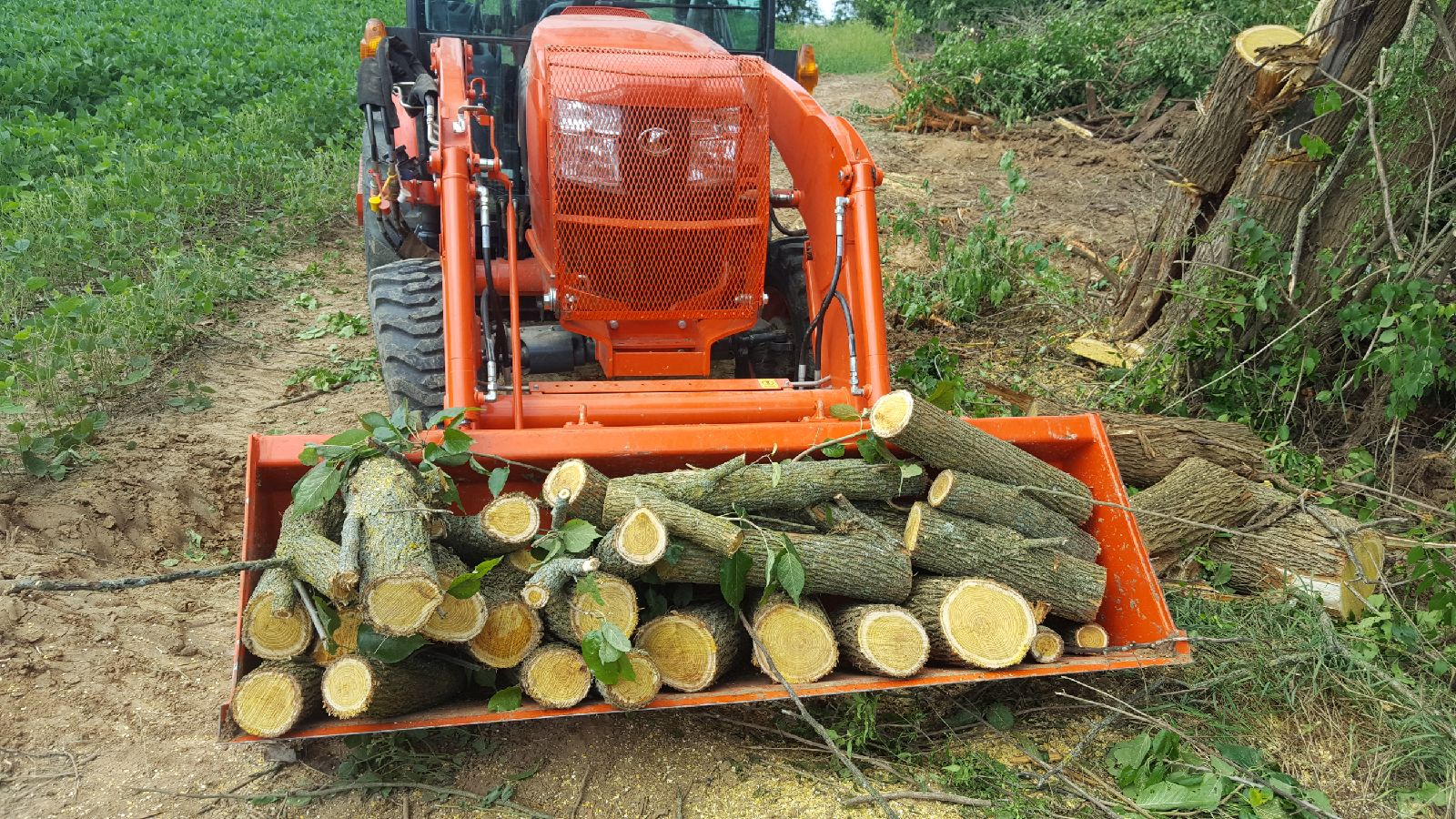

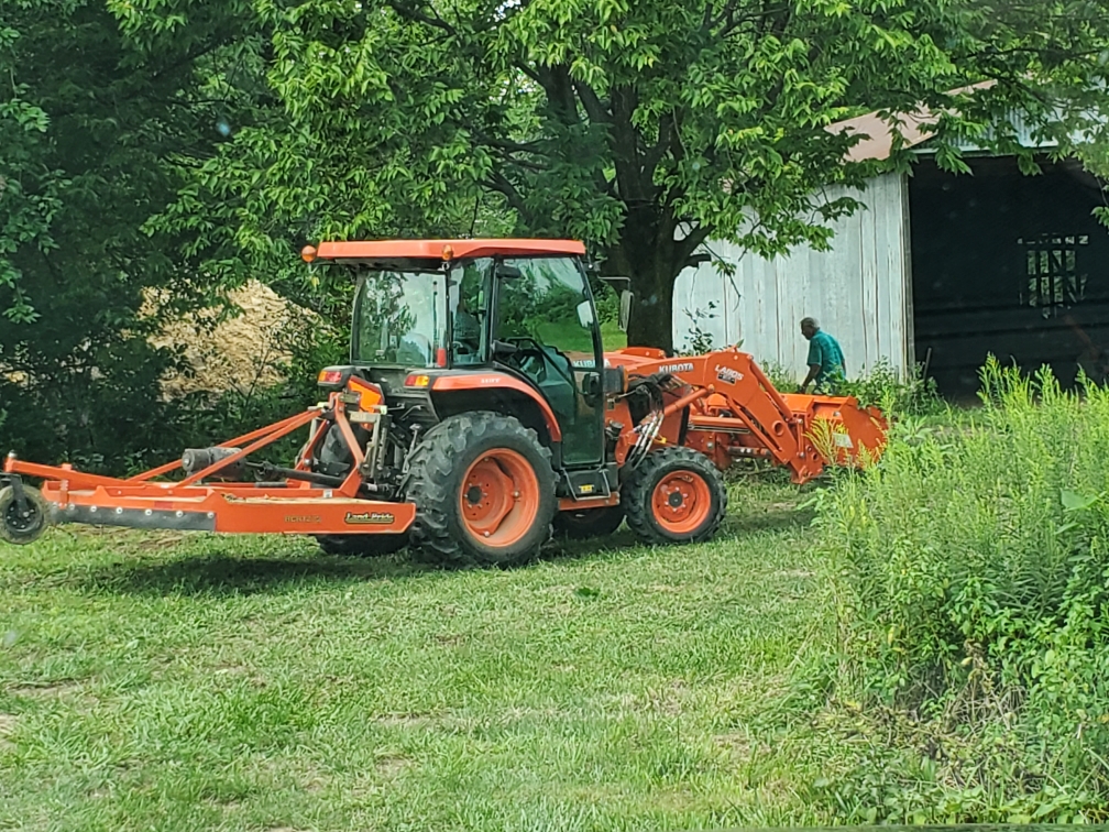

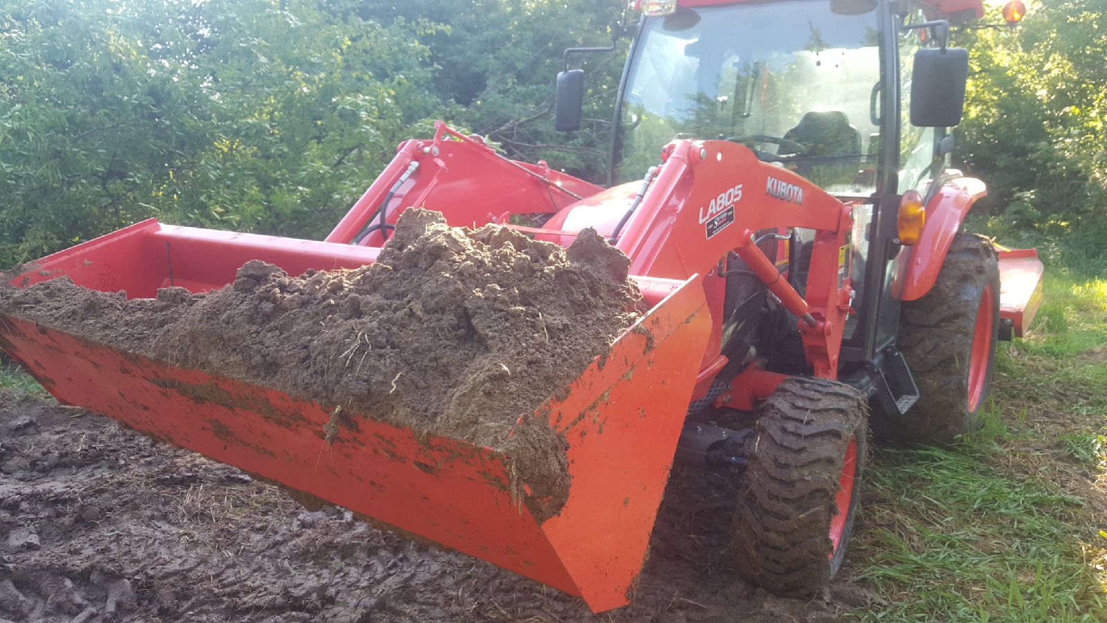

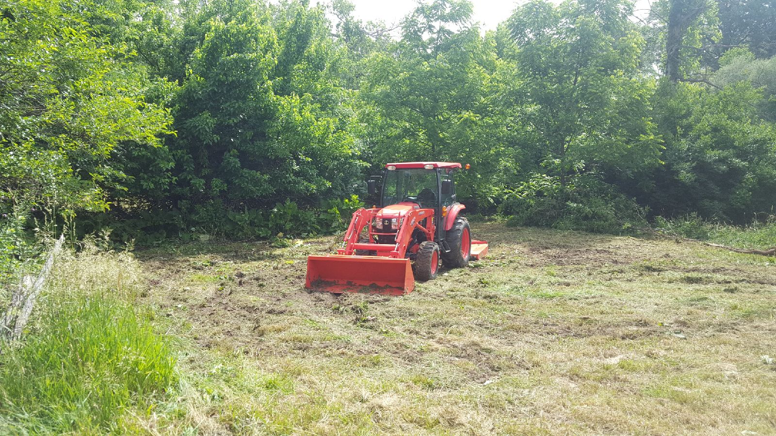

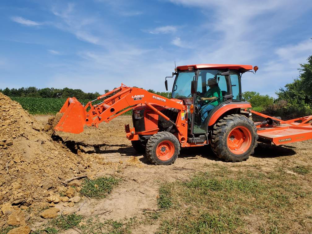

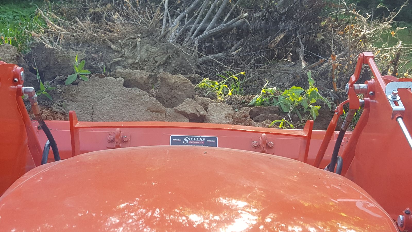

Here are a few pictures of what I have been able to accomplish with my tractor. Understand I'm a new tractor owner also, purchased mine in May of this year.
