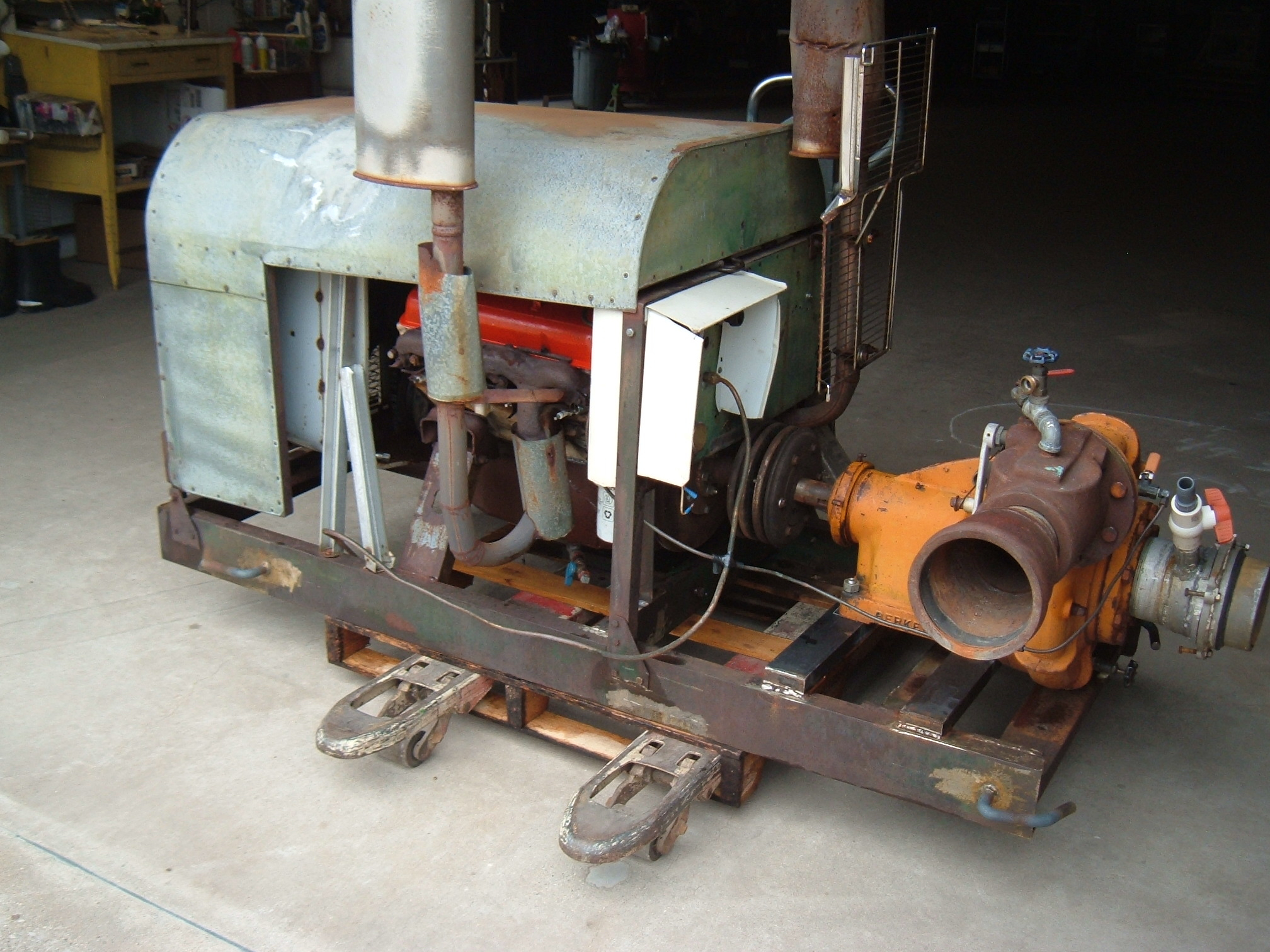

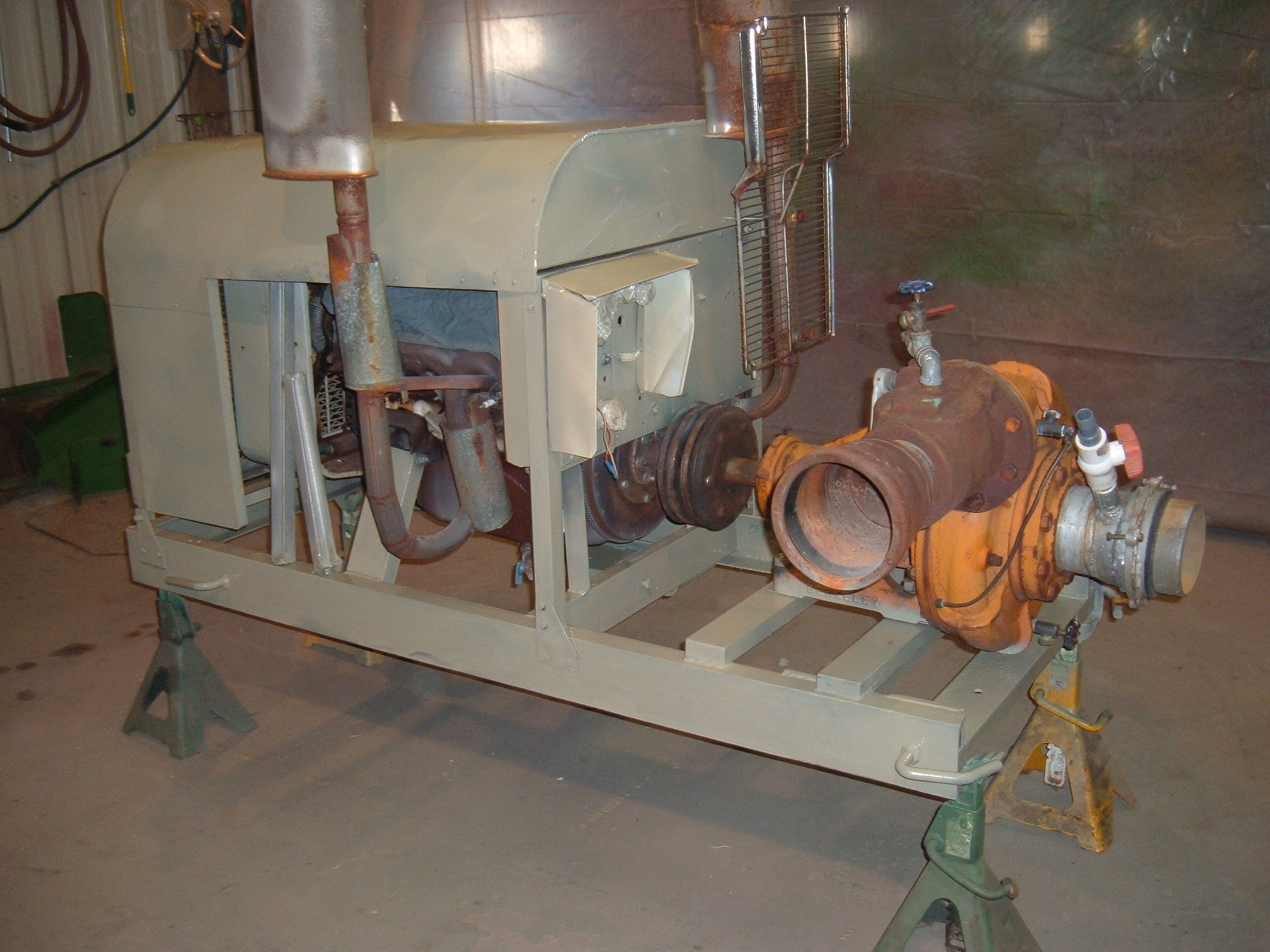

   / first time painting - should I grind off the thin surface rust or just apply rust converter? #69
Before we put some black on the pump. There is a guard somewhere, and we sponge paint the pump orange again. All left over, about 3 standing disks and a pad.
Paint still looks decent, 10 yrs out in the weather . No regrets about not standing around tossing 100$ bills at it.
