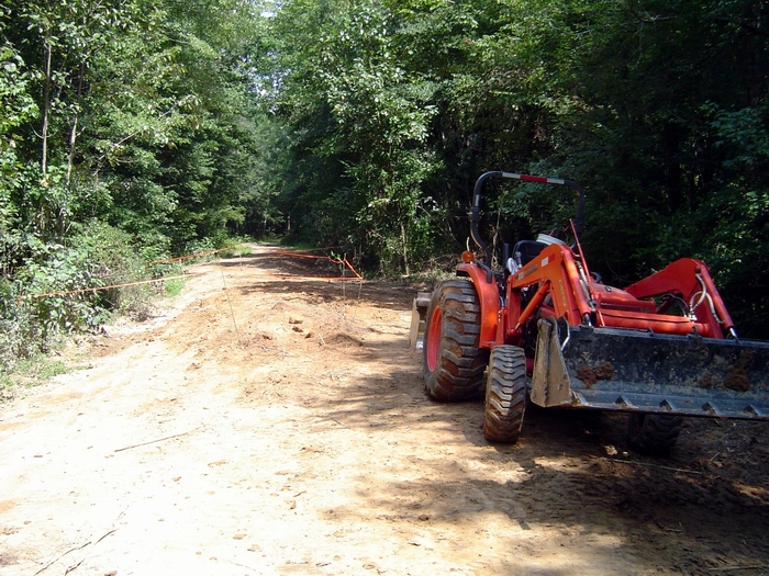

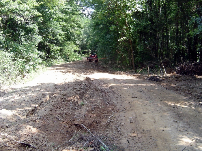

Yeowzers!!!!
OK.. for 1/4 mile road that was the most difficult 7 hours I have ever spent! I made a wonderfull drainage ditch along the low side, but every time I tried to pull the ditch material (fillings) away from the ditch... it would ball up and just push soil back into the ditch... dang!! After 6-7 hours of up/down the road tractor time (which I have to admit was fun) the road looked very simalar to when I started... at one point the neighbor came home with his new subaru and had to get out and push some soil/rocks off of the center of the road to get by... I'm..... uhh not goood at this road grading stuff.. but I willl keep trying..... DANG!!!
/ First Time Road Grading.. any tips #7
Hi Phill,
If your road is pretty flat and wallowed out, with the box blade, (or your tilting blade), I would drag material at about a 45 degree angle from the ditch to the middle of the road. I would go back and forth along the road, first one side, then the other side, depositing material near the middle. Then go up and down the road smoothing things out and packing things down. The idea is to put a crown on the road so it will shed rain and run off into the ditch. If you have clay and it's wet with mud, it's probably better to dig the wet stuff out and deposit dry stuff in the depression. Otherwise, mud will make more mush and it will remain a hole. Actually...doing all this is good therapy!

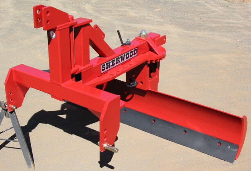

Yeah i do quite a bit of grader work on some farm road. Sure does give you a crook neck after a while. I perfer my road to be dry after recent rain. Currently its rock hard and can only cut it with the edge to shift soil.
What sort of grader blade are you actually using in this situation? I use an Australian made 6ft grader. It give me quite a few different options including rotation, skew and tilt.
Here's what it looked like new.

Such a handsome blade - makes me wish I had a bigger tractor. How much does it weigh? Does it have gauge wheels?
