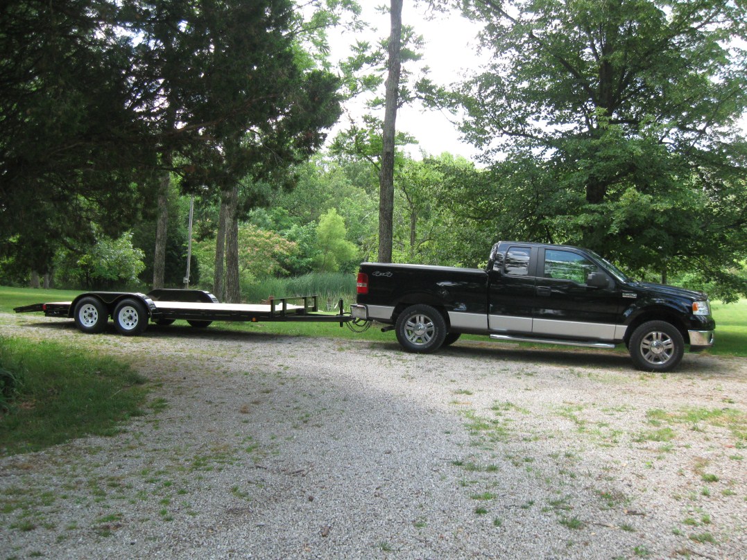

Just purchased an 18' car hauler for hauling my 1949 Farm Jeep. The dealer is a couple of hours away, just off I-65, so most of the trip will be interstate driving. I have a 2007 F150 V8 4x4 with the tow package. I purchased a Tekonsha P-3 brake controller and have it installed, but never had a trailer hooked up.
Since I've never towed a trailer with this setup, I'd like to know the steps I should take before I tow the trailer off the lot and other preparations for towing the empty trailer home. Do you have a checklist for the first time you tow a trailer?

Get the dealer to help you out, they are suppose to be experts. Some things I check, make sure the ball is tight, tire pressures, saftey chains (crossed under the hitch) trailer lights, test the brakes before leaving, make sure there is a pin installed on the ball latch. I usually try and do a walk around after I've gone a few miles. Thats all I can think of know.

Look on your state DMV website. They should have the Commercial Driver Handbook. There is a comprehensive pre-trip inspection in there; it is a required part of the test for Class-A and Class-B commercial drivers test.

Unless I missed it, no one mentioned tongue weight. A rule of Thumb is that 10% of your load should be on the tongue. The receiver on your truck should have a placard that lists not only total towing weight by max allowed tongue weight. Buy or borrow a tongue weight scale and adjust your load to insure you don't have too much or worse too little weight on the hitch. Too much and the rear suspension of the tow vehicle id compressed which also means that the front end is too high. Conversely too little tongue weight can be exciting to say the least.

Thanks for all the great info and links. One more question. Since I've never used the brake controller and since I won't be hauling anything, can I start by setting the voltage to a low level? The manual says to set it at 6.0, drive up to 25MPH and hit the manual control. If the wheels lock, lower the voltage, if they turn freely, raise it. Since I'm not sure I'll have access to a helper or even a good place to test for wheel lock-up, I was thinking of setting the voltage in the 4.5 to 5 volt range.
Or does someone have a method for adjusting the controller for the first time pulling a trailer?
