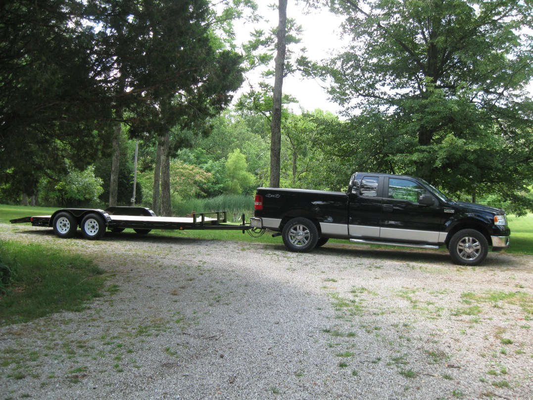

Thanks for all the great info and links. One more question. Since I've never used the brake controller and since I won't be hauling anything, can I start by setting the voltage to a low level? The manual says to set it at 6.0, drive up to 25MPH and hit the manual control. If the wheels lock, lower the voltage, if they turn freely, raise it. Since I'm not sure I'll have access to a helper or even a good place to test for wheel lock-up, I was thinking of setting the voltage in the 4.5 to 5 volt range.
Or does someone have a method for adjusting the controller for the first time pulling a trailer?
   / First time towing checklist #12
The real reason they suggest doing that test is to make sure the brakes are working correctly. You can adjust your brake controller easily while rolling down the road.
When I tow with my Suburban, I change mine when I get on/off the highway, because its controller is not fancy and just sends voltage when you tap the pedal. Doing 30 MPH stop-and-go city traffic, a setting of 2 or 3 is good for my rig, but on the highway I turn it to 5 or so, then I turn it back down once I get on the surface streets again. When parking I usually set it on 0.
I think the Prodigy you have might make this kind of adjusting unnecessary because it is more sophisticated, but you can certainly dial in the brake strength you need without leaving black marks all over the road.
You mentioned not being sure where you'll test the thing once you pick it up. Ask the salesman for a good route back to the highway so you'll be on regular streets for a few miles first, passing a really big parking lot or two if possible. If you want, just scout yourself out a good route before you arrive at the dealership. It is really helpful to know a couple of spots you can stop before you hit the highway.
If you are totally new to towing, you might want to bring an experienced friend with you for the long trip back. Parking a trailer is a whole different process too, don't run over your wife's car or anything. A few tall cones can be very helpful if you have to back your trailer up without help.

I picked up the trailer this morning and both truck and trailer performed well. The dealer helped me do the brake test in his lot. Thanks again for all the good advice. I'm now going through all the messages on tie-down methods. More questions later!
