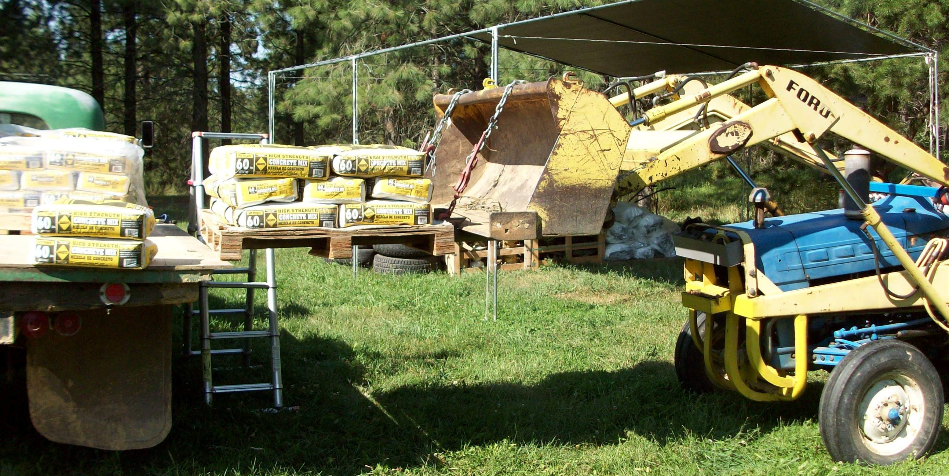

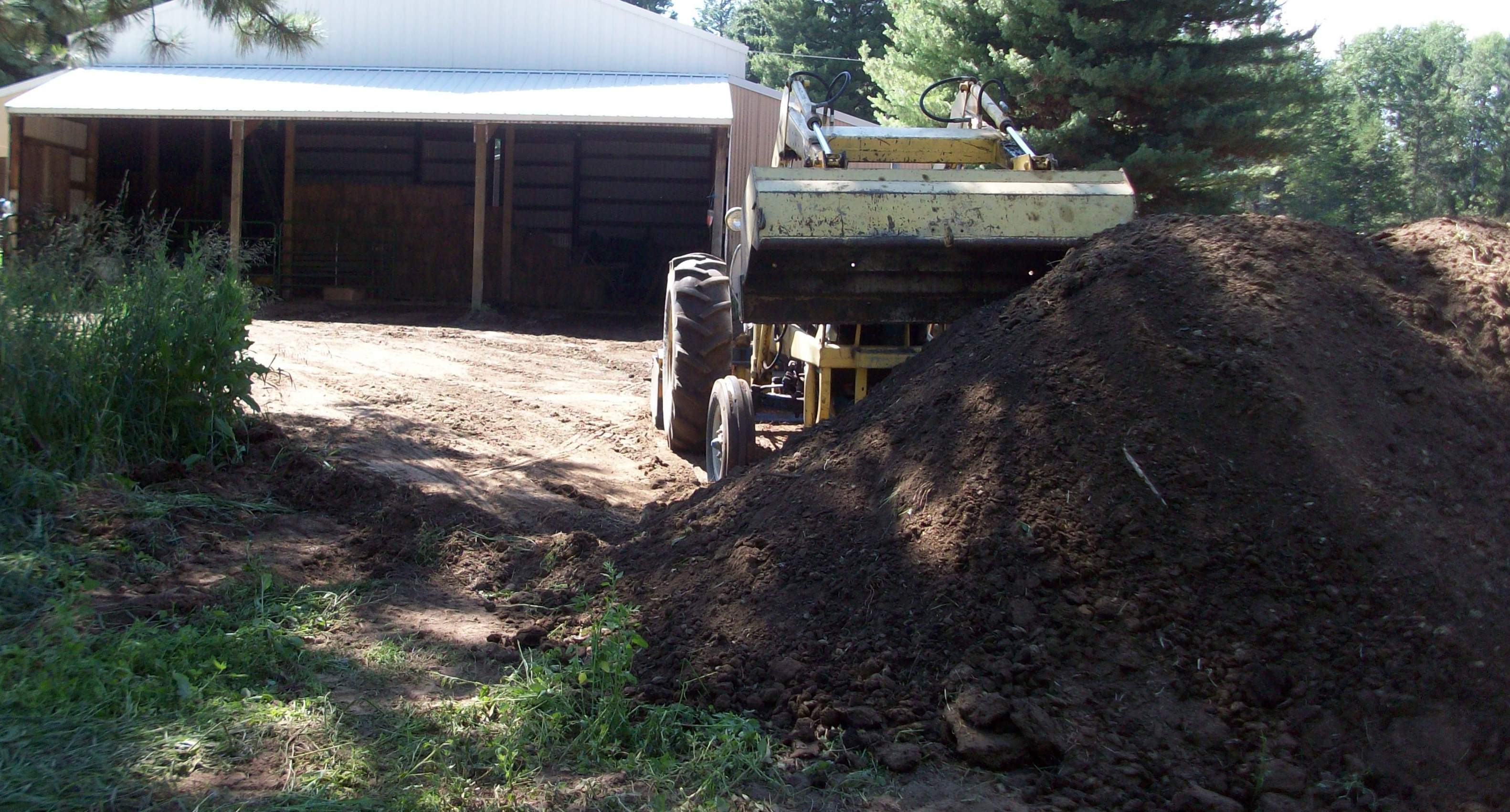

heres a couple pics of an 850 i use to move hay. loader is a superior utility duty.. 2nd pic shows a bale spear mounted in the bucket.
http://photos.yesterdaystractors.com/gallery/uptest/a31745.jpg
http://photos.yesterdaystractors.com/gallery/uptest/a137290.jpg
Nice 850 Soundguy You have a real spear- i have been cheating a little bit using a round add on bucket pallet fork- will get a real spear this next year but it has worked well so far it does take a little extra push to stick the round bale though here's the 3000 after cleaning out the horses run outs barn run out cleaning-ford 3000 001.jpg and to show the lift capability of the standard ford loaders- 1440 lbs. of concrete being removed from my 1940 international DS 30 International dump truck 100_2231.jpg

i'm cheating too. that spear is a bale spear.. but it is a 3pt spear! I made a bracket estup with a chain loop so i can set my 3pt spear into my bucket. swing a 2' piec of chain around a hook and hold it in, and a small chain to eyelet in the bucket to hold the base. works perfectly.. and 2 chains and pop it's off if i need the bucket.. or need the spear on a 3pt.
