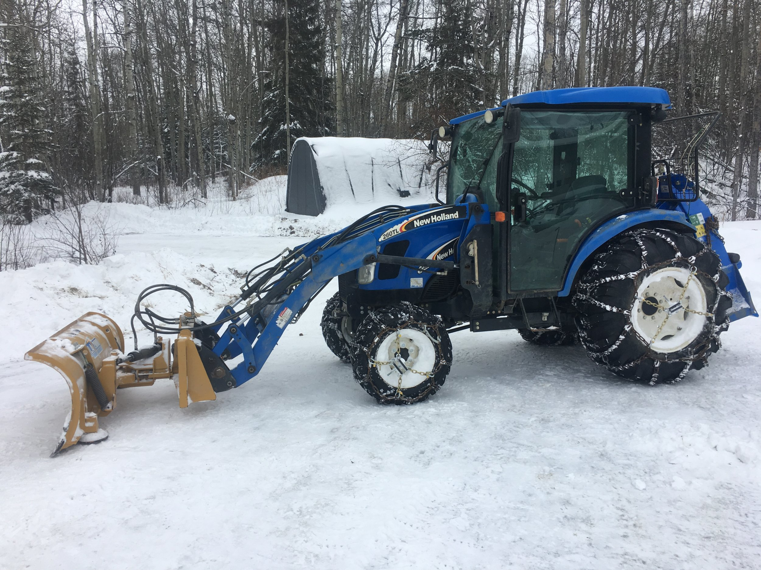

I have 2006 New Holland TC45DA. I want some rear chains but I am having difficulty finding any that will fit. There is about 1-1.25 inch clearance between the inside tire and the plastic wheel well fender. Does anyone have any recommendations on where to find lower profile chains or have any other advice on what to do? Tire size is 17.5L x 24. They are R4 tires.

You should have offset rims that can be switched from one side to the other giving you a wider wheel track and more clearance between the tire and fender.

With the wider track it will also improve your stability when operating.
What I did. Widened the stance.
