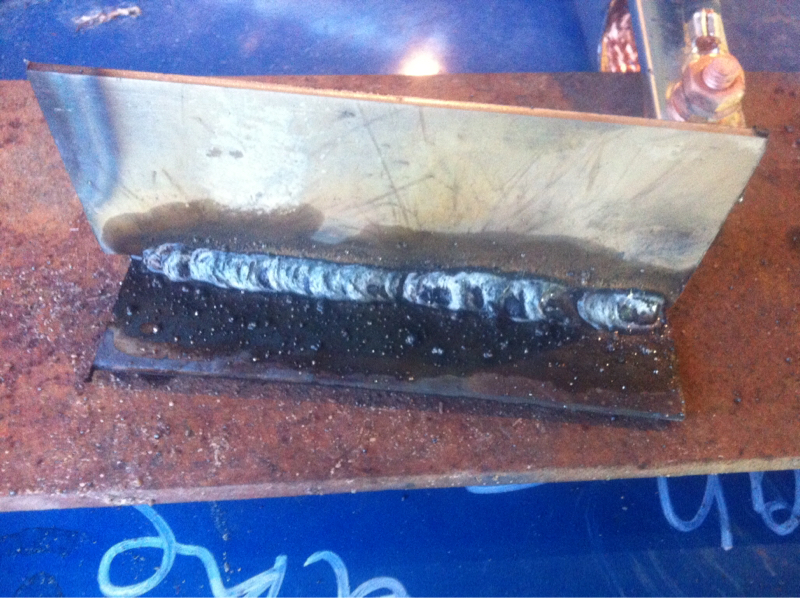

I've been stick welding for 40 plus years and this year I started TIG AC/DC. Been using the AHP Alpha 200 for about 6 months and the only thing I don't like about it is the owners manual. Everything else is rock solid. For a beginning welder you can't miss. Does DC stick (fantastic arc), AC/DC TIG both up to 200 amps and will run on 220v or 110v. You'll find welding is lots of fun. Start with stick and work up to TIG.
/ First time welding #35

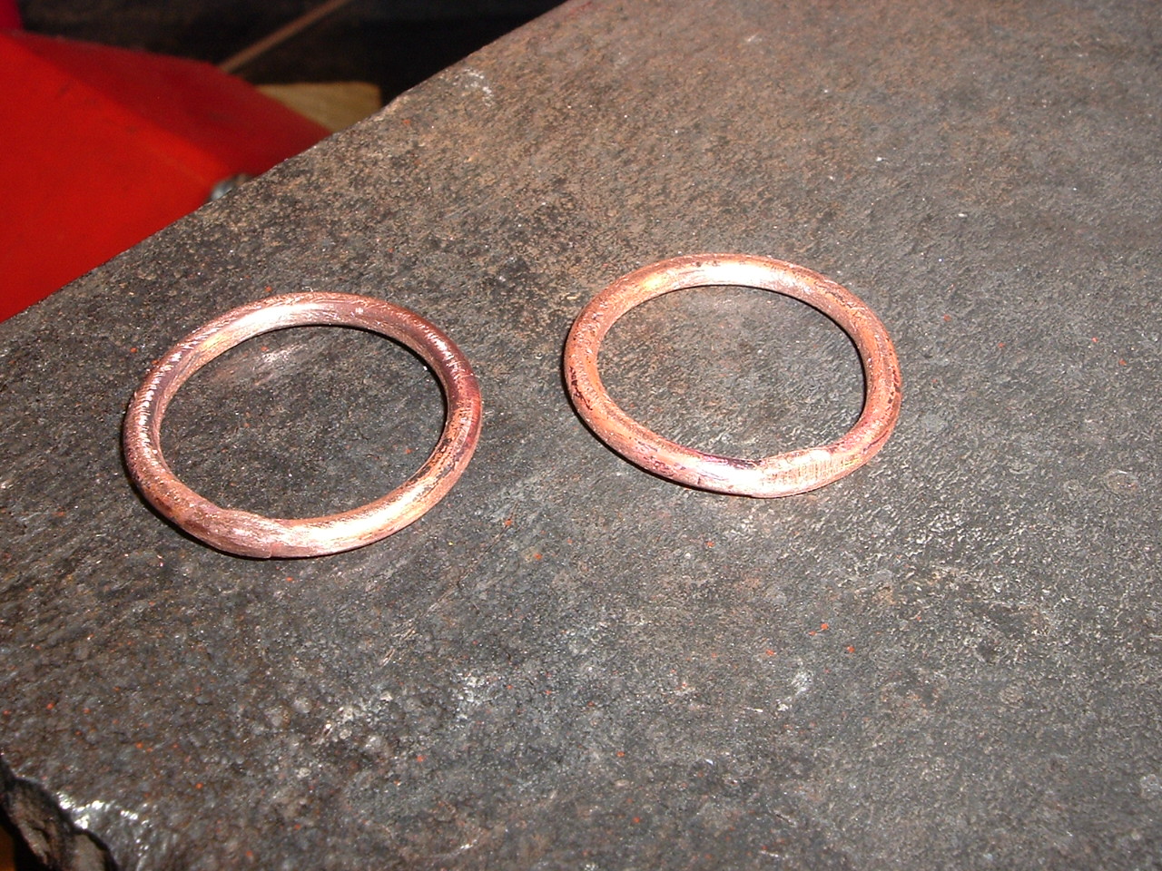

This is what I did also. The advantages of stick are versatility and low cost. Low cost to buy initially, and low cost to operate. It is also very simple. MIG is generally agreed to be the easiest to learn but is more expensive to purchase, more expensive to operate, and has a lot more complexity. (moving parts and pieces). All of the process's have their place and advantages and disadvantages. But I will say this, for a $269 original investment, my little Everlast PA160 DC stick welder has certainly been a good investment. With the addition of some ebay parts (regulator and TIG torch) I have a setup that does all I need to do. From heavy steel welding to welding small parts of steel and other metals (for example copper) I do most of what needs done.
