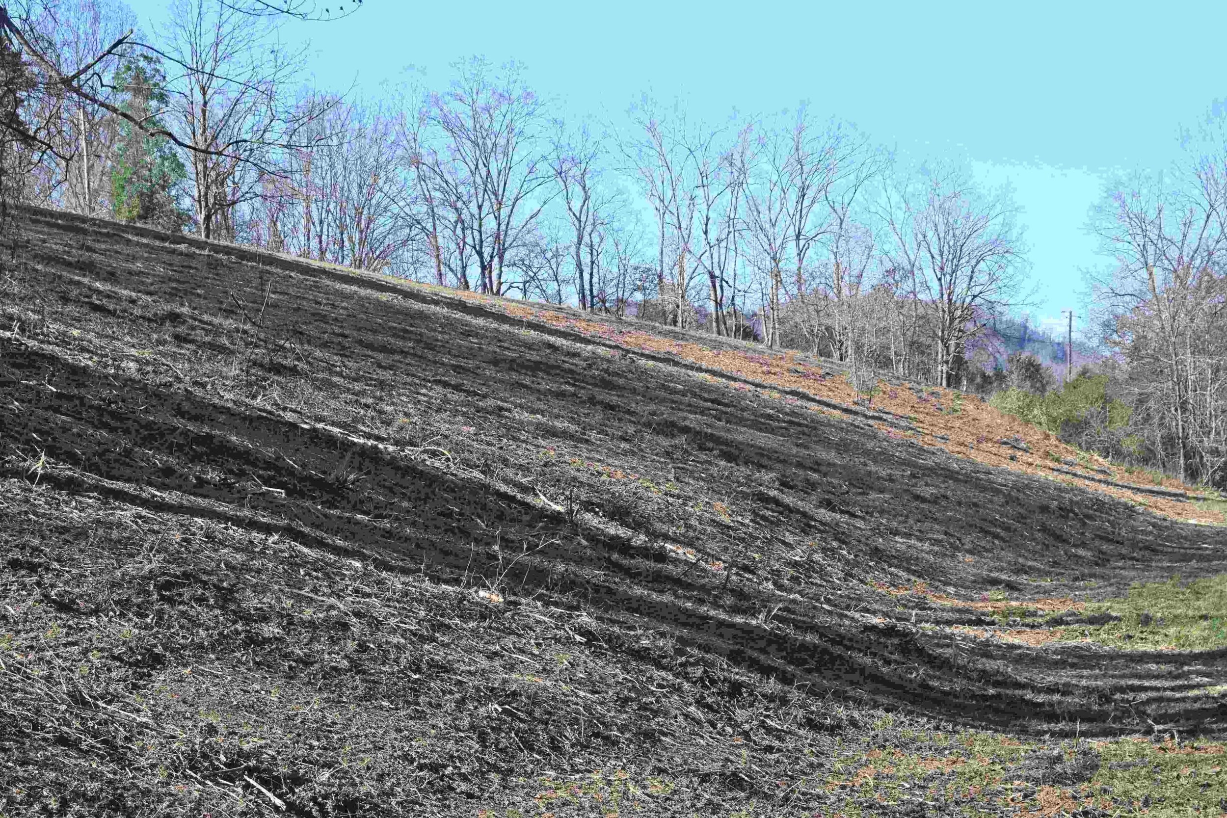

2-6" tree growth is essentially chainsaw work, then moving the debris somewhere else either by dragging it or moving it with a grapple. If there are thorn trees, odds are you'll have flat tires. If the tires are loaded with liquid ballast for stability, then that is an additional problem. Plus, how the heck are you going to handle the thorn trees if you have to use a chain saw on them without getting impaled yourself?
Tractors are also not the easiest machines to work with in forest environments.
Instead of undertaking this laborious and time consuming task that can turn into a never ending weekends eater, I'd strongly recommend that you keep looking to hire a forestry mulching service. Call the local Fecon, Caterpillar and Kubota dealers-ask them if they have customers who do forestry mulching. Keep looking and get multiple quotes.
In my area of middle Tennessee, there was a mulching service that advertised on the internet. Guy shows up in a brand new shiny truck. Quoted me two machines for two days at a fixed price. Then I happened to see a local outfit who came out and said $185 hr and then they gave me an estimate of the hours needed which was about half of what the first dude quoted using only one machine.
The local guys came out in a not so shiny truck and mulched up years of overgrowth in a few hours. They could clear overgrowth in a matter of minutes that it would take me a week to clear with a chainsaw and tractor plus they were able to mulch it up and there was no debris to be moved somewhere else to pile up that would take years to rot.
When I saw how productive they were with their machine, I added to their job.
After you get it mulched, you will then be in a much better position to assess what kind of machine you need to maintain it.
