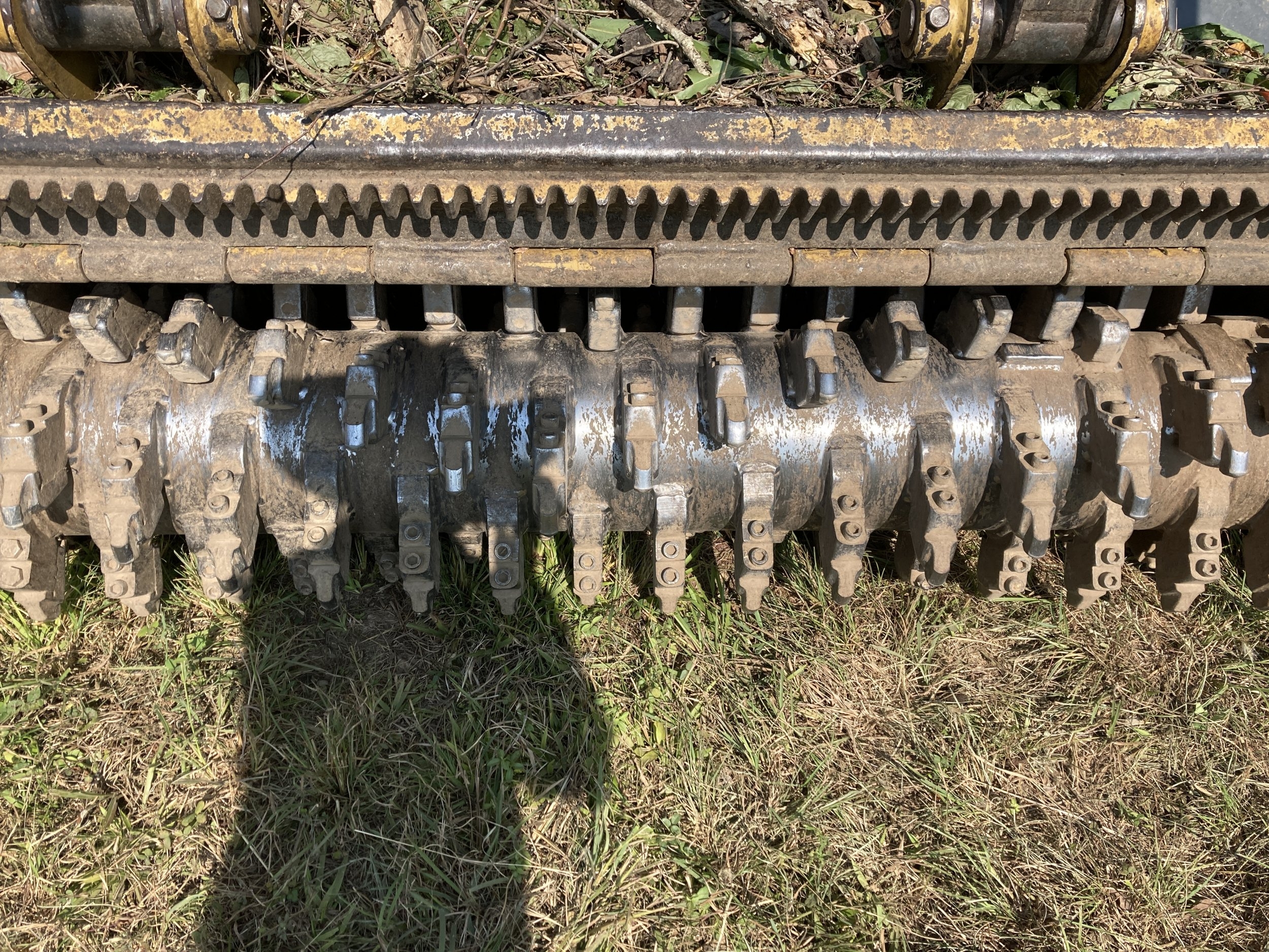

Regarding forestry mulching, we had 3-4 acres cleared with two large machines. Given the size of some of the trees they had to clear it was probably the right thing for us for a first pass, but going forward I'll look for a skid steer with a mulching head -- more precise work.
