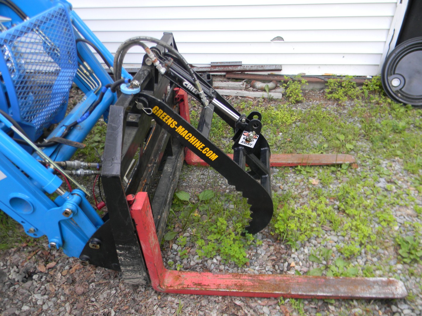

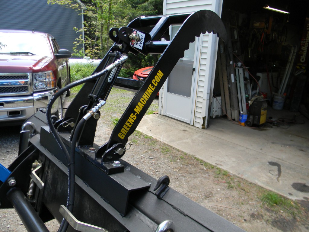

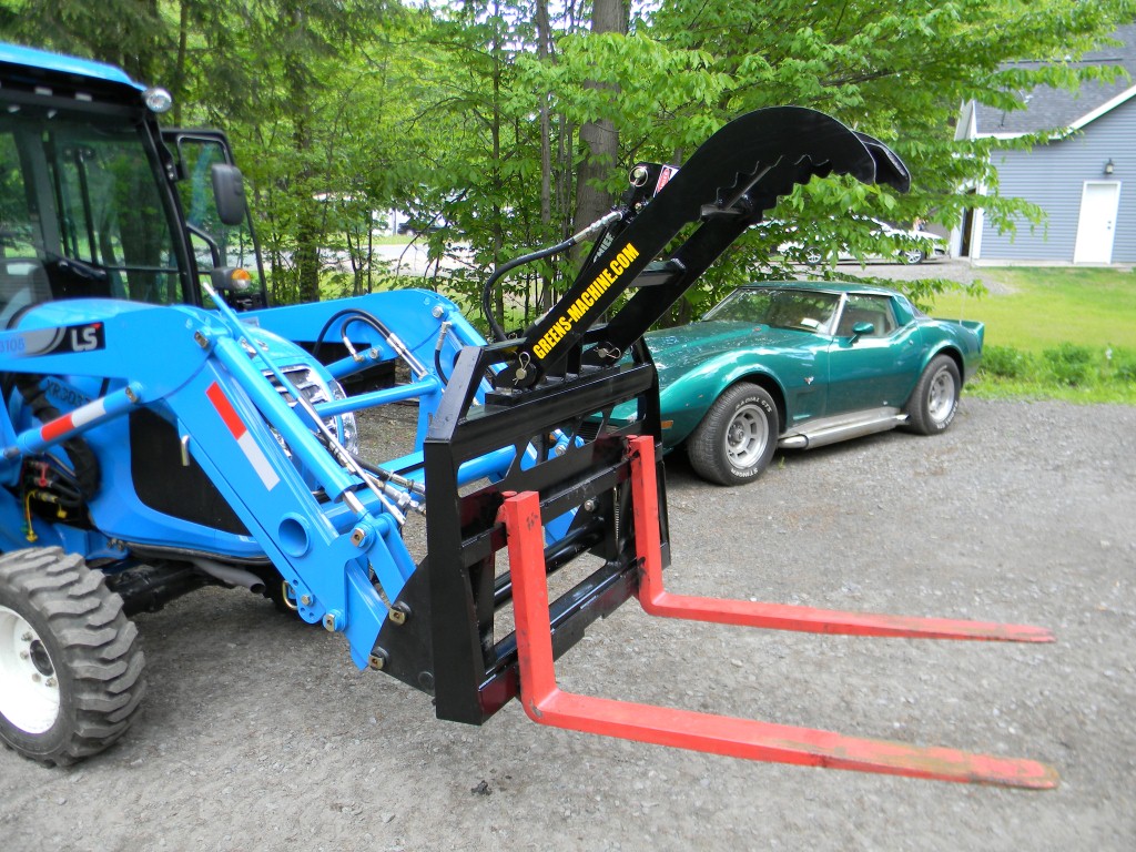

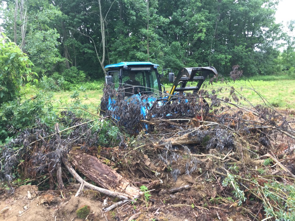

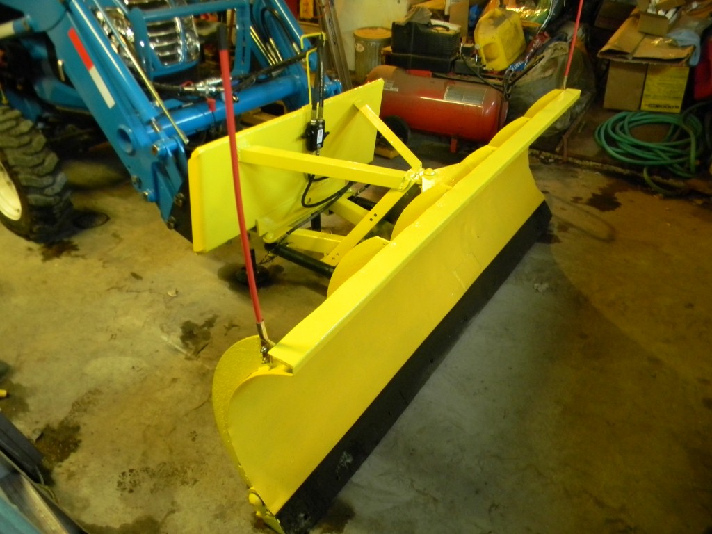

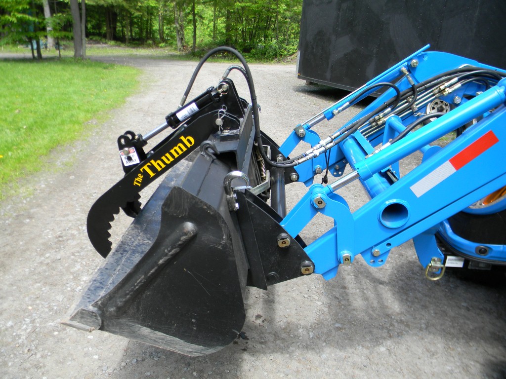

I added front hydraulics by running hoses from one rear remote along the frame to the front for my homemade QA power angle snow plow and for a hydraulic thumb on my forks (another good option to have). QA forks are readily available for about $500-550 online with free shipping. Adding hyd lines like I did will cost about $200. if you do it yourself. My hyd. thumb was about $600. or you can get a full grapple if you need one.

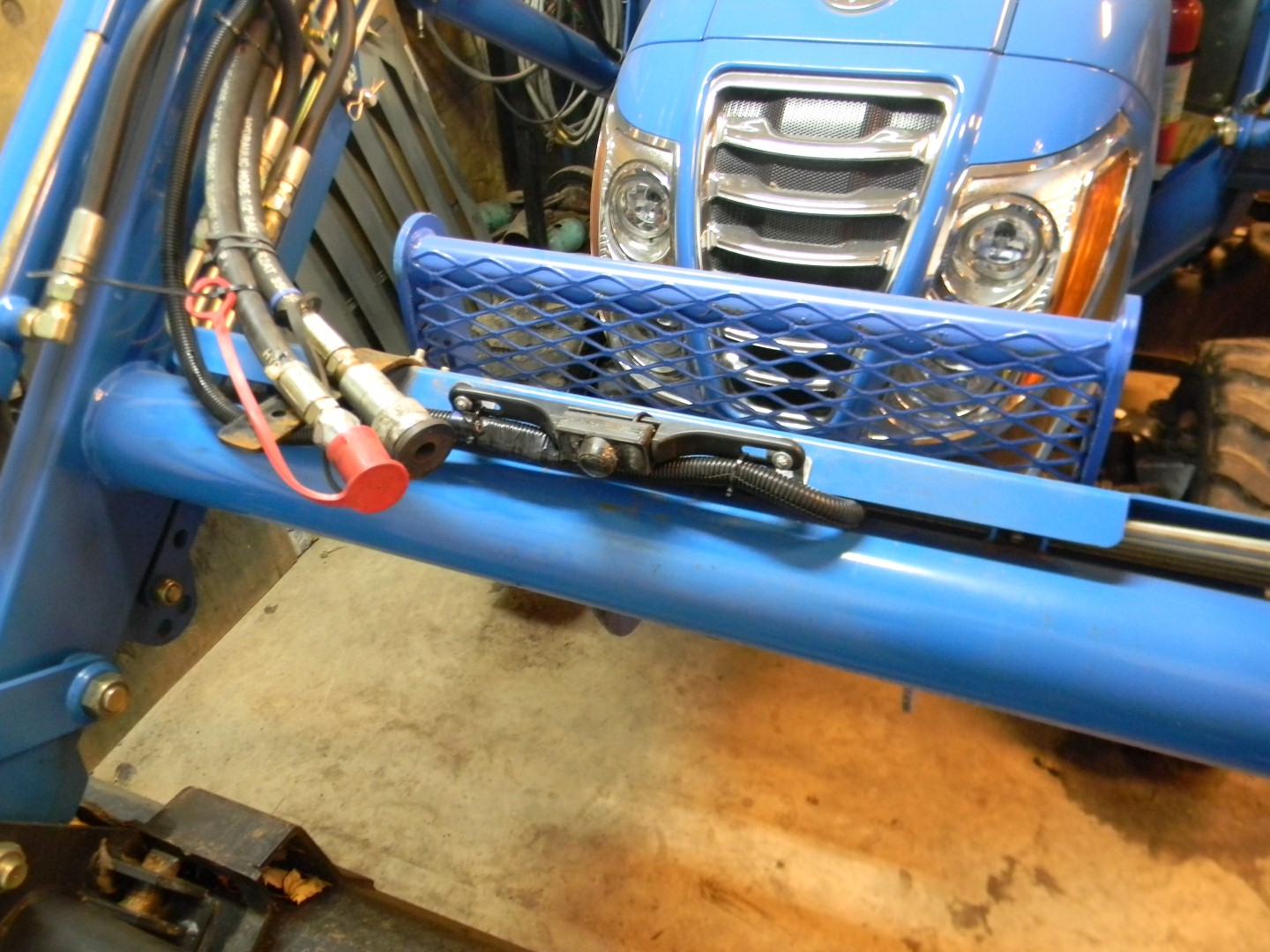

Thanks for the reply. One thing I'm curious about is the 3rd function. I don't mind spending the money to have one added but I don't see where LS has a factory 3rd function setup for the dealer to install. Everything seems to be aftermarket and I kind of want that factory look by getting some from the company that makes it. I don't remember seeing a spot on the joyestick to even put a button. Those that have a 3rd function or those that have ran the lines from one of the rear remotes can you post pics of what your setup looks like? I"m trying to avoid having the valve stick out in the open with some random button that looks like it was just screwed in type job. But if that's what I have to do then I may have no choice.
   / First Tractor Advice XR3135HC or XR4140HC #4
For mine I bought the hoses and fittings from my local TSC store. I used right angle fittings on the hoses and plugged them into one rear remote. The hoses are 1/2" hyd. hose zip tied along the frame and loader arms to the front. If I need that second port for use in the back I can unplug the hoses that go to the front. For using any front attachment I control it using the remote control lever to the right of the seat. I'm sure a dealer who has good hyd. mechanics can adapt an aftermarket 3rd function. They would have to replace the joystick handle with the aftermarket one that has switches / push buttons.

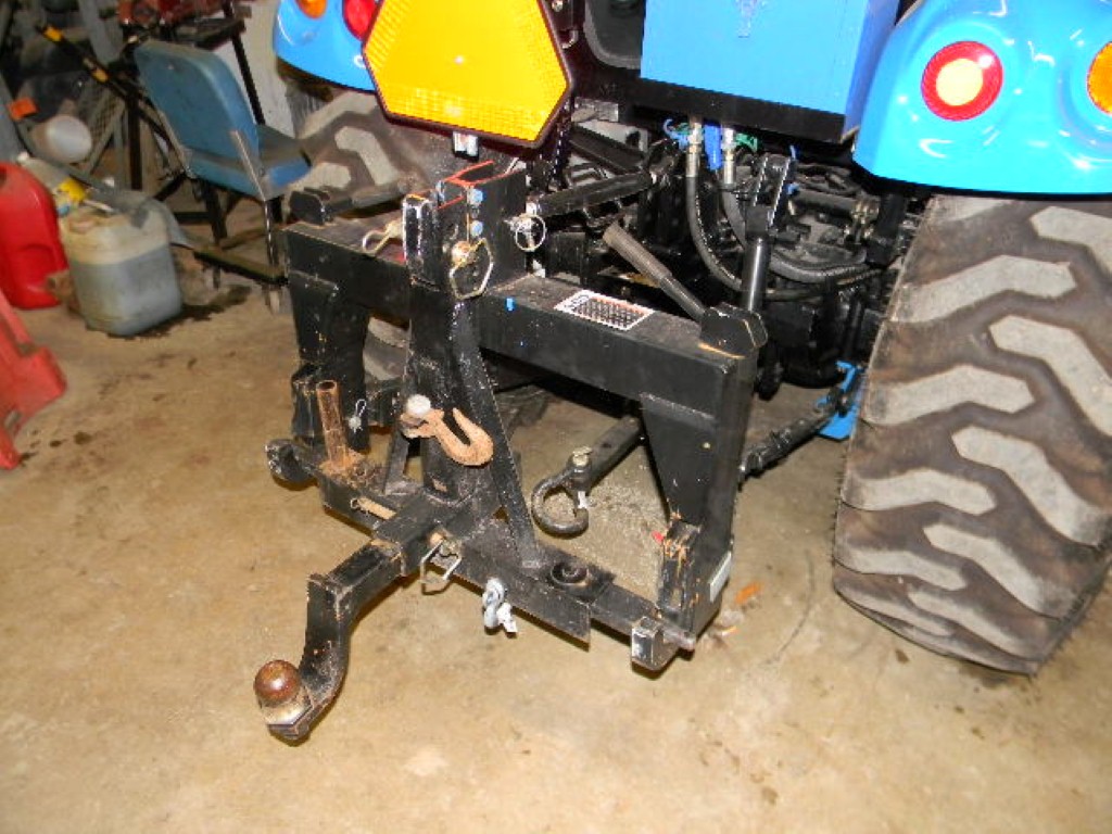

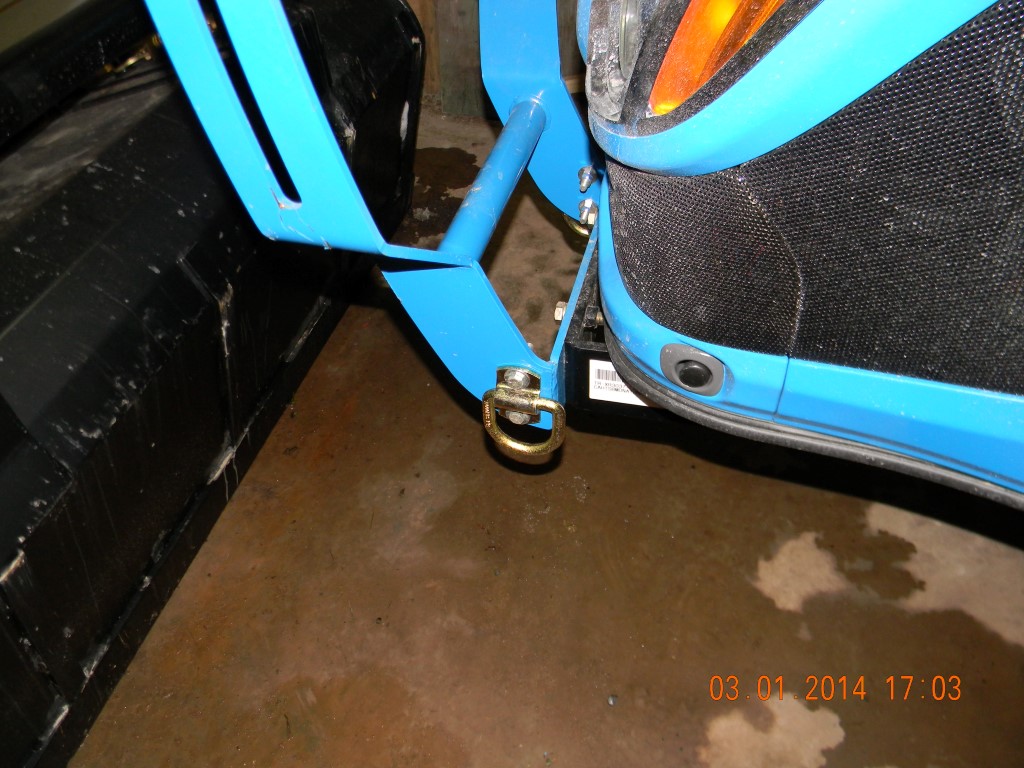

A couple more things to add after purchase (or maybe have the dealer install before taking home) would be chain hooks on the bucket. I also added D ring tie downs and a HD twisted clevis on the draw bar for securing on trailer.
