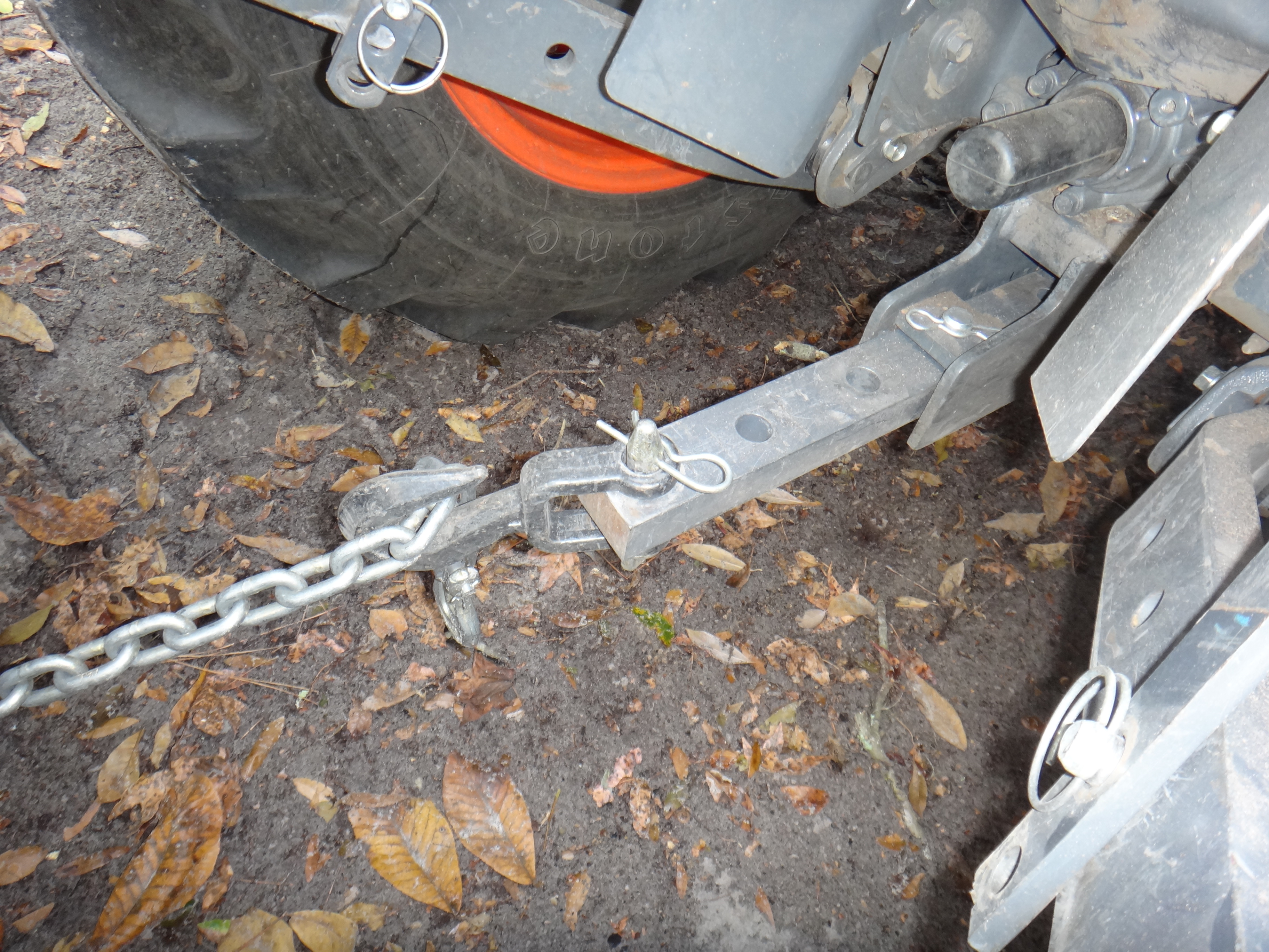

A 2,700 pound bare weight tractor with 4-WD can pull heavy logs from the drawbar. You need a rear/center drawbar and a chain grab hook. You can chainsaw oversize tree trunks into sections to reduce their mass in manageable segments.
