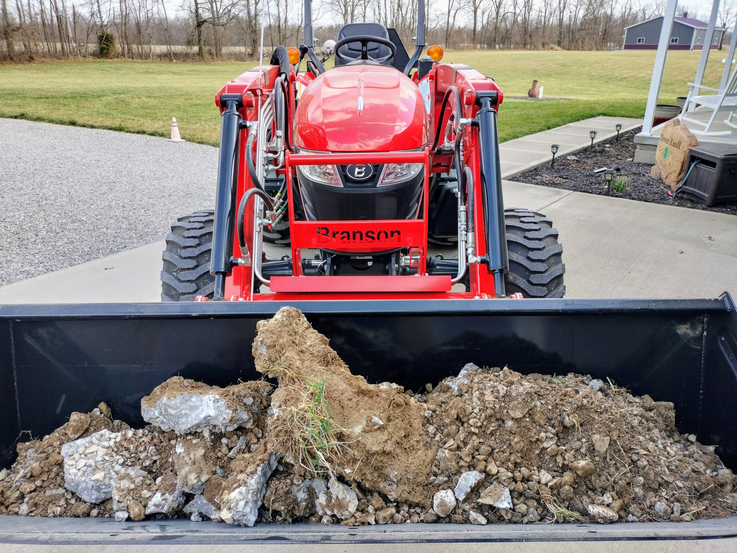

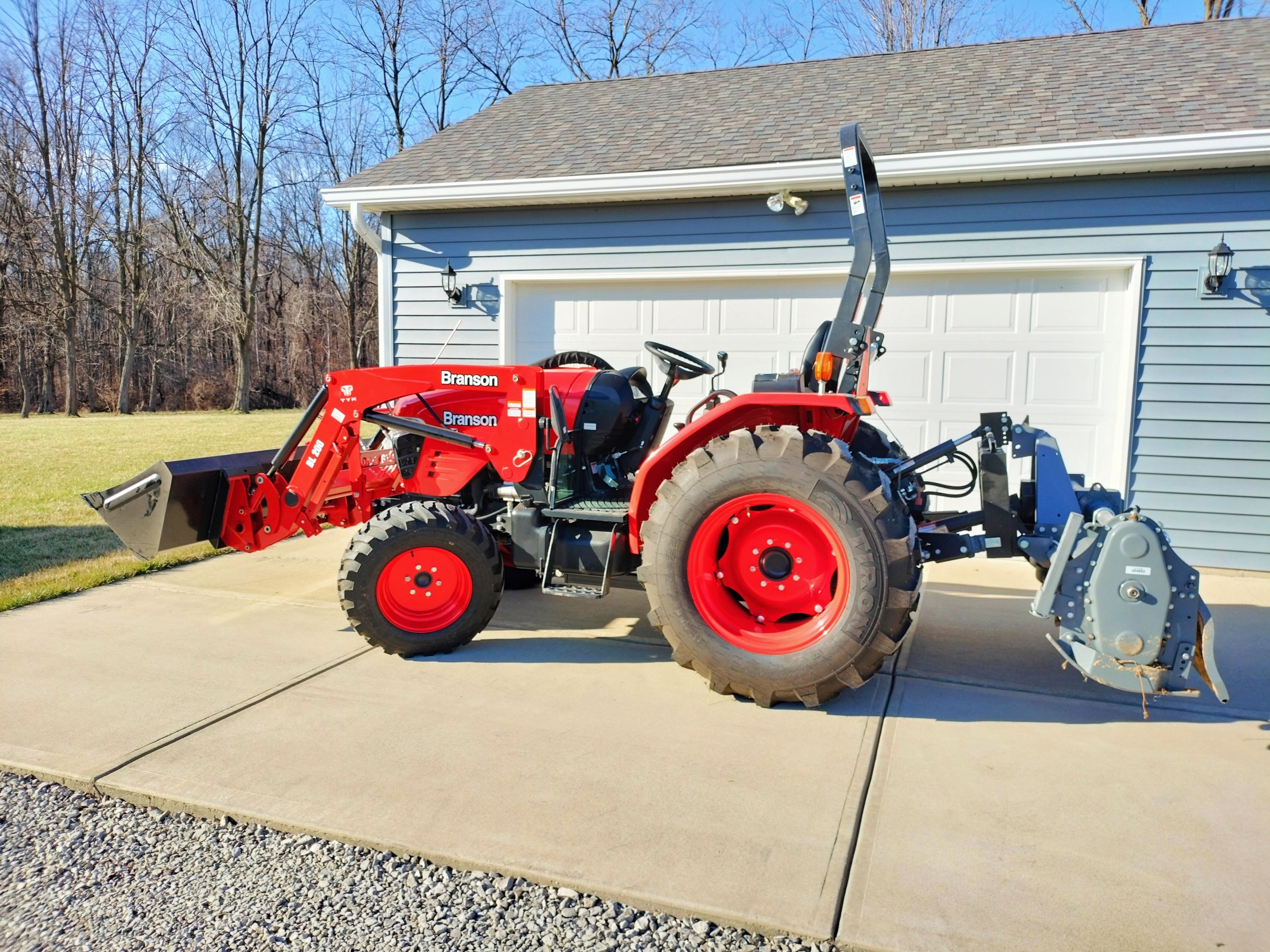

The 5520 chassis is the same as the 4820. They are really compact and heavy. It's about a foot shorter in length than the TYM 494, but the same weight. Without the tiller it's around 5000 pounds. A chunky bugger indeed. Hydraulics are very fast as well. I was reminded yesterday as I did a little loader work.

The 5520 chassis is the same as the 4820. They are really compact and heavy. It's about a foot shorter in length than the TYM 494, but the same weight. Without the tiller it's around 5000 pounds. A chunky bugger indeed. Hydraulics are very fast as well. I was reminded yesterday as I did a little loader work.View attachment 855860View attachment 855861
That's a good looking tractor and one heck of a tiller!
