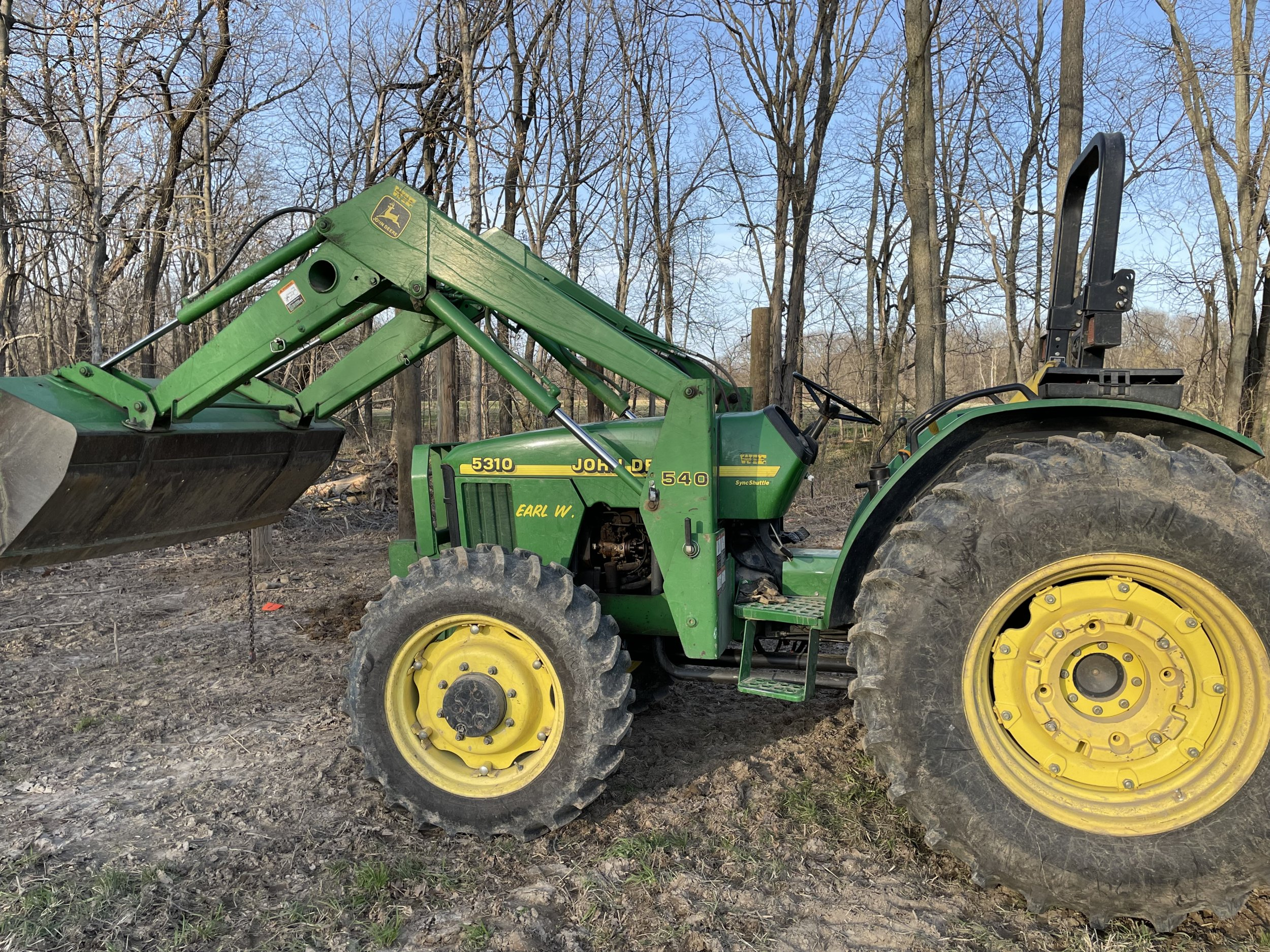

In my situation I have many acres of hardwoods I would like to extract fallen or stricken trees just to see what I can do with them. Better than letting it rot in place. Am guessing a relatively small tractor to fit between trees to pull the trunk out. No need for fancy grapple, drag it out. Winch, long cables.
Then the remaining 200 acres needs something comfortable with a heated and air conditioned cab to mow.

keep in mind that the FEL spec for full height at the pins is a lot less than the lift to 3 or 4 feet, check the breakout and it is fairly linear so 3000lb breakout and 1600lb to full height will have you somewhere around 2100 lb at 4 feet. This is not exact but keep it in mind when sizing your needed FEL capacity. I agree with other comments to buy larger than you think you need (within reason).
As to fixing up an older tractor I'm all over that normally, the problem is that right now 6 year old 500hr used tractors are selling for close to the cost of a new tractor that will have a warranty and 0% financing, so not a lot of reason to do that right now. Given a year and that may change given the way the economy is going right now.

Yes, that's a good option. I ended up going with the Branson 3015H for $22,949. I'm buying it from a local dealer but he's having it shipped from Georgia so I should have it by the end of the month. I did look into most of the options considered here. An older Case 580 or similar probably wouldn't have been a terrible choice but I would have given up 4WD and it might have taken a while to find one with a PTO. I think the Branson's 2200lb loader capacity will be adequate for most of what I want to do. I'm thinking of trying to design a grapple that holds the load as close to the tractor as possible to maximize the lift capability.
