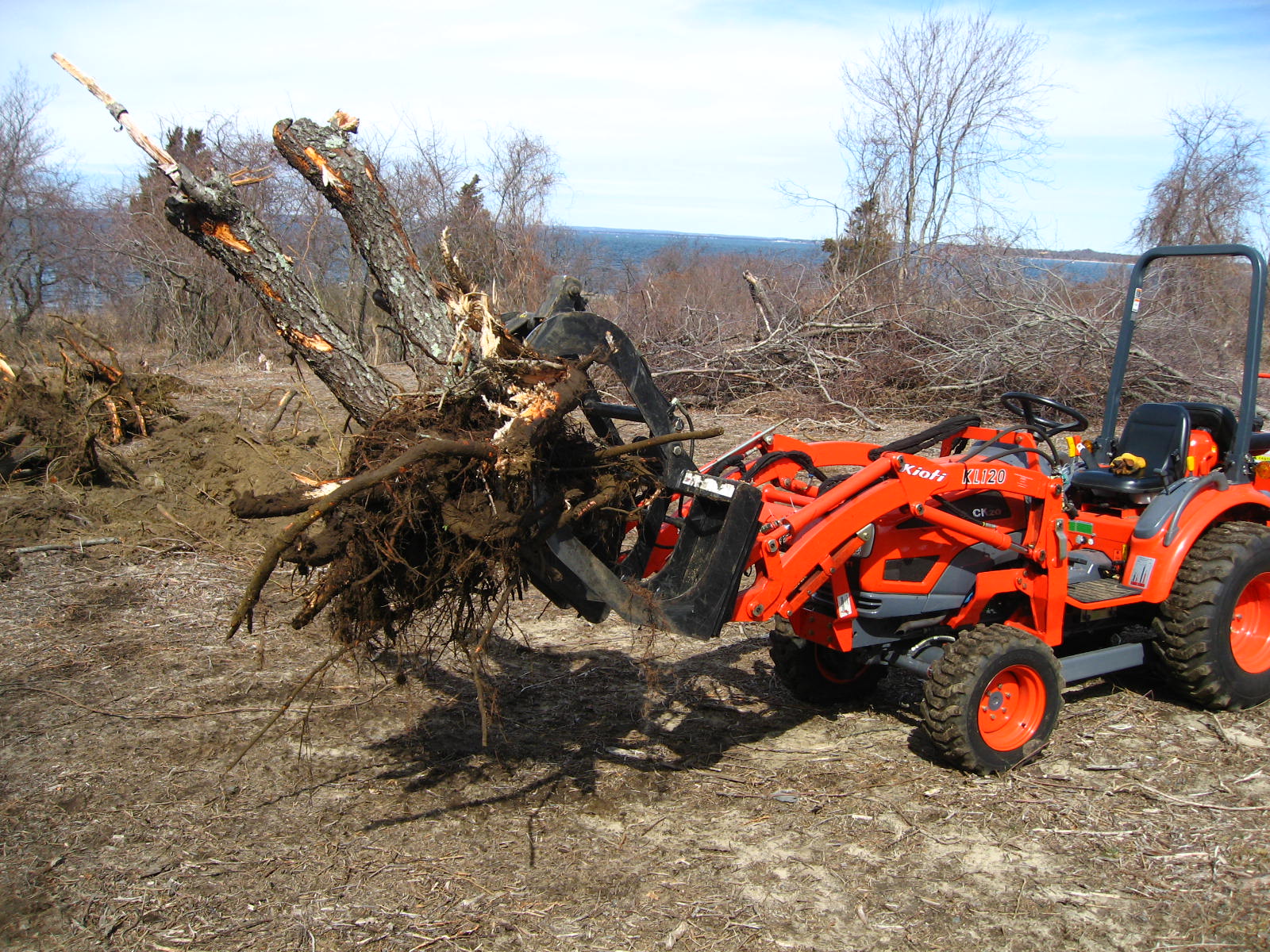

I have the 48" grapple from palletforks.com. On my ck35. They say its just under 400 pounds. I don't think it's that heavy. Remember, your removing your regular bucket, which will give you another 150 pounds of lift (after you subtract the weight of grapple).
Not really. When they list the lift capacity of an FEL, it doesn't include the bucket. So, you're not gaining more lift by removing the bucket. Take a loader that can lift 1,100lbs, and put a 400lb grapple on it, and you're only going to lift 700lbs.
In the same scenario, the loader on a DK will still lift 2,000+Lbs, even though the grapple will likely be a bit bigger/heavier, which will let you handle a decent sized tree section.
I lift logs for firewood with my pallet forks and I've maxed out my loader regularly (it will lift about 200lbs less than a DK loader...sort of fuzzy because it has a higher breakout force than a DK).
/ First tractor purchase #22
Bart, your probably right, I never looked.
But, I did pickup my new to me Gil sr20 box blade with the grapple. I believe the gil is 975 pounds. I think the Kioti specs are conservative.

I think wanting the grapple pushes you into DK40 territory. Maybe with r4's you could finish mow with it, my r1's do rut soft ground. R4's on the DK are width adjustable so maybe it could be set very narrow? I like my DK as with the big box blade on the back, it's a lifting, pushing machine. I had a few trees come down into my fields this spring and I could lift the hardwoods to buck them and jamb the softwood into woods.
I have 2 points.
1. You mentioned a grapple bucket is on your "wish list". The CK27 - CK35 uses the KL 130 loader, which has a lift capacity of about 1,100 lbs. This includes the weight of the grapple (300 - 500 lbs), making the load limit around 600 - 800 lbs. (1 - 16" red oak log, 10' long). Basically, the grapple could be 50% of the loaders capacity.
The DK loader (KL401) capacity is about 2,700 lbs. Grapple would be 11 - 18% max.
2. You mentioned the CK is as big (dimensionally) as you would like. The DK is 12" longer and 9" wider than the CK. Not a huge difference in dimensions.
I'm not advocating for a DK vs a CK, but I just finished owning a CK35 for one month, before trading up to a DK40 and don't want someone else to make the same "ill planned" decision. Get whatever you want, just understand all the issues before you do.

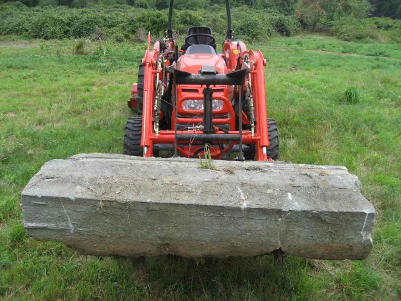

I lifted it out of a 2004 4x4 silverado hd2500. On the tips of the grapple. I'll take some pics next time I'm down at my property. I shouldn't be saying this but, I had no weight on the rear end.
