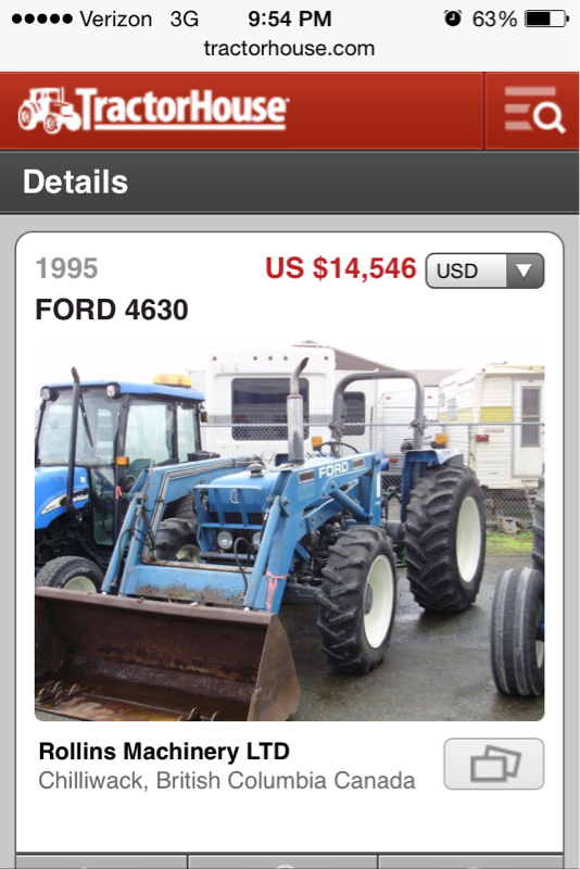

   / First Tractor - Which way to go? #59
Right here's your bang for your buck. Super reliable ,efficient , and simple to run and maintain
