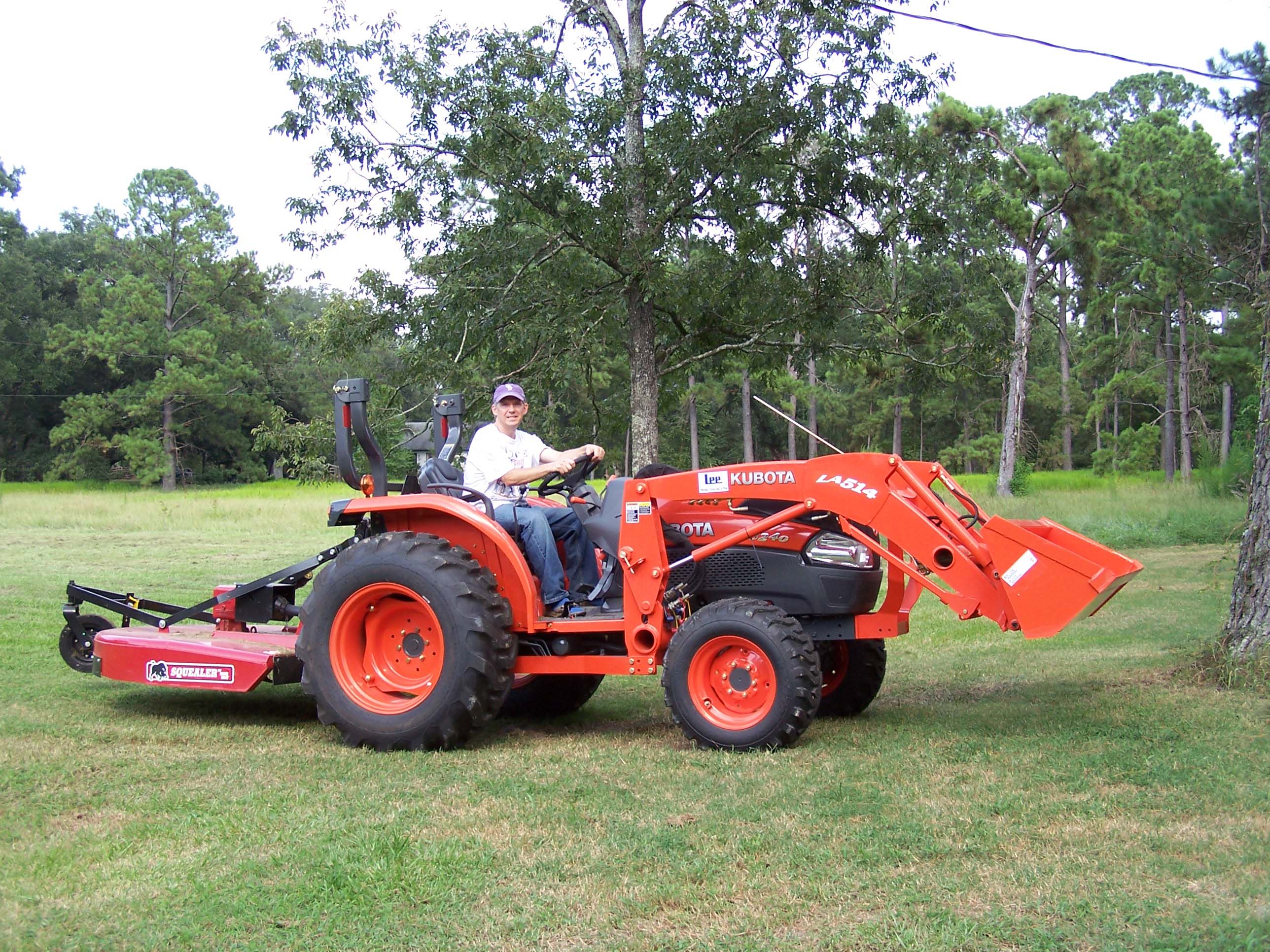

Thanks for all the great advice guys. I finally pulled the trigger and am now the proud owner of a Kubota L3240DT with the LA514 FEL and a 5 ft bush hog squealer. So far everything looks good. I've already bumped a couple of trees so it's going to take a while 'til I get the hang of driving around with the FEL but I've already used it and have been thrilled. It came in handy while cutting as there were several large limbs that I was able to move with the FEL avoiding stopping to manually remove them. I can't wait to see what else I can do with it.
The 5 ft cutter looks to be just what I need. My wooded acreage will be easier to maintain with the smaller attachment. It also bogged down a few times while I was cutting today so I'm pretty sure I'd have trouble with a 6 footer. Things grow pretty thick and fast down here in south Louisiana so I think I need the 5 to get any kind of speed while cutting. Even if the 6 would take less time overall I think it'll be more enjoyable/tolerable to cut when I can feel a little more of a breeze.
Thanks again to all who replied.

Well thats quite a nice lookin tractor ya got there, It should tackle anything you can throw at it I am sure.
Makes me wish I had a 5 footer for some sections of my pasture. The 6's are definetly longer and require more clearance to turn in the trees. I think you made the right choice with the 5 footer. I still have that new tractor feeling going on as I managed to get some seat time on my New Holland today mowing ~1/4 of our 30 acre pasture. Its the section with all the trees wich definetly takes a bit of time to manuver up and down the hills while dodging trees. I would have definetly spent less time doing the back and fro dance between the trees with a smaller unit, and perhaps could have mowed an extra acre or two.

Congrats - looks like a very nice setup.
I still bump the occasional tree or post with the FEL. This can be minimized by lifting the bucket to full height, but that looks funny and reduces stability if you're on any slopes. Ideal answer is to remove the FEL for mowing, but I don't want to bother doing that. You will get the hang of it with time. Until then, try not to let the wife see where you nicked stuff. :)

Sciguy
Looks like a great set up for your land . I noticed in your picture and far be it from me to preach to anyone else about anything. BUT until you become very familiar with the operation and handling of your new tractor I would highly recommend raising the ROPS and as Forrest Gump said that's all I have to say about that.
My next observation is you were concerned about the difference between a 5 and 6 foot mower as far as speed of cut. I have the following for you to ponder.
fuel to cut 8 acres with 5ft approx say $10
time to cut 8 acres with 5ft approx 8 hours @ $25 = $200
Total = $210
same calculations for 6 foot mower increased by 20% =$252
One hour of psychotherapy $300
See a tractor and mower are still a great bargain and you feel so much better after you are done.
