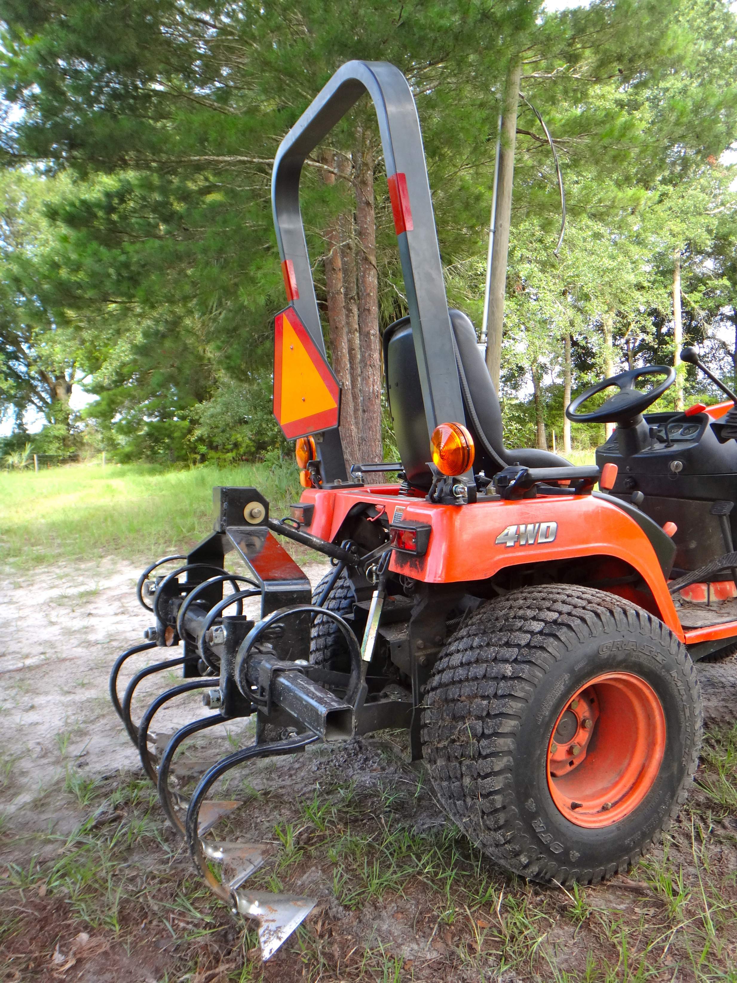

Hi everyone I have a Belarus 250as 31hp. I'm just wondering how do you decide on what size attachments to get? Ours came with a 5ft bush hog and FEL. I bought a middle buster but have a hard time keeping traction sometimes. I am planning on a large garden and want to make sure I'm not buying something that my tractor can't handle. I would like a double plow. And or a cultivator. Just don't know if my tractor can handle a double row 5ft or only a single 5ft etc.

Get all four tires filled with Rim Guard. That will add weight and traction.

Your tractor is 58" wide with R1/ag tires, 31 horsepower and around 5,000 pounds.
You would be better served with a 60" wide, PTO powered roto-tiller in a garden, rather than a Moldboard Plow. Plows take many hours to learn to adjust correctly. In a garden you do not have enough space for plow trial and error. If you get a plow, you will also need a Disc Harrow to reduce the 12" to 14" plow furrows to reasonable smoothness, and Disc Harrows are less than optimum in garden situations. A roto-tiller is an all-in-one garden implement.
VIDEO: PTO tiller - YouTube
How dry was your soil when you lost traction pulling the Middle-Buster? I expect your answer will be DRY. In ag, you have to wait on Mother Nature. Even your relatively heavy tractor is going to have a hard time pulling through adobe brick. Wait on the Middle-Buster until after three to four days of steady rain, then a day or two of dry out weather.
Cultivators only penetrate 4" - 5" into the soil, so draft force resisting the tractor is not high. Your Belarus 250AS should allow you to pull a two row cultivator in moist soil. Most people using two row cultivators would be growing food for market sale, not for the table.
WHAT DIMENSIONS ARE YOU PLANNING FOR YOUR GARDEN? WHAT USE WAS MADE OF THE LAND, WHICH YOU NOW SEE AS YOUR GARDEN? PASTURE?
A 1/4 ACRE GARDEN IS ALL A FAMILY CAN MANAGE WITHOUT THE GARDEN BECOMING AN ONEROUS TASK RATHER THAN A PLEASURE.
Many would cultivate a kitchen garden with a Middle-Buster plus Roto-tiller for soil preparation, then hand tools or a small gas powered tiller, such as a Mantis, for cultivation.

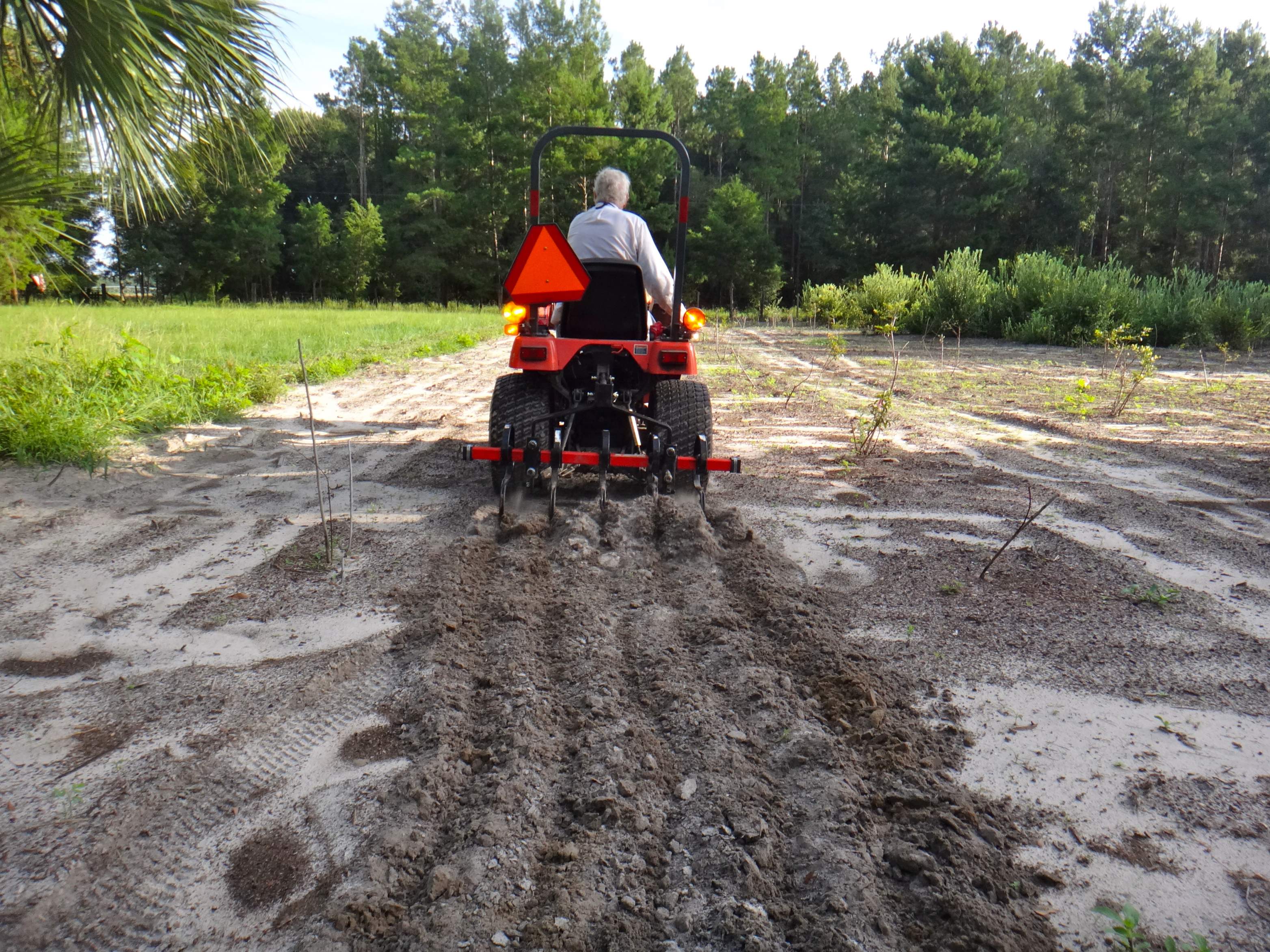

LINK: 3 Pt. Hitch, Toolbar, Cultivators, Sweeps, S-Tines, Disc Hillers, & More!

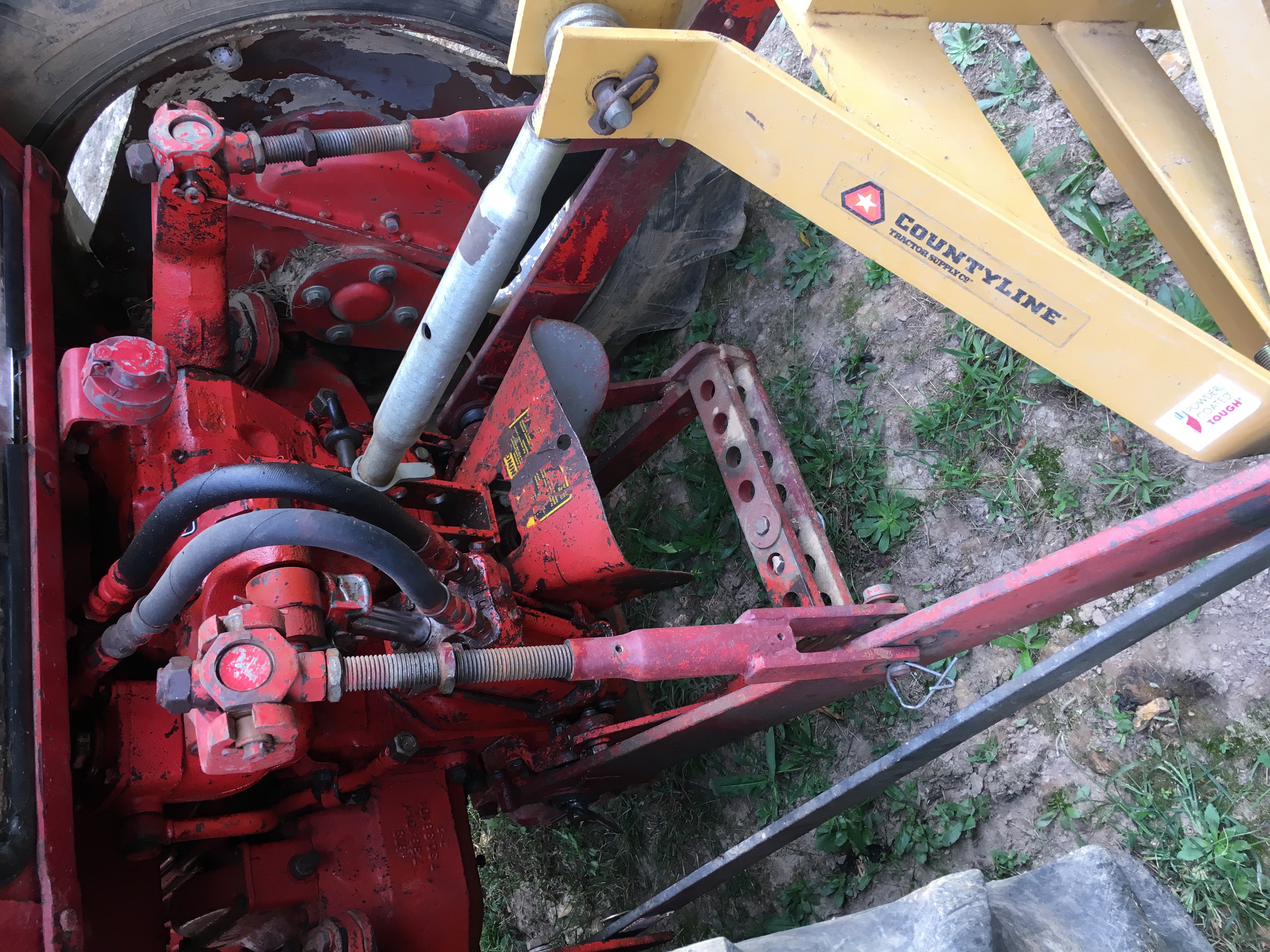

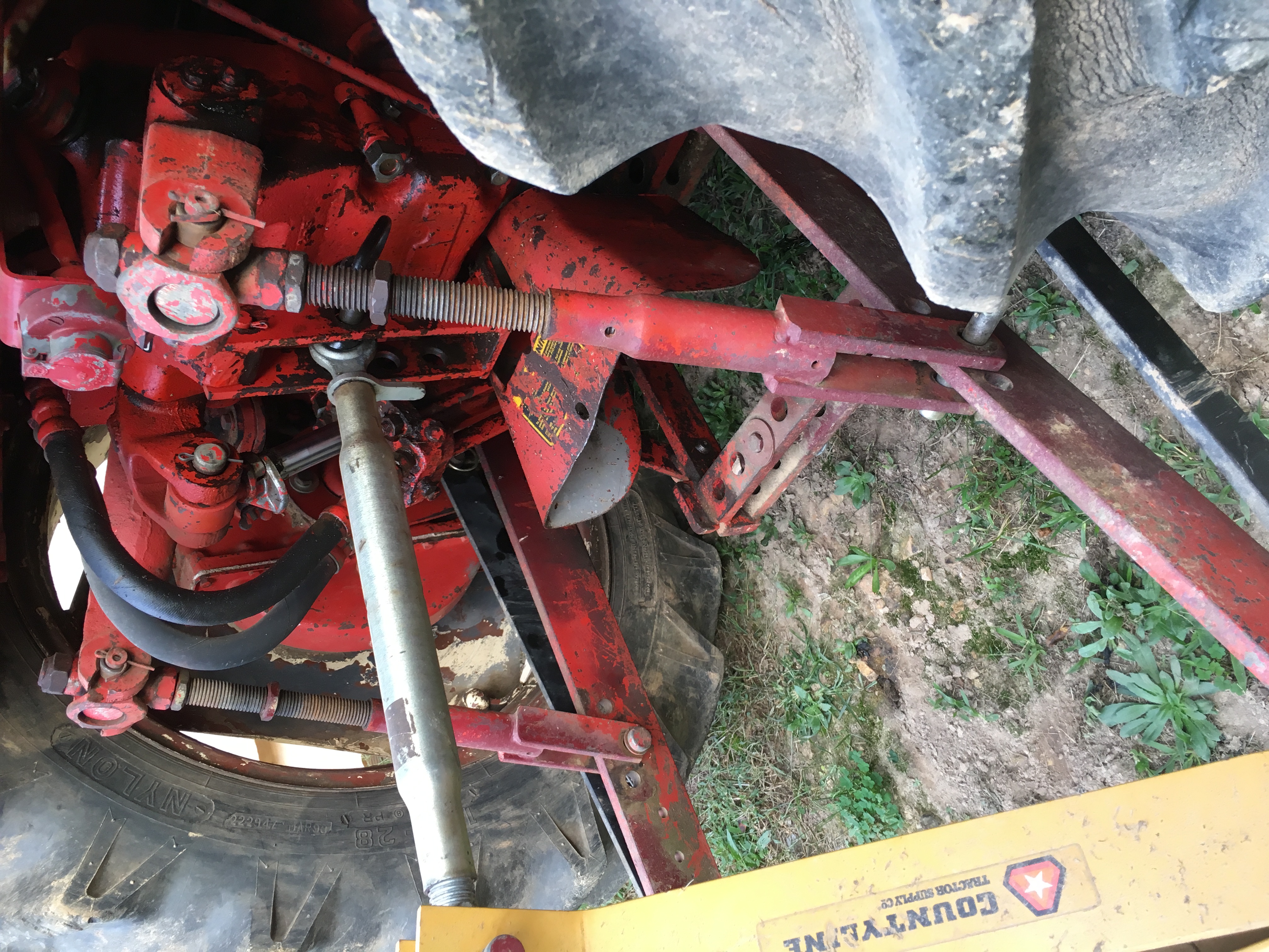

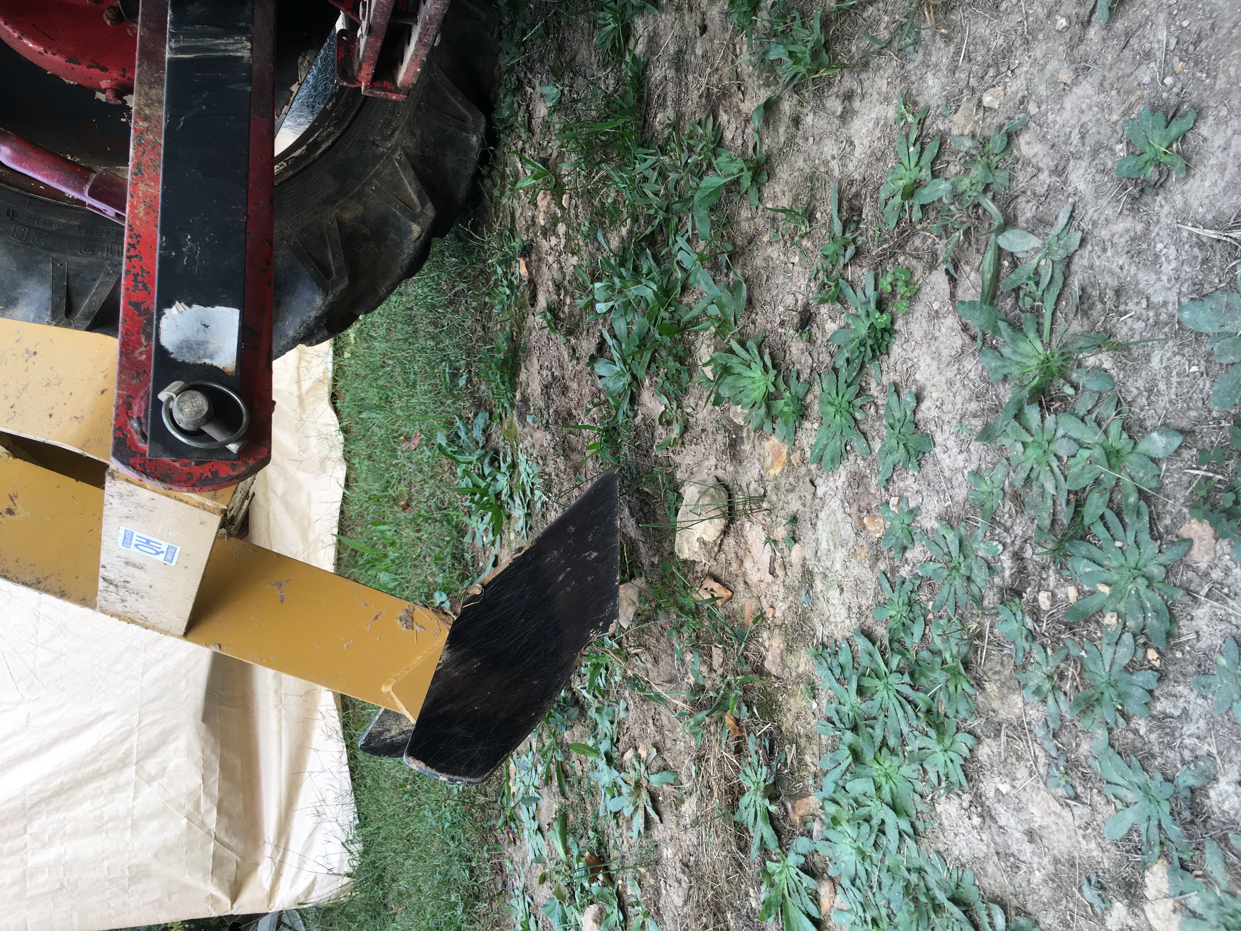

Thanks, yes the ground was dry couldn't tell you the last time it rained to be honest. I knew it wasn't the best condition but it was my day off and I had nothing going on.
I was able to go through it about 3" deep to get the sod out the first pass then another 4" the second pass. I stopped in to our local tractor junk yard/store the owner didn't think I had enough hp for a cultivator and recommend a roto tiller as you suggest. I was just hoping to stay alittle cheaper but I don't mind a tiller. I know some folks don't like what a tiller does to the soil. But it beats using a front tine tiller on a large garden. We have a 5-6 acre area that doesn't get used one day I would like to have the whole thing garden and sell to market/ locally. But the lands never been worked as far as I know. I would start small. I have had gardens for awhile just small scale.

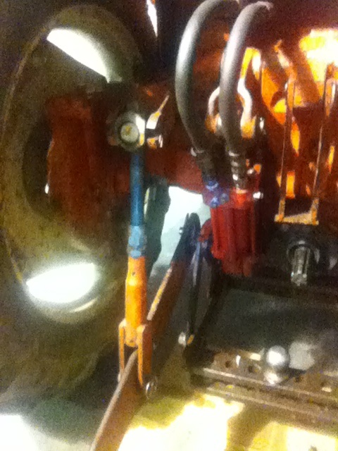

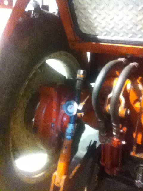

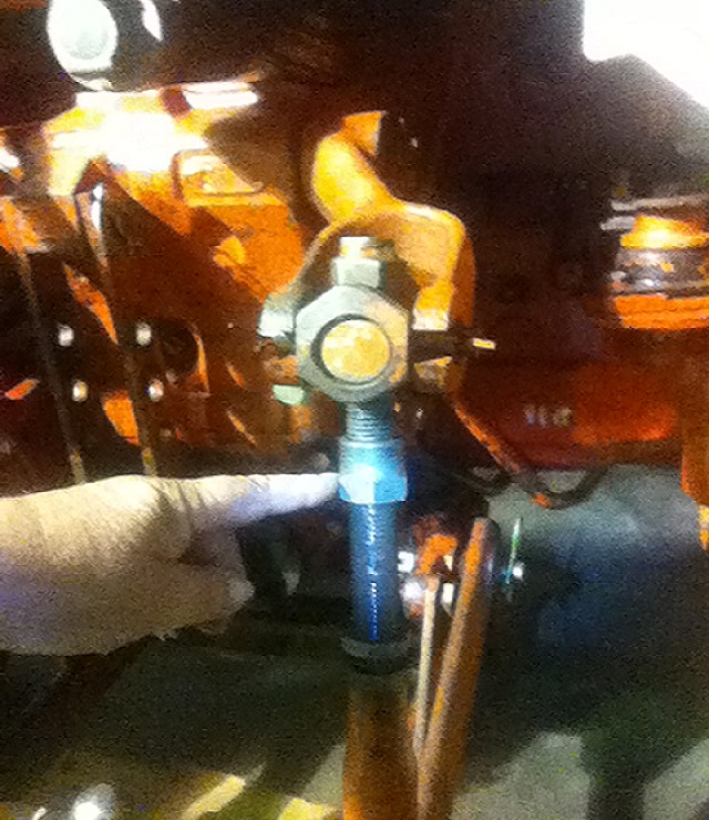

There is a way to adjust some nuts on the lift link (the arm between the rock shaft and the lift arms) to help eliminate the down pressure problems but I'll have to get a few pictures to explain it. It'll probably be tomorrow before I can get the pictures though.
