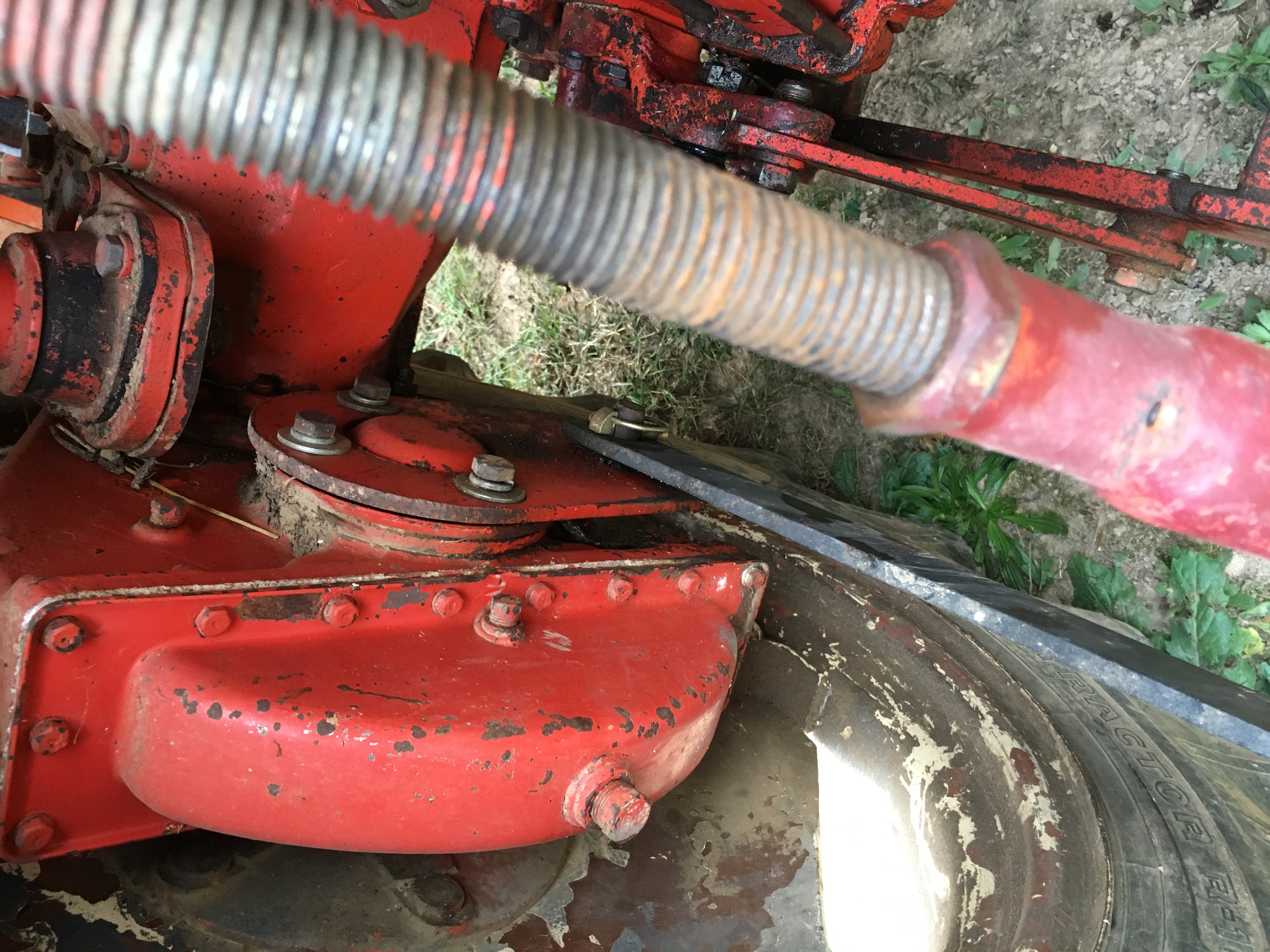

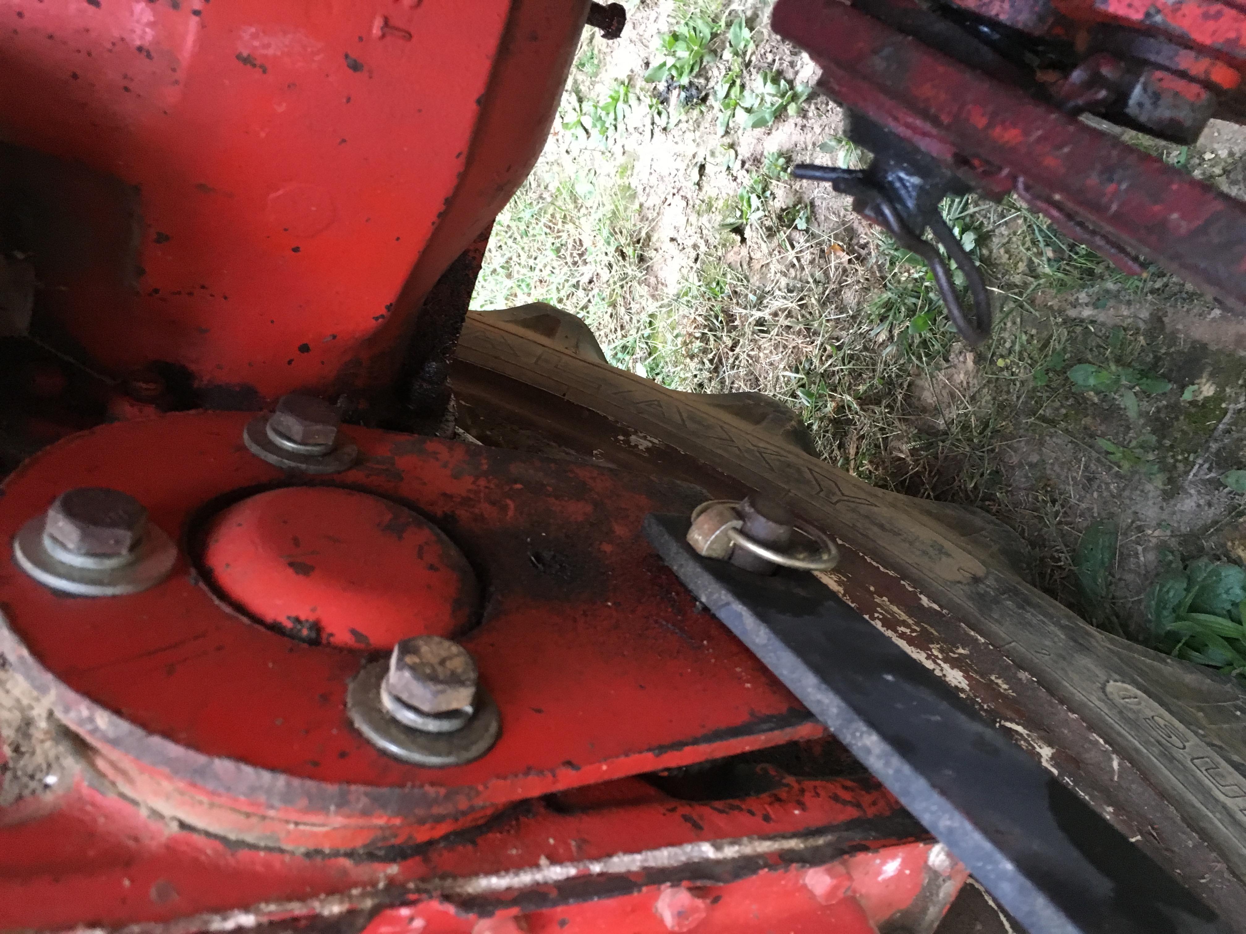

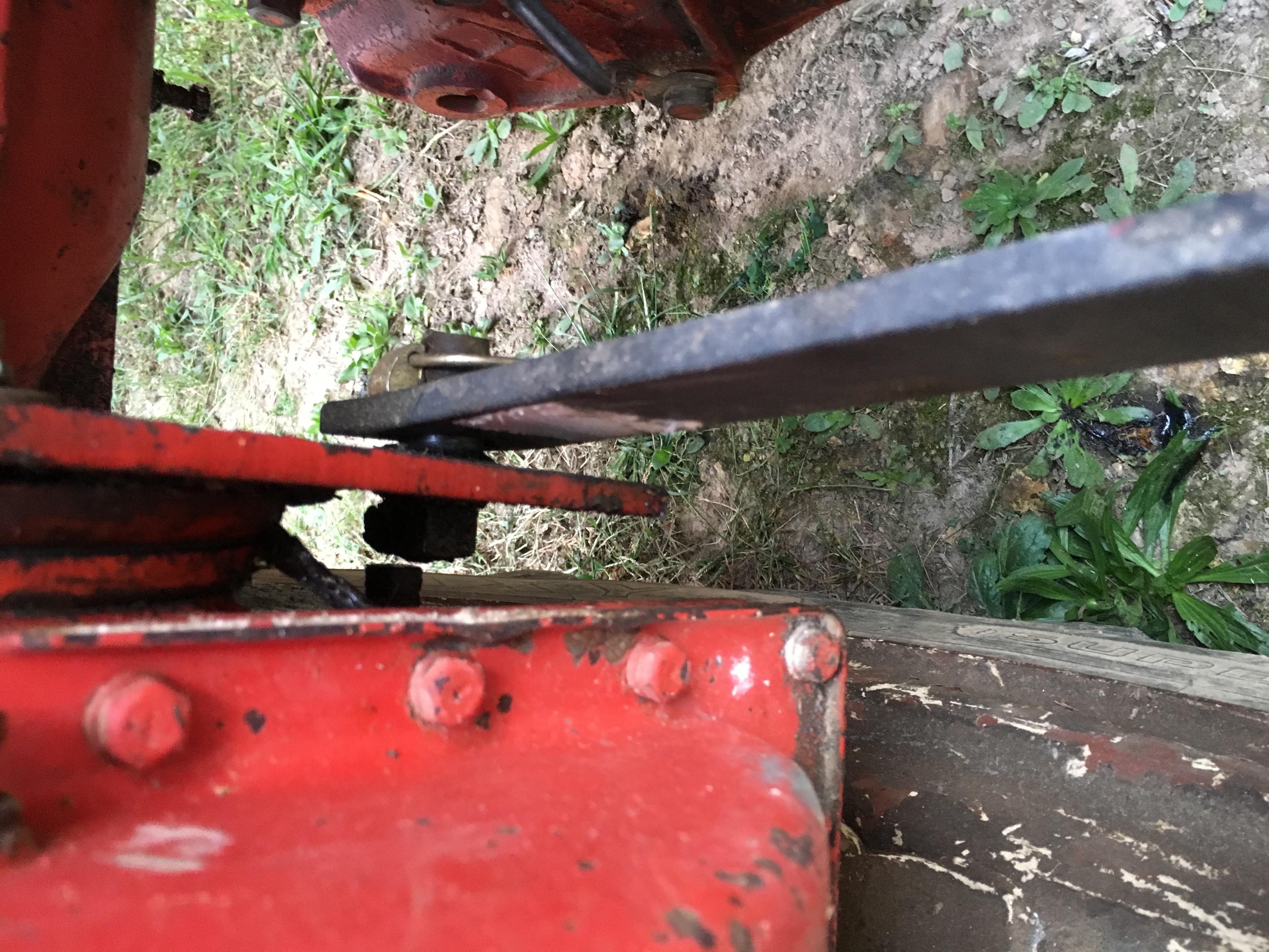

I see you have stabilizer bars kind of like my ford. My Belarus don't have those or a place to have them. Have yours been added? Next time you get a chance if I could trouble you I'd like to see how the stabilizers are fastened to the gear box (or whatever you call it) next to the wheels. Somebody may have welded pins on it to hold them. I see they are mounted on a pin with a hitch pin holding them but I can't tell how the pin is mounted. I like that idea better than the cross chains mine has.

That makes sense. When I purchased the tractor it had the bush hog attached and I believe the nut was ran tight against the bottom part. I will tighten it back down and loosen the top one off. I have no problem taking pictures of the mounting setup for you. I'm not sure if it's original but there's roughly a 1" thick piece of steel that hangs down past the break system in the axle and it has one of those bolts with the cottorpin holding the bar on. If it is homemade that makes sense because there is a lot of play in what I assume should stiffen it up. The plow or bush hog can and will walk left/right quite abit. I have wanted to add some big washers or a chain to hold it firm.
But I will grab some shots for you tomorrow.

If you need anything else let me know hope this helps. image.jpegimage.jpegimage.jpeg
   / First tractor #30
69clone That looks factory made if it's not somebody done a great job on it and matched the paint too. It might have been and option that none of ours have. That's way better than anything I was thinking about and will get to work building them as soon as I finish those other 3000 projects I've got to do. :) I'm going to move this one closer to the top of the pile though.
Thanks for the pictures and the help. If you need to use the rear aux hydraulics it's easier to get an adapter to change the British Standard Pipe to something easier to get hydraulic hoses to fit. The adapter you need is a 1/2" BSPP female to fit the pipe on the tractor and the other end of the adapter can be whatever you want to use for the new hookup ...example- JIC, NPT, SAE If you're not familiar with hydraulics you can go to Surplus Center online and read forever. They are a sponsor of the site also.
