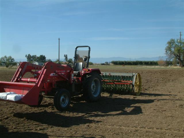

-- Plant in rows with a grain drill--I use a restored Minneapolis Moline P3-6 unit to plant Kanota oats. Bought 2 of these units from a neighbor for $275; used parts from both to make one good drill plus about $250 in new parts.
DSCF0151 (Small).JPGDSCF0156 (Small).JPGDSCF0157 (Small).JPGDSCF0159 (Small).JPG
