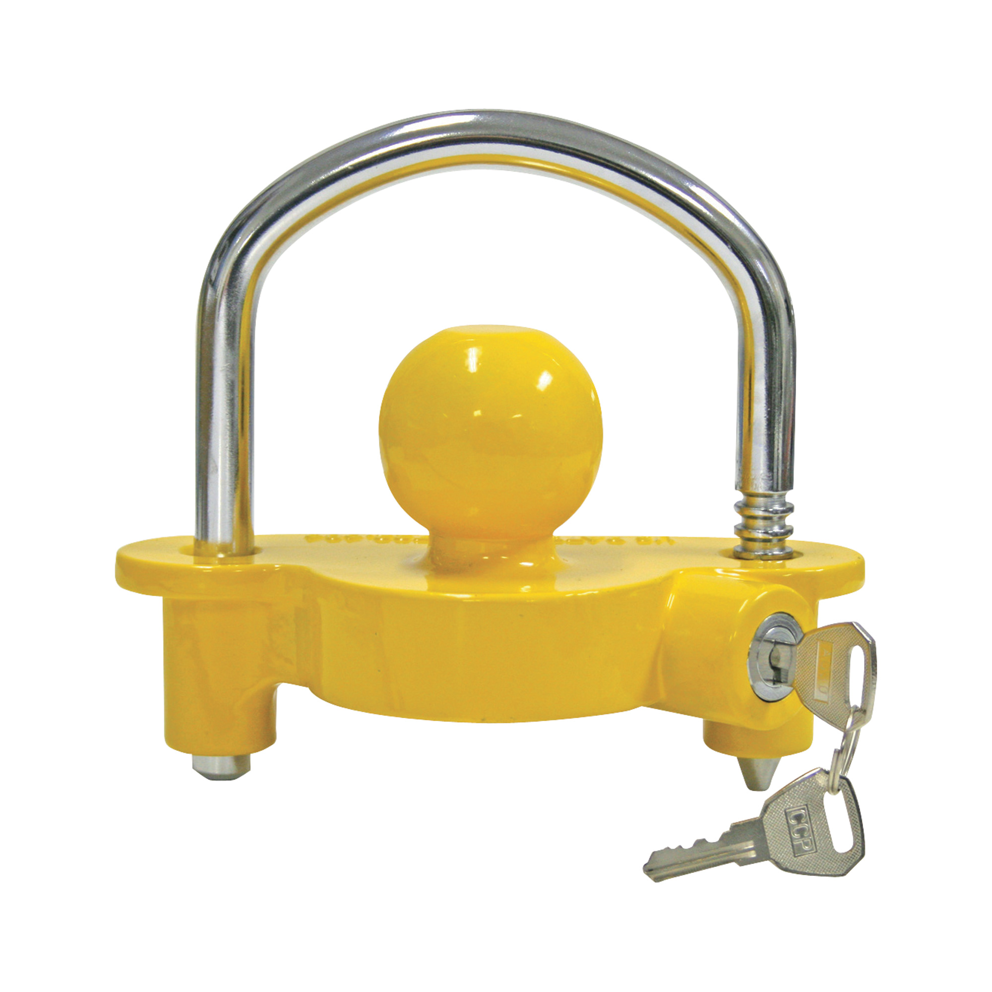

Curious what kind of coupler lock was smashed off?
One of these:
Reese Universal Coupler Lock, Model# UTL100
Notice in the reviews, other people comment how easy they are to break into.
I wished I had seen those reviews before purchasing the one I got.
   / Fish Tailing #55
Seems the coupler locks are just about useless.
Thieves here will use the safety chains and drive off...
A buddy lived in a semi-commercial district and had to chain his trailer with padlocks to his cyclone fence pipe...
Another uses a wedge between the tandem axles so either letting air out or removing a wheel would be needed.
Sad comment about the times.
   / Fish Tailing #56
One of these:
Dude! Don't feel bad. Criminals are criminals and locks are only deterrents to stupid or lazy criminals. You can't prevent theft, only deter it. Heck, they could come up with a truck and use chains to support the tongue and off they go, no balls (pun intended) needed on a hitch. That thing looks like a good place to wrap a chain around even. Just take a 6" drop-hitch, turn it over and you have a mini-boom pole. Back it over the trailer tongue, wrap some chains around it and the boom pole, raise the foot and off you go.
   / Fish Tailing #57
Didn't read your reply before I replied. Agree totally.
Many times I've moved a trailer around a yard with the safety chains when I didn't have a hitch.
   / Fish Tailing #58
Yeah don't feel like it's your fault. Locked gate and coupler lock - those guys just wanted your trailer.
Like others I would suggest a sturdier and fully compliant setup if you intend much hauling at all. You don't want to be the guy the lawyers go after if something goes wrong out on the road.
