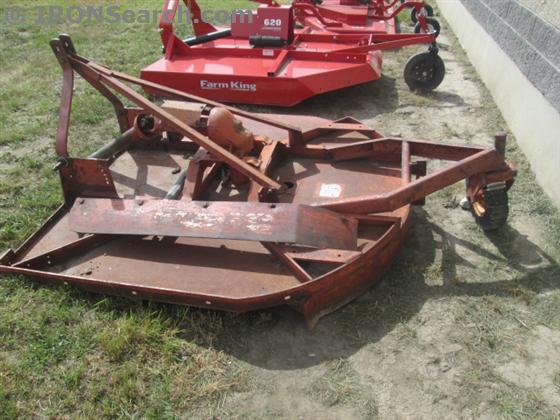

Sometimes certain people have nothing to do with it.
Alot of cutters used to be made rigid. That was the norm. My old bushhog 306 was that way. Looked similar to this one
And when on uneven terrain, like crossing a waterway, as the front of the tractor comes up, it tries to jam the tailwheel into the ground. No problem on the bushhog, because those diagonal braces were strong enough and the whole cutter simply floated up and raised the 3PH. Didnt leave a very even cut though, and a floating toplink would have made a more even cut.
But when those angle braces are just made out of 1/4" x 2" flat bar......they arent strong enough to stay straight, and buckle. They are designed to be in tension only. And dont hold up to lifting the whole cutter by just the tailwheel.
Operator error has nothing to do with it. A cheaply designed cutter has everything to do with it. And a simple floating toplink makes the cut a whole lot better, and puts a whole lot less stress on the cutter on uneven ground

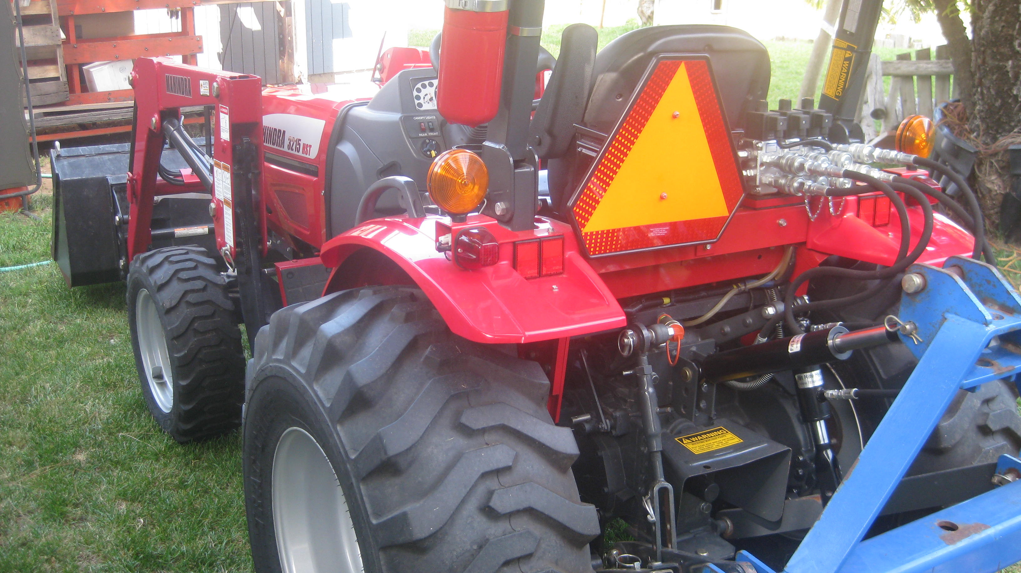

Sorry about no top link retainer, but with the type of retainer that you have, there just is nothing simple to get to work with what is there. Maybe my std retainer and a good rubber strap?
For more valves that you need, diverters, simple easy, clean. I should have some pictures here pretty soon of a set that one of my customers put on his 5065e.
That's what I did on my tractors to go from 1 to 4 and on the other to go from 3 to 5 sets.
