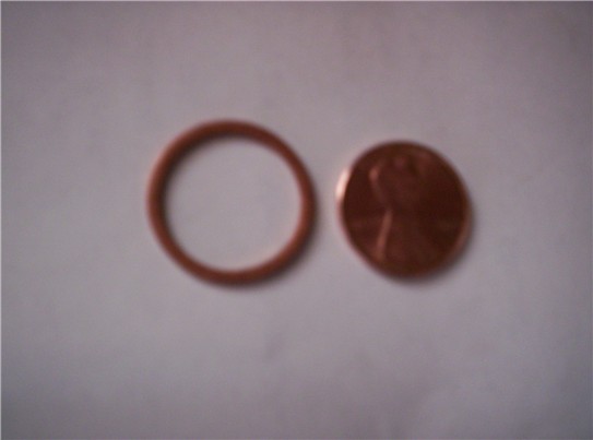

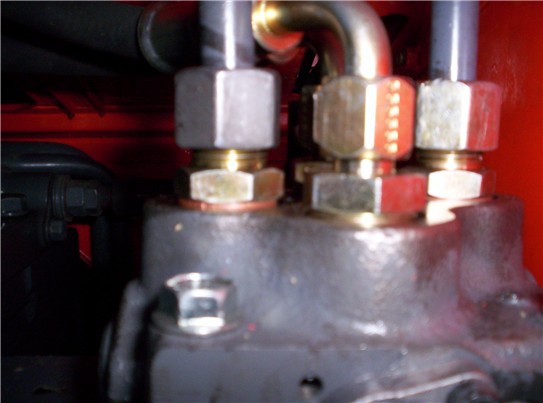

Anyone find a good source for those washers? I found some at NAPA but they are 9/16 ID. I have not taken the valve body apart yet to get and exact measurement of the male fitting. Can't find any 11/16. Otherwise if you have some Jon, I'll have to buy them from you for the valve kit I got from you last year. There is a one more store here locally that I am going to check when I find time.
thx
Jim
/ fittings leak #25
I found some copper washers at a Caterpillar shop. Their part number is 2A-1162. ID is .639" and OD is 1". They were tight on the fitting and almost too wide for the recess in the valve body. But they seem to work so far.
thx
Jim
