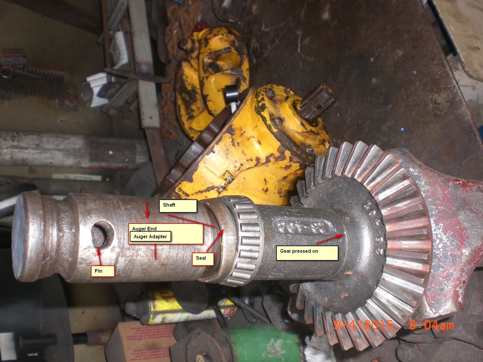

Was wondering if you could help me that I can not come up with? On the photo I am sending how do I get the adapter off the shaft ? Do you think it is pressed on [ no keyway] or could be it threaded right or left. I need a new seal and have to get adapter off. I think it is a five star post hole digger ?. I tried to get off with heat & 12 ton press & no go. Put in big vice and heated with torch tried to turn with big pipe wrench & no go.
Thanks
Jerry [ Wis.]
PS. Looking on Comp. at other diggers and a lot have same gear box but no adapter & not threaded just holes. Cant find break down for five star gear box.

*It looks like a Comer gearbox, but could be an Omni, not unique to Five Star. *Is there another pin higher up the bushing securing it to the shaft? **
The bushing is just that, just slid onto the output shaft and probably stuck with rust and dirt. More heat on the output shaft. Possibly drill a hole through the end if it is solid and get penetrating oil through that end.
*( Five Star is now Superior Companies, *Dewey, Oklahoma and they don't manufacture posthole diggers anymore)

No pin higher up. Could it maybe have a spline to hold it from slipping ? The photo of gear box is not like mine. Mine is more round on bottom. Going to give it more heat & drill hole think it could be rust.
Thanks for reply
Jerry Wis.

Now that I've given this some thought(I sold new 5 star diggers way back when) AND I COULD BE WRONG but I think adapter screwed on gearbox shaft.

You are correct I took it to a machine shop today and they tried everything and ended cutting off the adapter with lathe and found threads. Now have to make new adapter. Wish I had seen your reply before I went to machine shop. Thank you any way.
