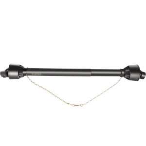

Yeah, that would work great except for the 1-1/8" input shaft on the gearbox.
I've found a $199 shaft that will work here:
PTO Drive Line, General Purpose, Post Hole Digger, 1-3/8
Supposedly this is equivalent to a Weasler 14 series. If the cross/bearings are compatible with Weasler 14 series parts, I could replace the implement yoke with this one:
14 Series Pin Yoke - Weasler Engineering, Inc.
Now I'm just waiting for ToolTuff to respond to my message regarding whether their shaft will work with Weasler parts.
   / Fixed length PTO Shaft?
#16
The other option is to use a PTO shaft with a 1-1/4" round shear pin yoke and use a sleeve bushing like this to fit it to the gearbox:
McMaster-Carr
The only issue here being the gearbox shaft has a 5/16" shear pin, and I haven't seen a pto shaft with that size yet.
The Weasler yoke mentioned in the post above has a 1/4" shear pin hole which I could ream up to 5/16" to match the shaft.

Yeah, I saw this one but it doesn't specify what the shear pin diameter is. Funny how some of these companies have no clue what information is required to match a PTO shaft to tractor/implement. Then you try to get a hold of them and wait, wait, wait.
#19
I decided to go with this ToolTuff PTO from Amazon, and will make up the difference in shaft size with a bronze sleeve bearing from McMasterCarr. I also ordered some sleeve bearings to make up the difference in the yoke (3/8") to input shaft (5/16") shear pin size.
I will just need to measure and get a couple grade 5 bolts/nuts to use as shear pins when all arrives.
#20
...and now she works like a charm. Watch out China, here I come!
