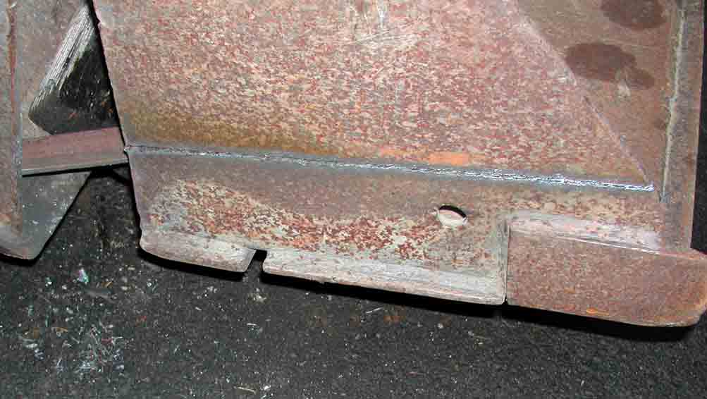

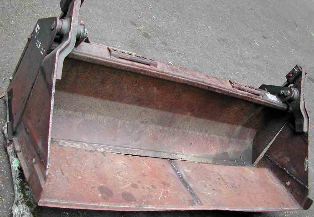

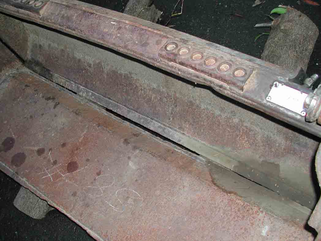

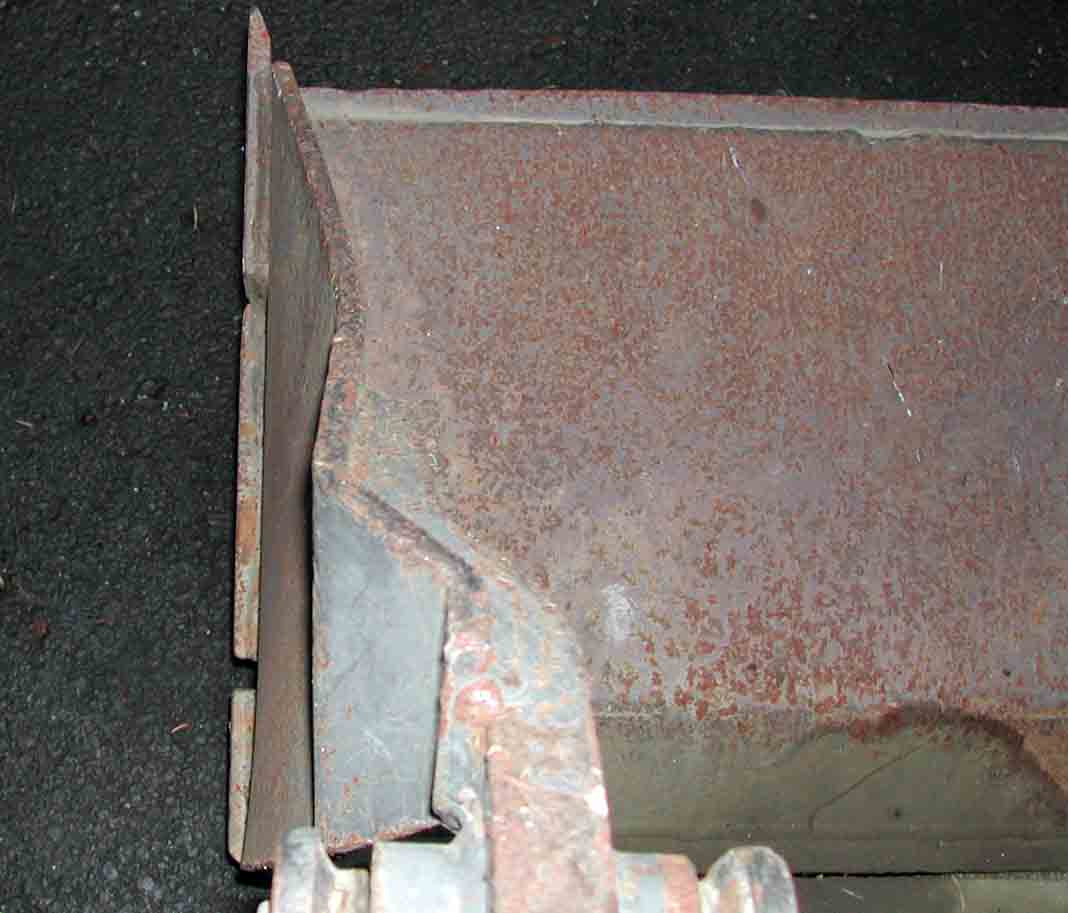

I found this 60-inch Bobcat QA 4-in-1 loader bucket, with a somewhat bent
upper jaw. The front cutting edge was slightly curved, too. Anyway, the seller
got about $50-60 for it, after draining the fluid and tossing the longer hoses. I
bought it for $200. It weighs just under 600#, which is 2x what my own 60-inch
light-duty WRLong 4-in-1 weighs. This is a fairly heavy-duty unit with 1/4" steel
sides.
I bought it as a challenge: I bet that I could straighten it, and I know someone
who will buy it, fixed.

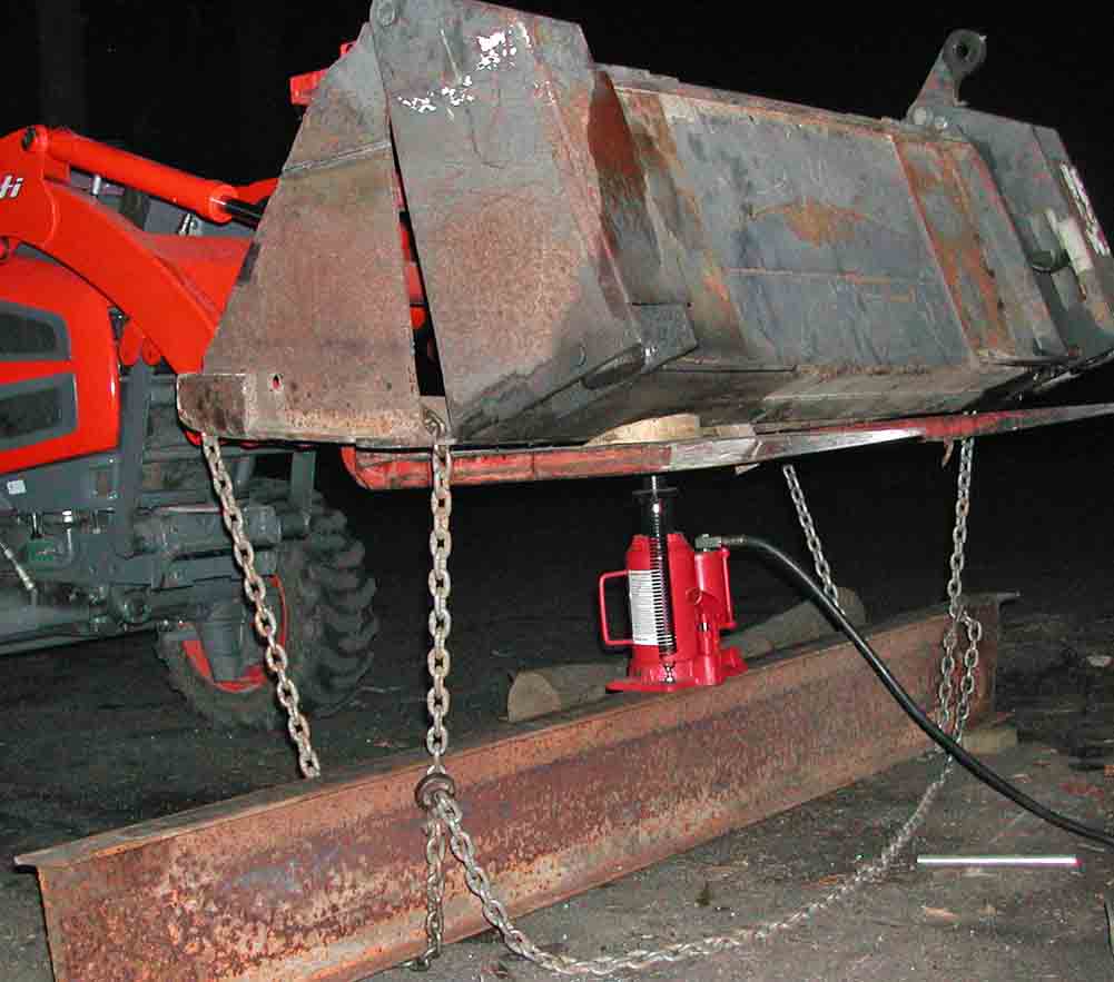

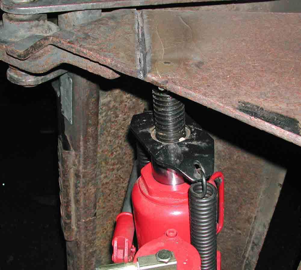

So this is how I fixed it:
First, I cut four trenches in the bucket where I wanted it to bend. I made these cuts with
my plasma cutter, following the yellow lines carefully drawn on the sides (photo 4 above).
On each side of the bucket, there are 2 cuts, one on each side of the plate, so that the slots will
open up as the bucket bends. The cuts go at least 3/4 of the way thru the 1/4" plate.

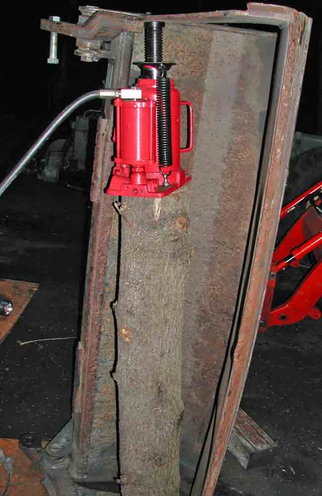

Then I positioned my 20T air-over-hydraulic jack as shown in the 2nd photo, and let 'r rip.
In the 3rd photo, I got the displacement I was aiming for. The slot has opened up quite a bit.
Even with the cuts, my jack was near its maximum capacity. I over-bent it a bit to allow
for spring-back.

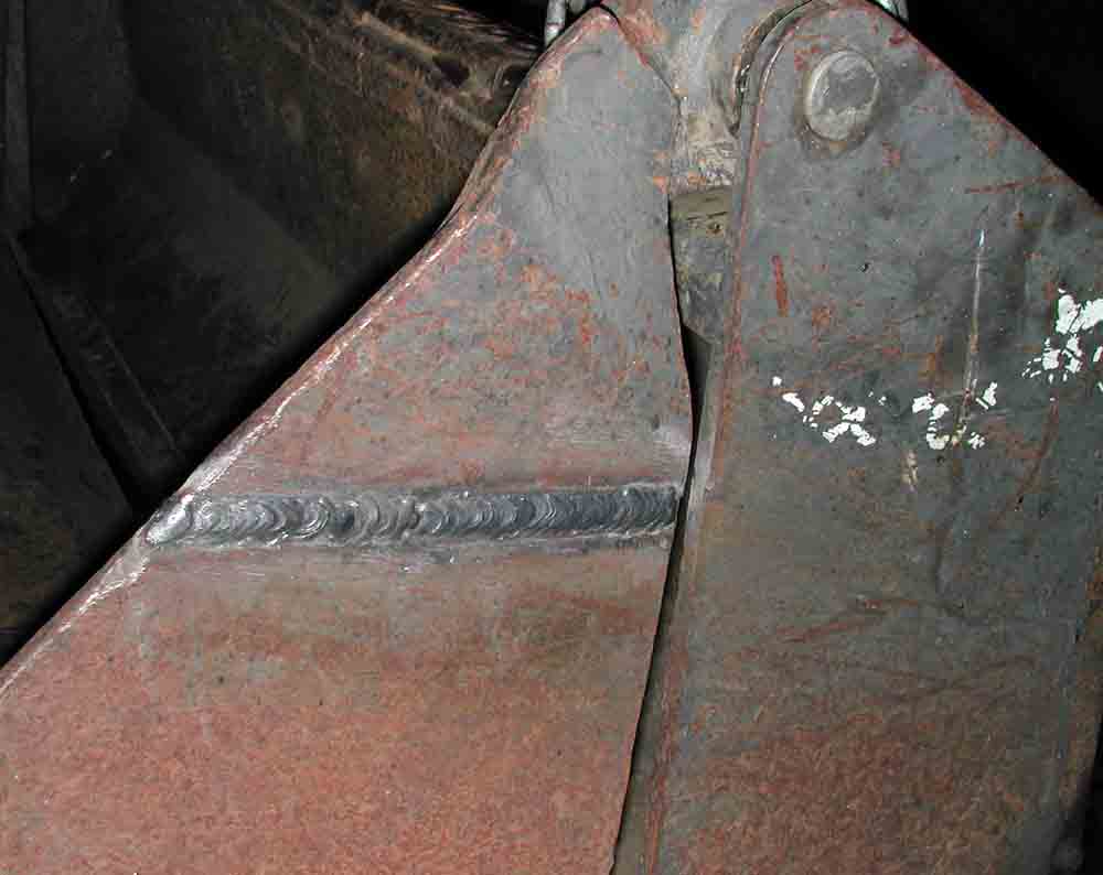

And here is the result.
The alignment is back....you can see the top and bottom jaws are now in the same plane.
I then welded each of the 4 slots, using a 7014 rod and my DC Miller Thunderbolt
stick welder. I did them all horizontally...I am not so good at OP welds. Tipping the
bucket on end was the harder part.
But, I am not done yet. The upper jaw cutting edge and carcass needs some straightening.
That's next.
