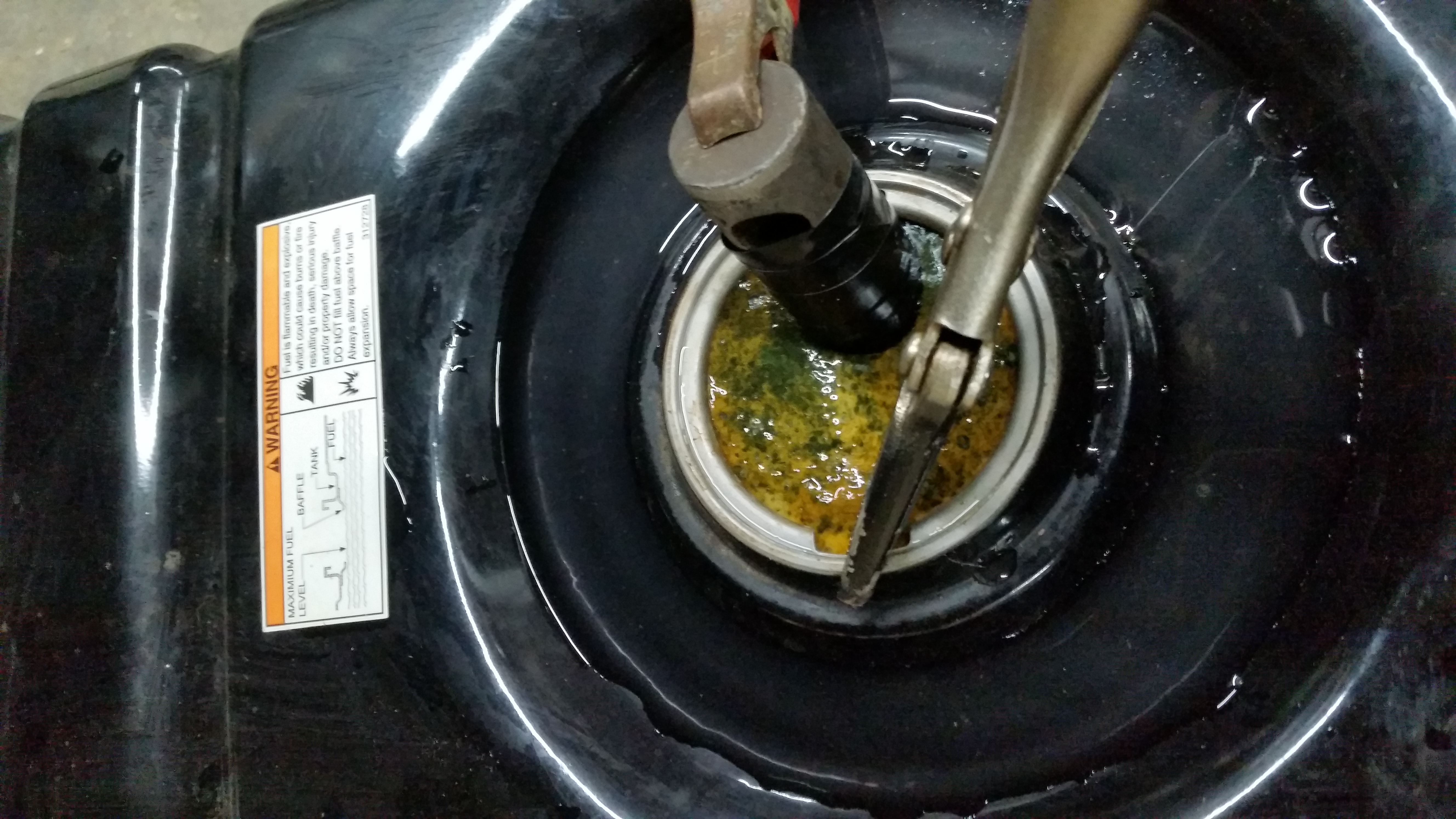

I used pool PH plus and a battery charger recently to clean out a rusty generator tank. Took 24hrs but no costic acids that can rust every thing else in my garage. It also only removes the rust, not the metal.
I have found that useing a chain with a string attached makes cleaning gas tanks real easy. Just pull the string out when done. No messing around with gravel or nuts and bolts.
