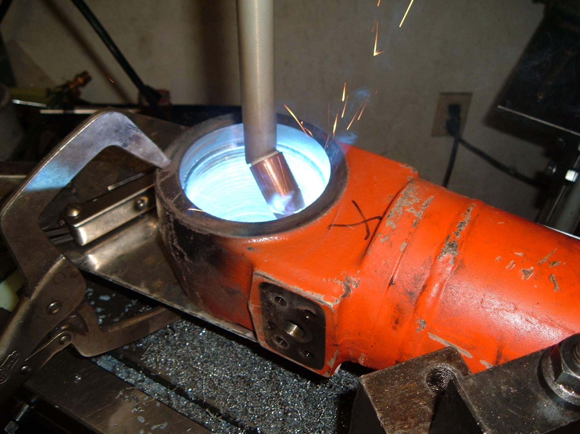

I was thinking of welding in a bushing of some sort. What can be done. pics would be nice. thanks
Here's what I do.....Weld it, bore it, done......:)
   / fixing elongated holes in farm equipment?? #15
Whoa! Is that a bore welder for the home shop? We've got a bigger version or two here at work but a home version? Where have I been? COOL!:thumbsup:
We have a couple of those at work too. Ours are BoreTek (sp?) brand. Been using them for about 25 years now. Pretty slick. We've welded bores from probably 1ス" through about 36". I don't remember what the cost of them is but don't think one would have one at home!
Kim
