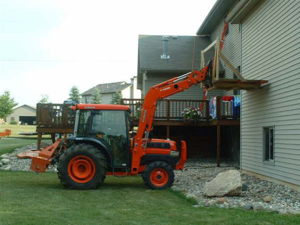

Here is the good part: I got to use the tractor! Our home is a 2 story so to start our project we used ladders to reach the high areas. It became was a hassle to scrub the siding while standing on a ladder. Up and down a zillion times. So I built a platform that we could stand on then would be lifted up using the tractor and forks. Here is a picture of the platform.

My wife and I have been working on this as a team and it seems to be going pretty fast. While I was at work one nice sunny day; my wife decided to go out and do some more work on the siding and enlist the help of one of our teenage daughters. My wife got the tractor out and raised the platform up as high as it would go. She then climbed the ladder up to the platform. Then my daughter climbed up to help. When she stepped off the top rung she accidentally pushed the ladder away and it fell over on the ground. They realized that they had no way down and no one was at home. They began laughing at how crazy this must look. Luckily my wife had her cell phone and started calling neighbors until she found one that was home and could come to the rescue. No one was hurt and a small lesson on safety was learned. We have also had alot of laughs telling friends and relatives what happened.
Who would have thought that cleaning siding provide this much entertainment value?
