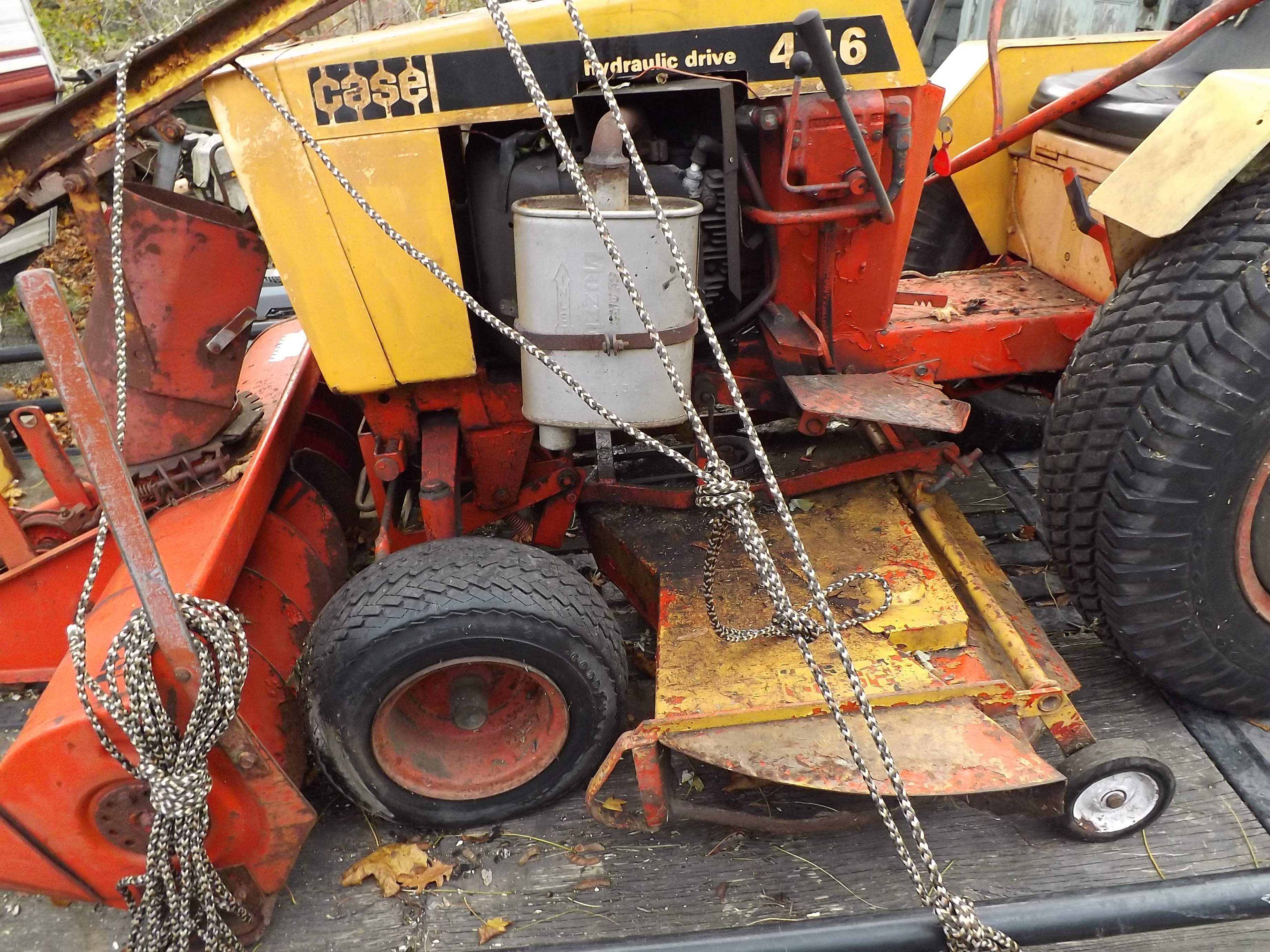

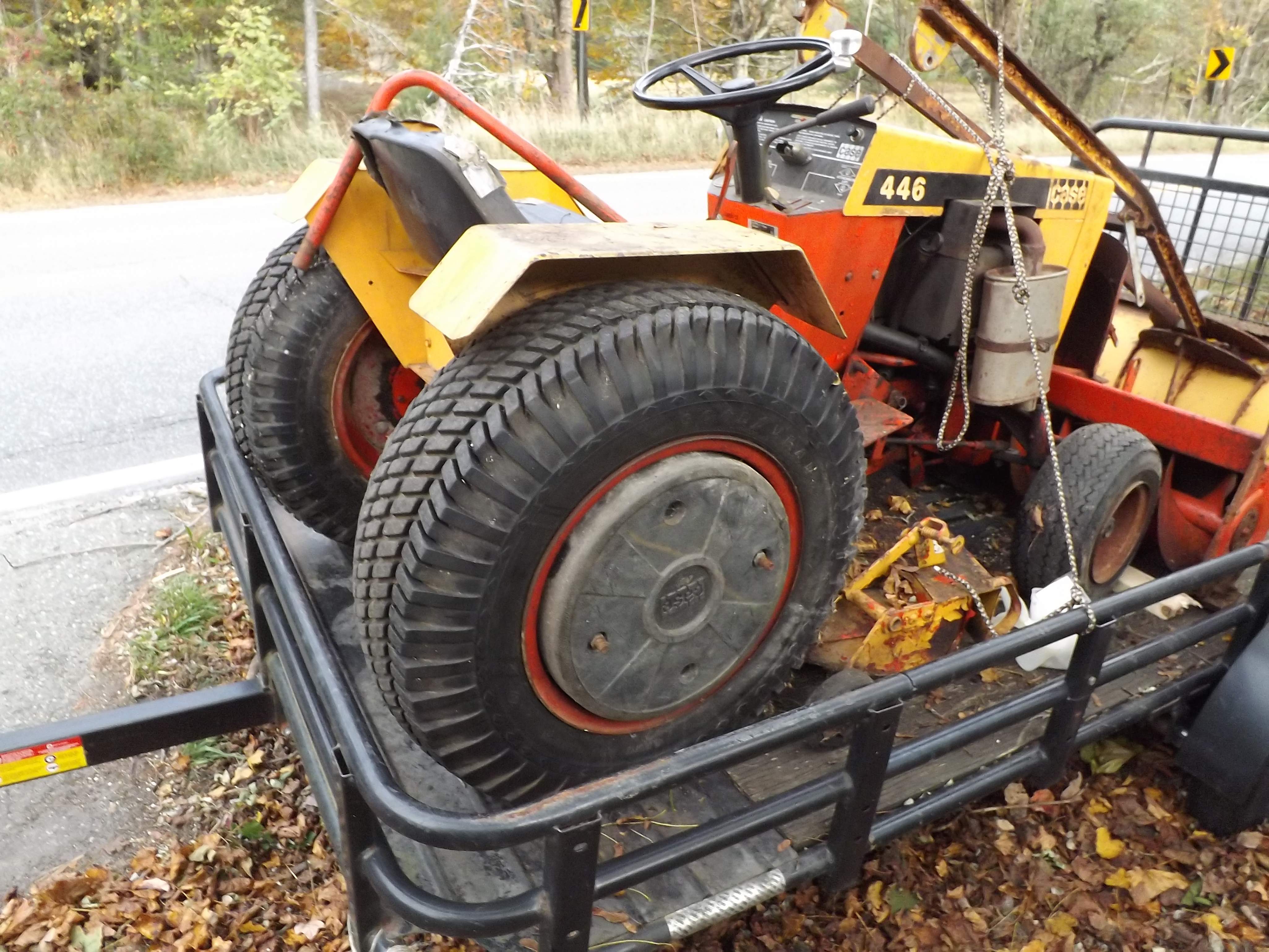

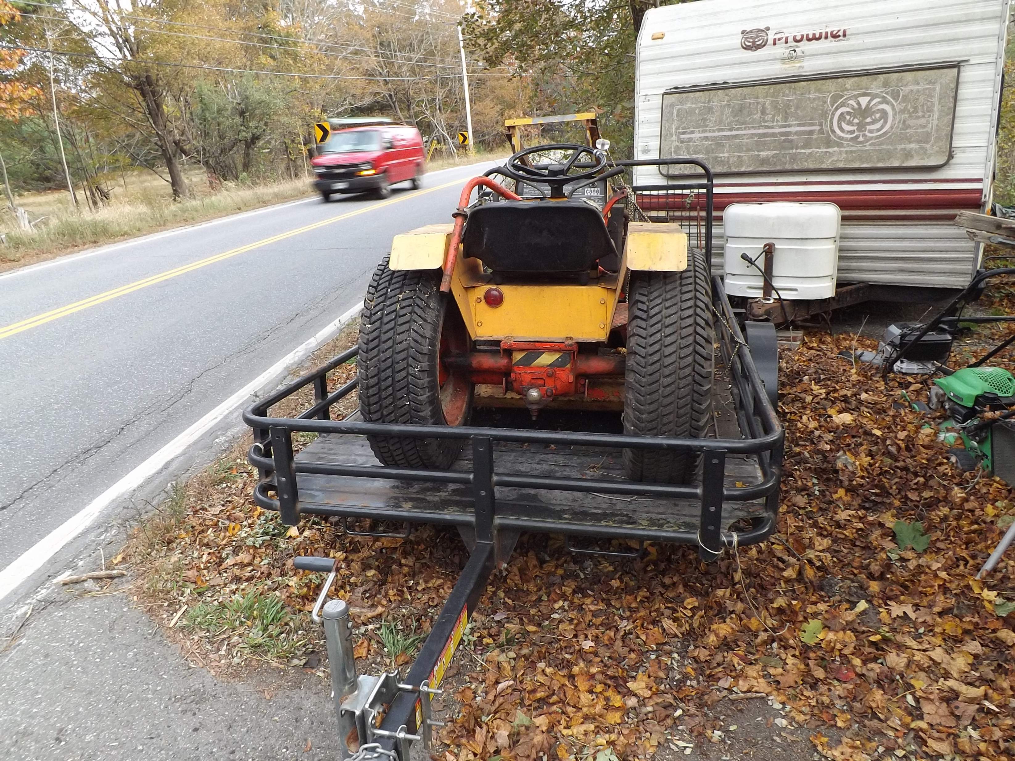

Well, I got the Case 446 dug out, loaded onto a trailer, and brought it home...

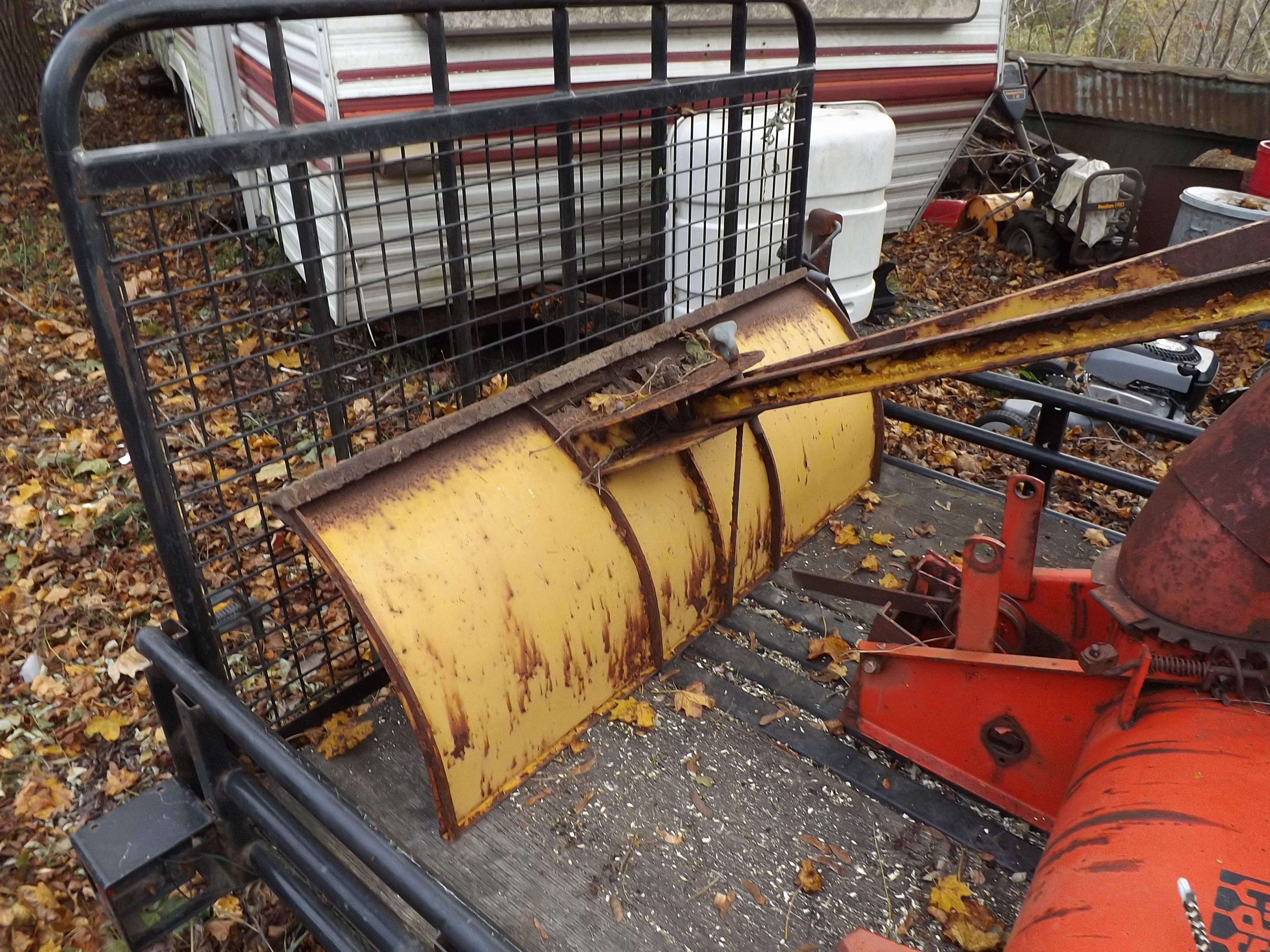

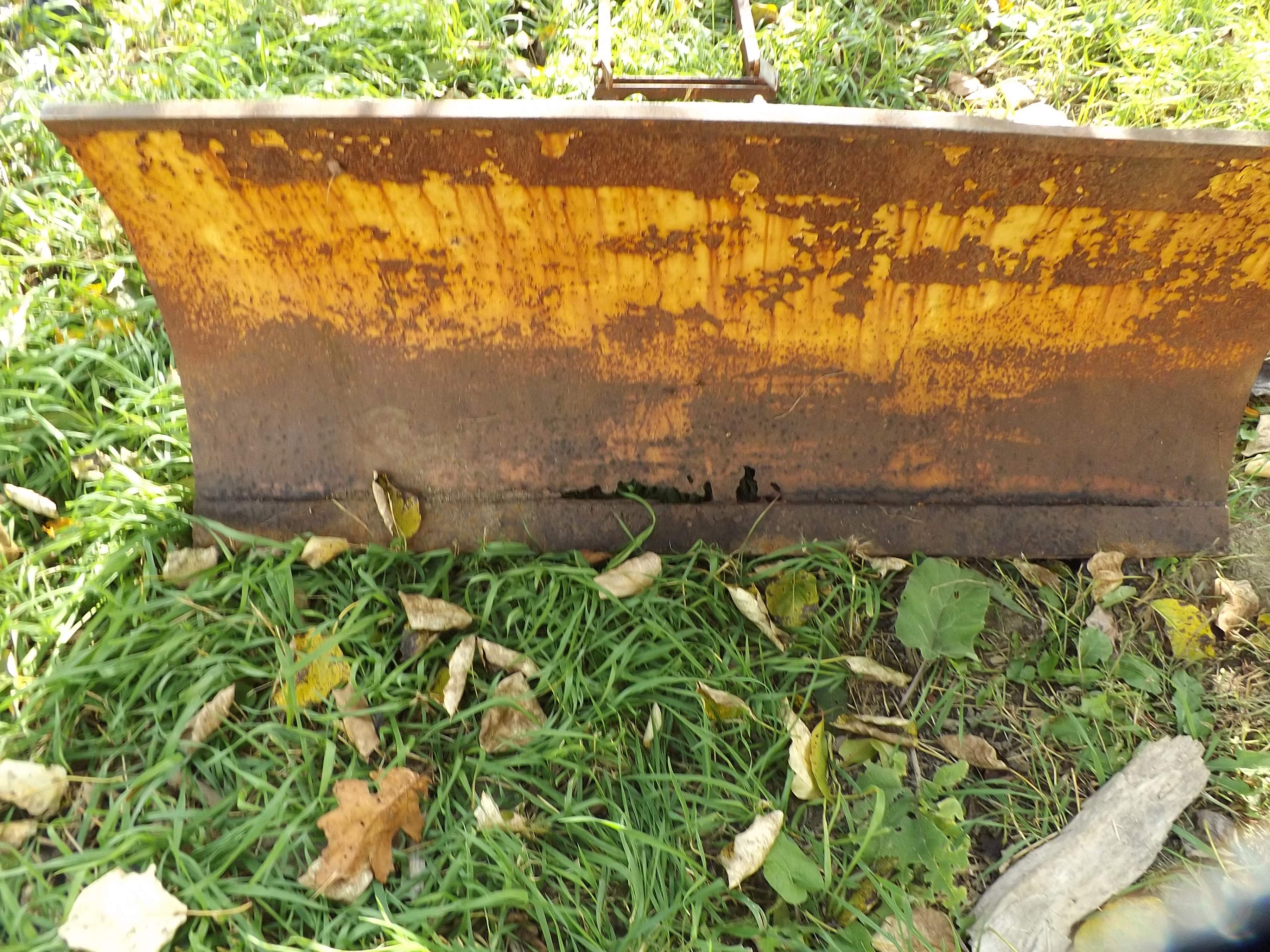

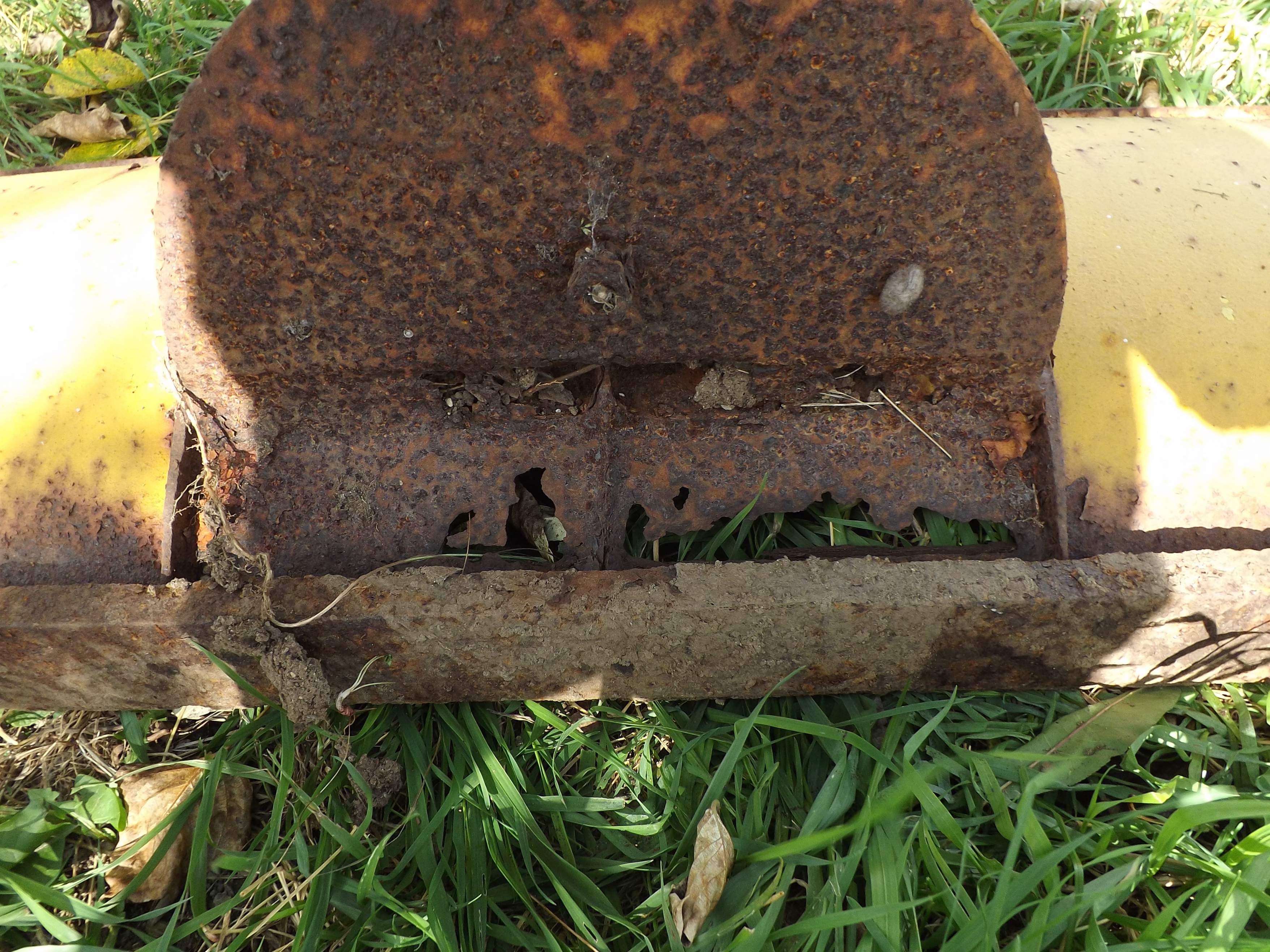

It isn't pretty... The Snow plow is rusted out at the bottom center.

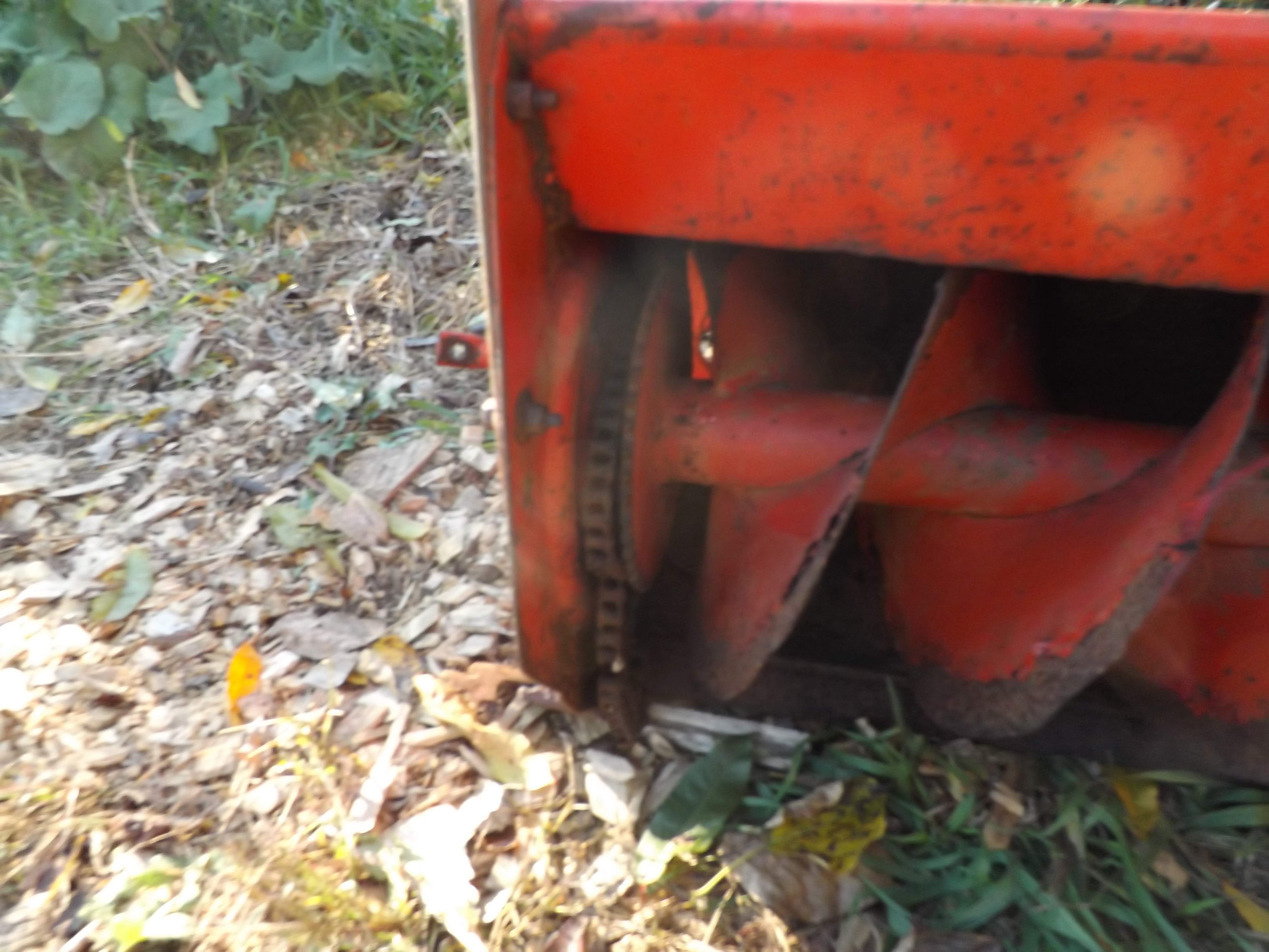

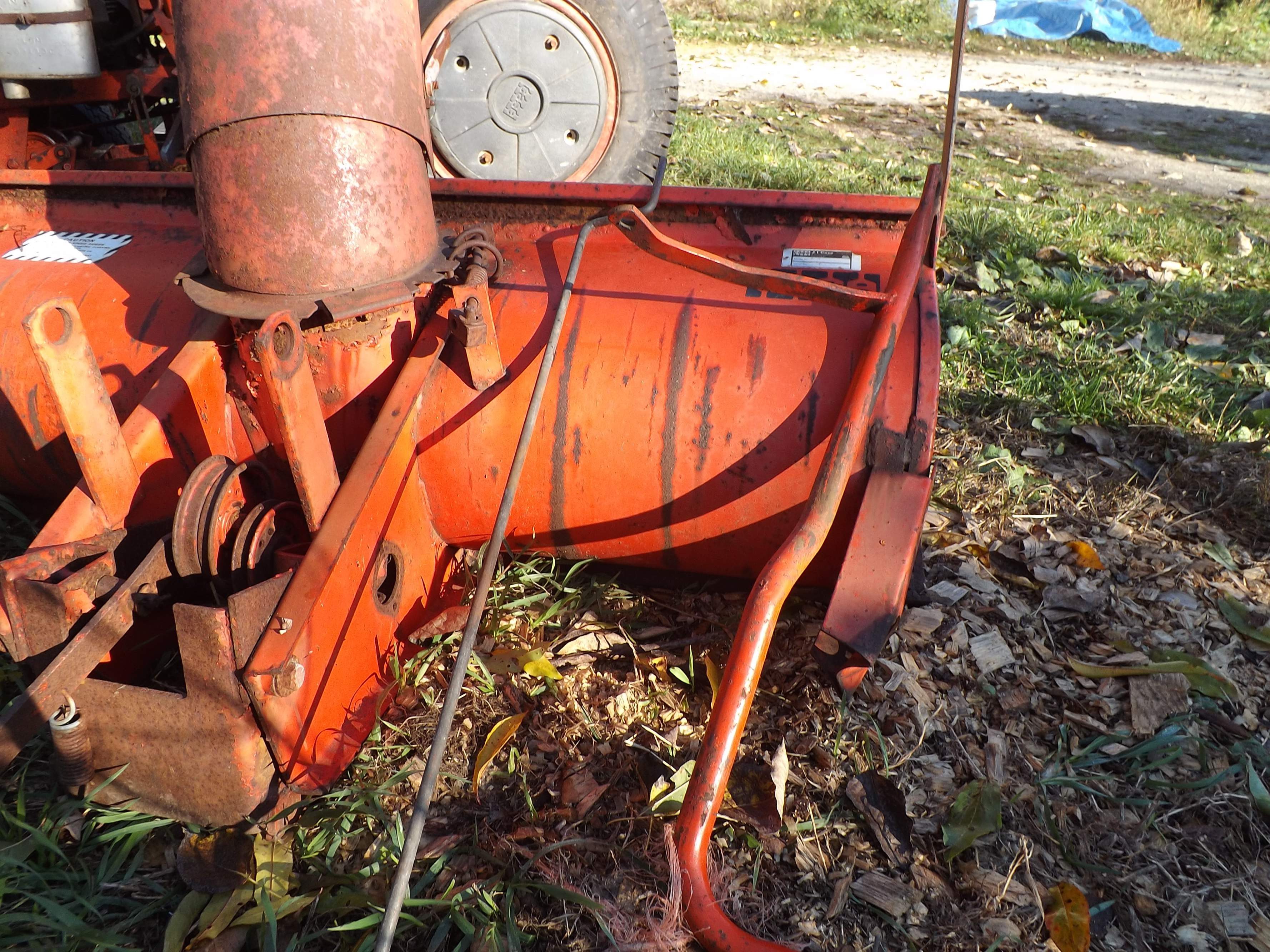

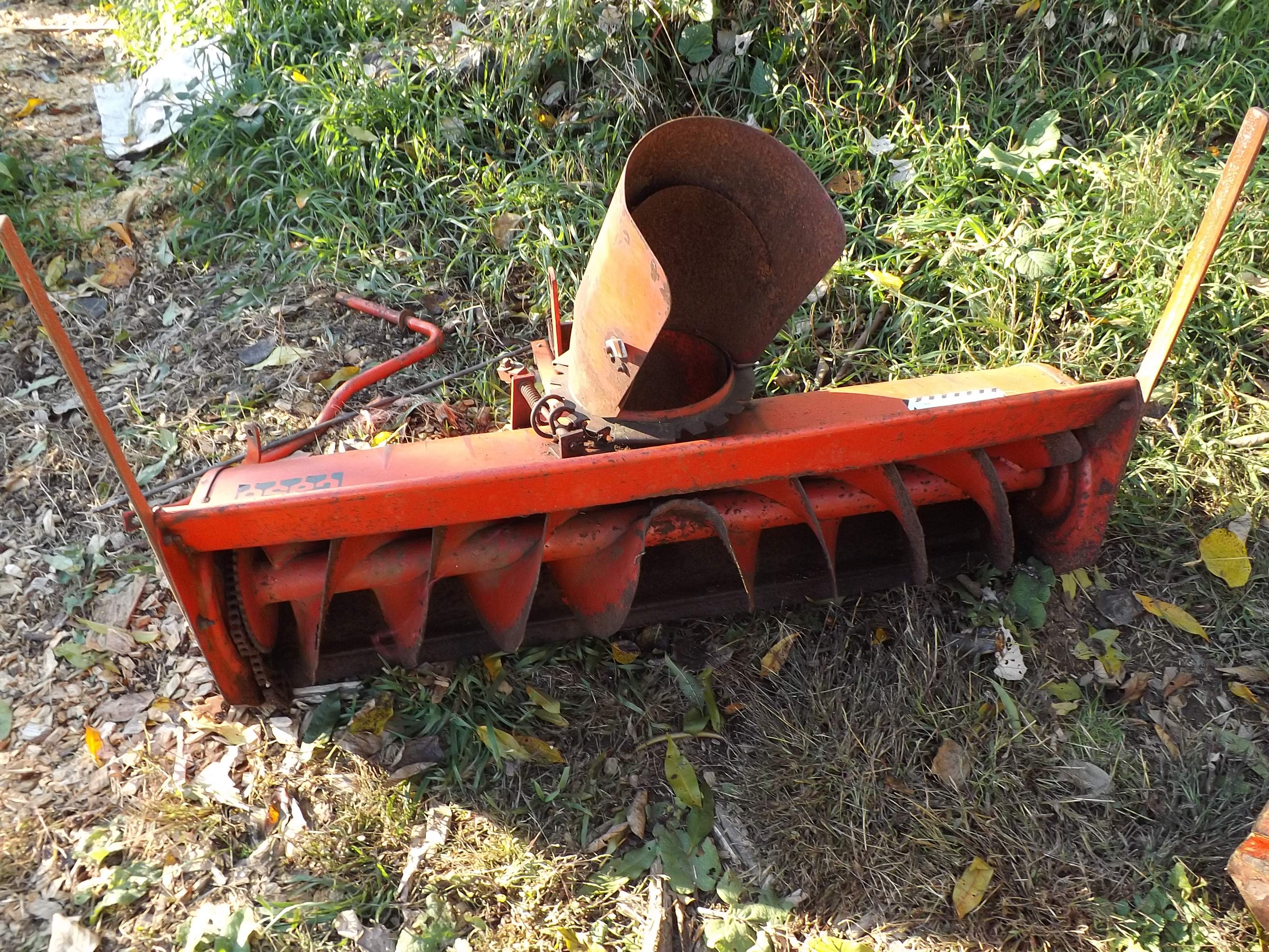

The Snowblower is missing a shaft that goes from the belt drive pulley
in the center to the chain drive on the side that runs the horizontal auger.
The Auger won't turn... I knew it needed new bearings though.
It has some Frankenstein exhaust setup, that needs cutouts for the hood.

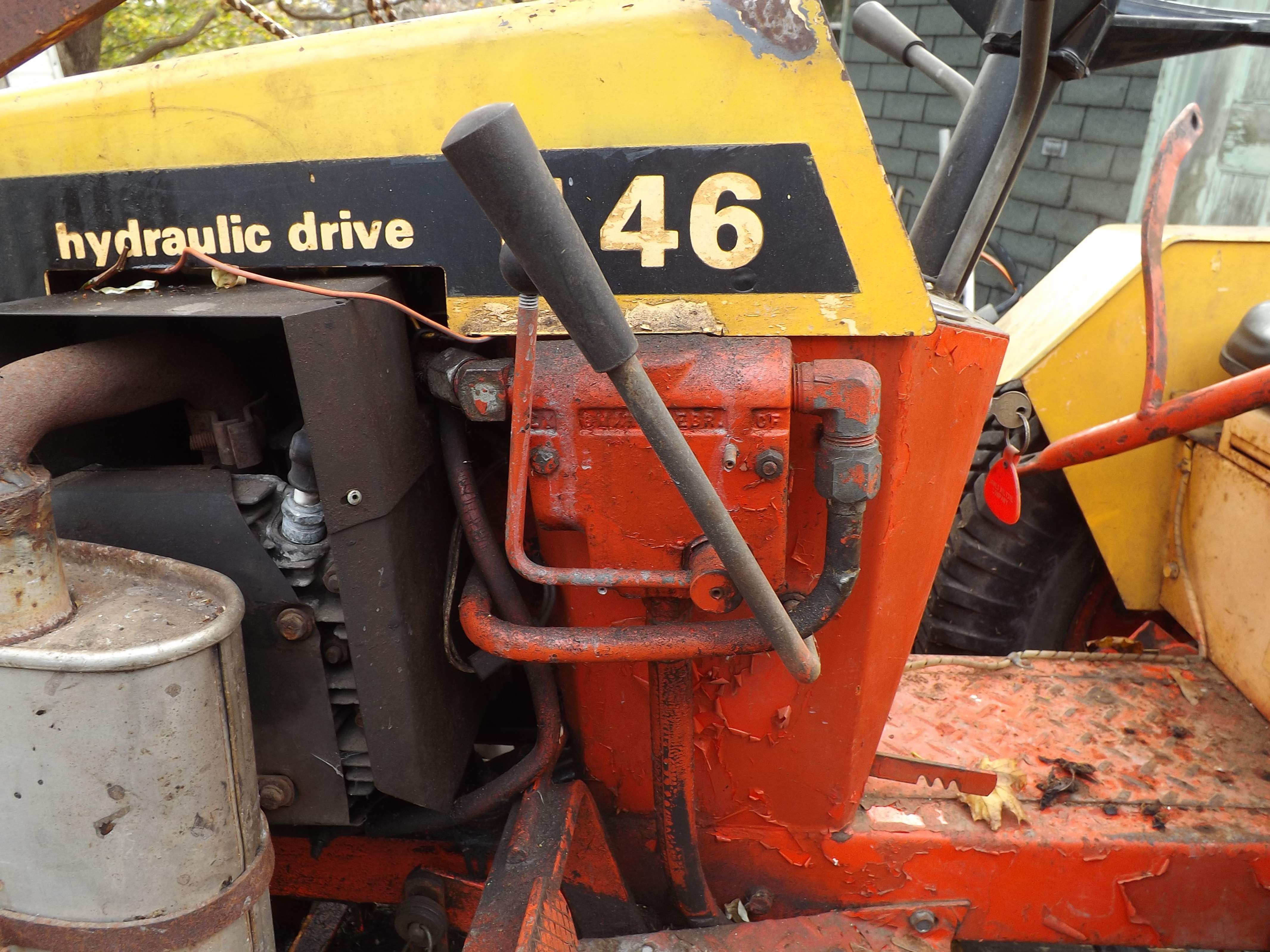

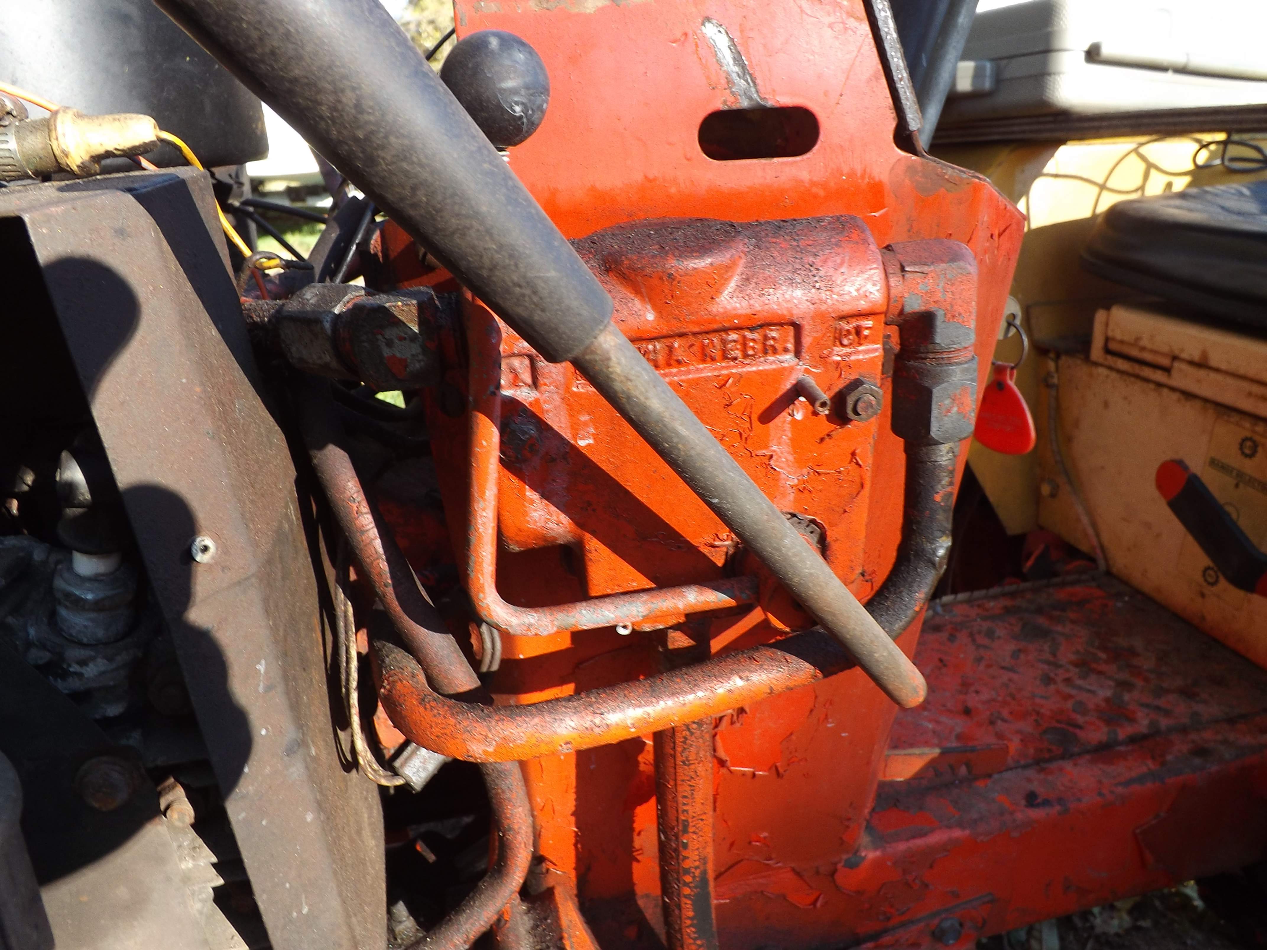

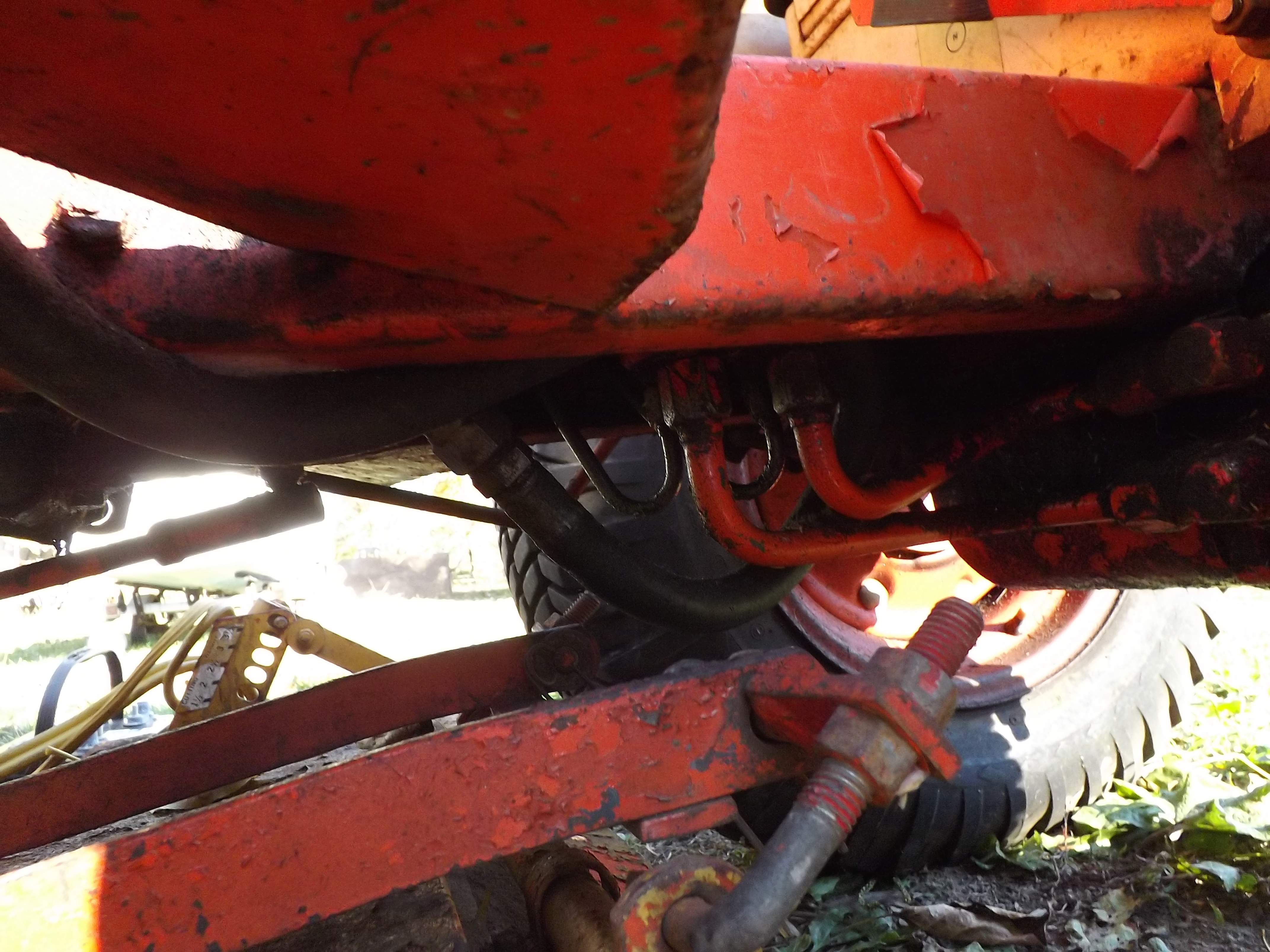

I included a picture of the hydraulic valve on the left of the dash; I still think
it's the valve that is normally on the rear of the tractor. I don't know what else
to make of it. There's just a ball hitch on the rear of the tractor.
Someone splashed yellow paint on the hood, fenders and mowing deck; I
would have preferred flames myself :)

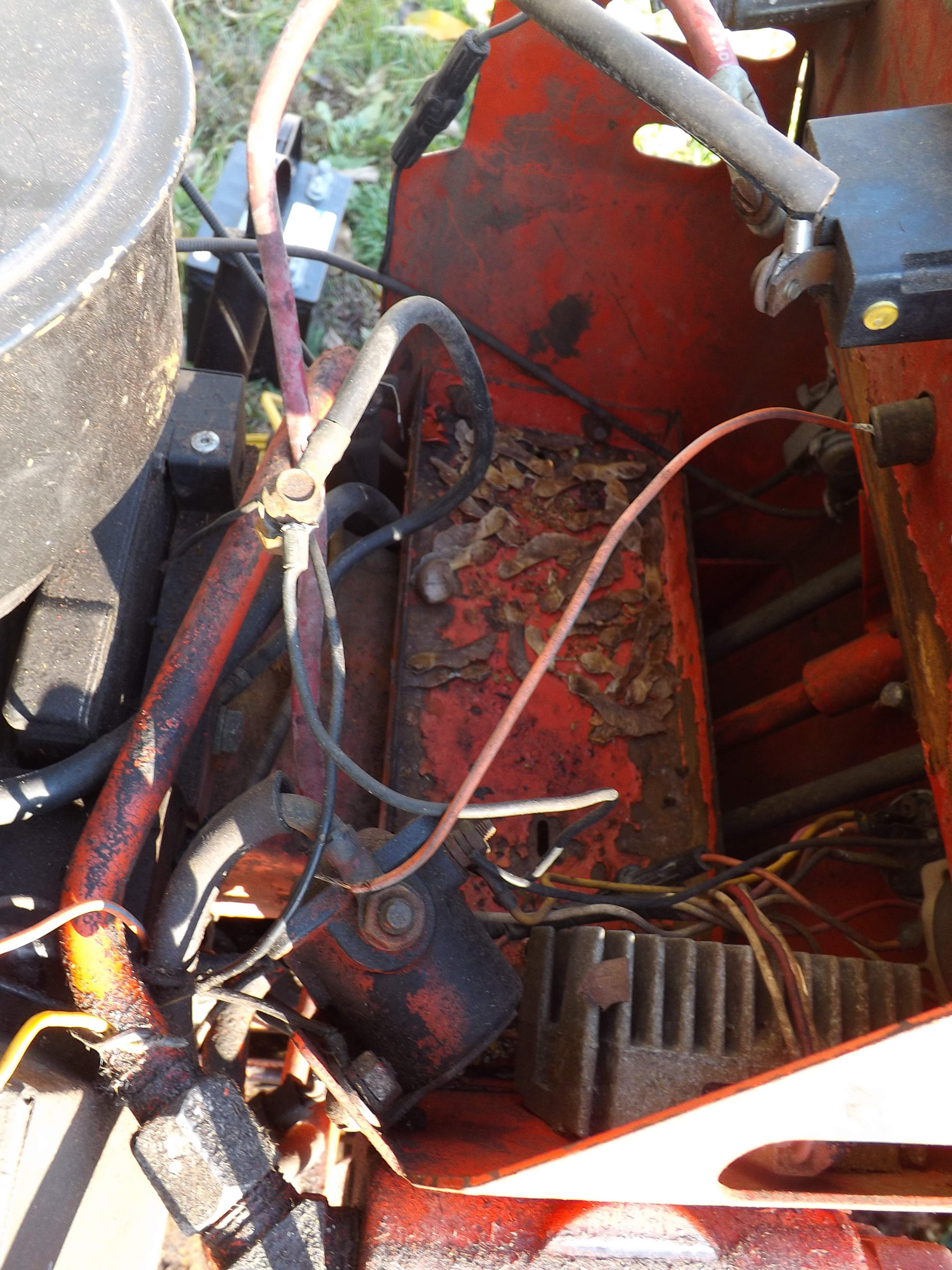

The starter is quite noisy though. I couldn't even find the
starter under all the tin. I couldn't find how to remove the
tin very easily. I think there's some triangular pieces added
to the top of the cylinder around the exhaust and spark plug
holes; a bit of a mess. There's a weird thing on top of the
cylinder tin like a fuse holder. I'll get a picture tomorrow
when it's light. There's also something that looks like a
heavy heat sink behind the dashboard on the left side, near
the starter relay.
It isn't pretty...
Perhaps to you it isn't pretty but to me, it's beautiful. First off, all of the tin looks to be in nice shape. The fenders are not all bent from the improper use of tire chains. None of the tin seems to be butchered in any way which will make the restoration fairly easy. The only oddball item is the switch on the right side of the dashboard but that is easily filled in with a welder and ground flat. The new dash decal will cover minor scars.

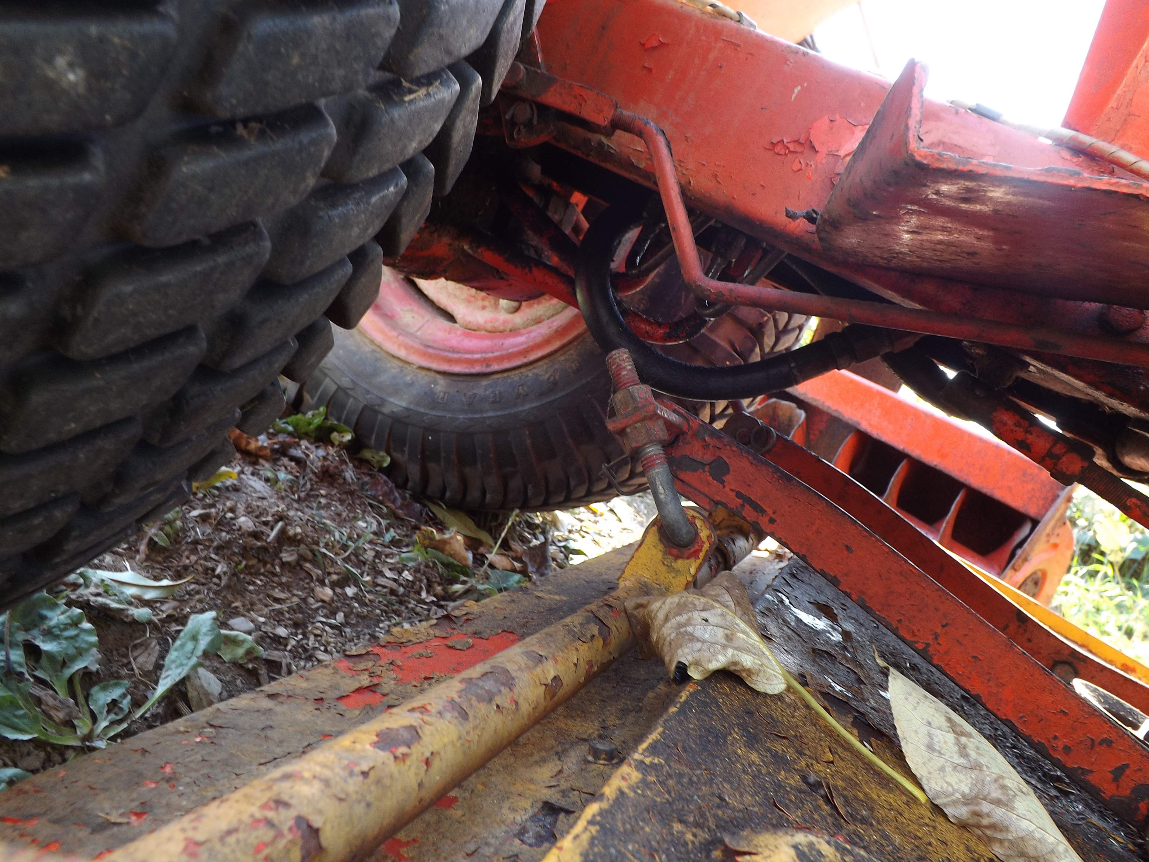

The Utility Blade is a mystery to me. I have never seen an early-style blade that uses channel iron for the yoke. All of the early-style blades used heavy-wall pipe. I don't know if that blade is worth the effort to repair. For sure, it is possible to patch the rotted section with some 1/8" steel sheet welded over the damaged area but such a patch does not aid in getting snow or dirt to flow over the blade when it is angled.
The snowcaster seems to be missing the chute crank handle, as well. The missing shaft and sprocket are not a big deal but the missing pulley is because it is rather expensive. Rarely do I ever see a snowcaster being parted out on e-Bay. Whether you can find a low cost substitute pulley at a local supplier is hard to say. We can get into that later. I think that the snowcaster is a Model H, which is the first one that uses the Snap Fast system which Case introduced in 1971.
You have no idea just how lucky you are. The exhaust system is not only perfectly correct for this year of tractor but it is in excellent shape. Those mufflers and pipes have been obsolete for about ten or more years. The last time they were available, the cost was more than $200.00 per side. Case used that cut-out hood and muffler system from 1972 until early 1976.
to make of it.
Once again, you have introduced a mystery to me. The valve on the left side of the dash tower is called a Flow Control Valve kit. Once again, I have never, ever, ever seen this valve installed on any Colt, Case or Ingersoll tractor unless the rear PTO valve was also installed. How that happened boggles my mind because the Parts Manuals always show the steel hydraulic lines which connect the two valves together. A Flow Control Valve or FCV gives the operator finite control over the forward motion of the tractor at very low speeds. It is an option which is recommended by Case whenever a Buyer wishes to add a rototiller to the tractor package but you cannot power the tiller unless the optional rear PTO kit is also added. It does come in handy when blowing snow and perhaps that was the reason for it being there. I am curious as to whether this valve is connected to steel lines or whether one or more hoses were used.

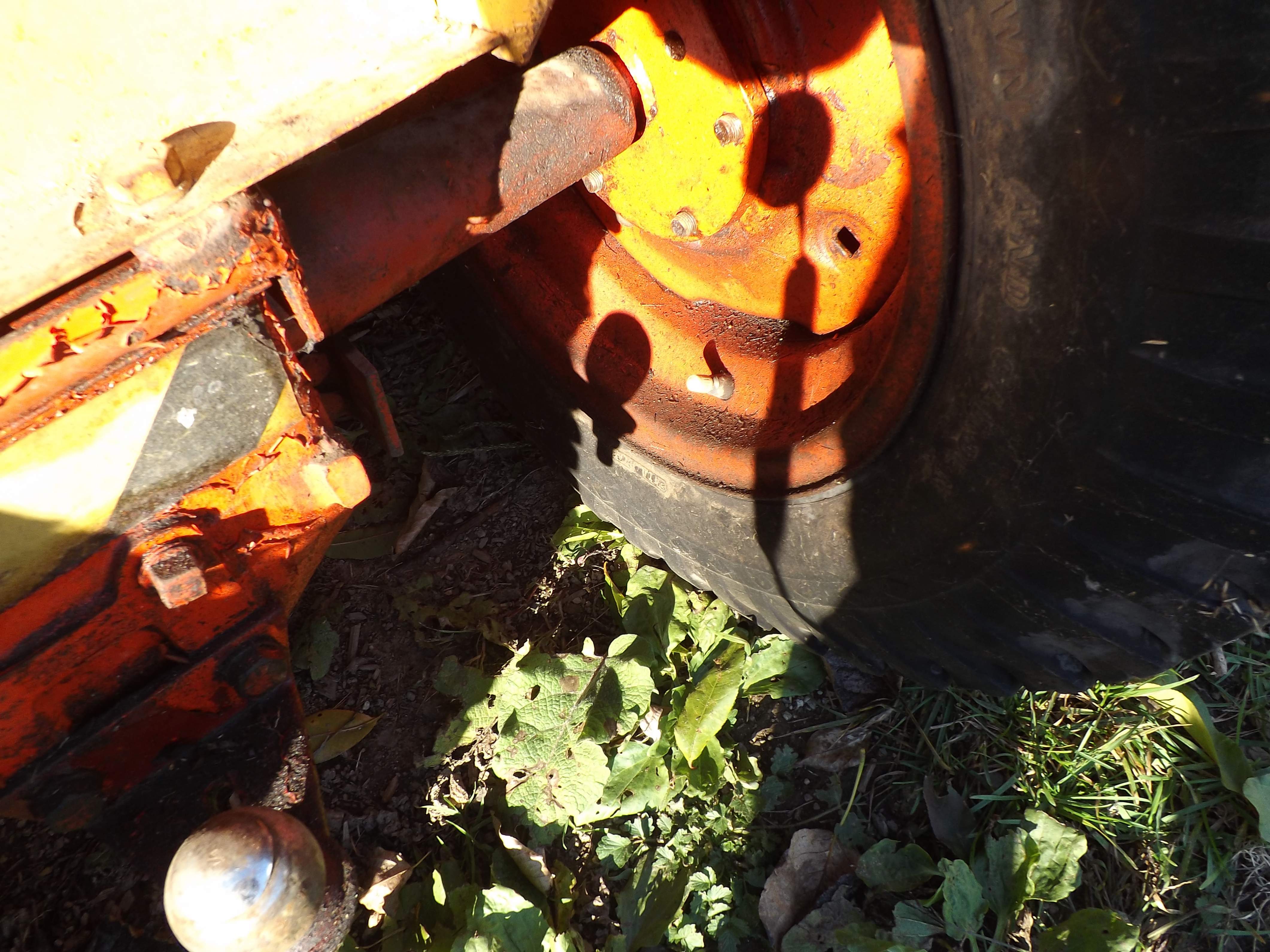

It is very common for owners to put a trailer ball there.
Essentially, the paint scheme on this tractor is correct. Originally, the hood, fenders, seat pedestal, fuel tank and seat shell were all painted Desert Sunset. Pretty much everything else was painted Power Red, including the mower deck, utility blade, snowcaster and rims. Only the grille area and the engine were painted black. However, you are correct that someone has splashed what seems to be Federal Yellow on certain areas. This colour was used on the 600 Series loader tractors and it is a common mistake made by owners when they go to the Case dealer to buy paint.
The rear tires seem to have Calcium Chloride in them, in addition to the
wheel weights, I can hear it rattling around in the tires.
IF.... the tires are loaded with CC and no tubes were used, then that is a bad thing. CC will destroy the rims if allowed to come in contact with it. Look at the valve stems to see if tubes are used. Hopefully, the tires were loaded with windshield washer antifreeze, which is not corrosive.
Is it likely that it's not a Case implement? The most use
I'd have with this is grading my mostly sand driveway, and
maybe flattening some piles of dirt and anthills.
Not high on my list, but I'll probably get it welded up sometime.
What's the difference between a snowblower and a snowcaster and
other similar terms?
I have a orange pipe handle, and a wire rod handle as seen in the
pictures showing the missing shaft. The end support is bent up a
little too. The auger needs to come off, and have it's bearings replaced.
I feel so lucky :)
I'm glad to know it's not some cobbled together arrangement.
I was wondering when I took a close look at it, it looked factory.
When I do need to replace this, what can I replace it with?
Well, I was told it was to direct the hydraulics to the front of the rear.
But I believe you are correct, especially since there aren't any hydraulic
fittings on the front of the back. It was probably added for snowblowing.
I've added a bunch of pictures of the piping going to the valve. it all looks
stock to me. I also ran across something on ebay called a holding valve
for a Case 446. What's that about?
I was told there were no tubes in the tires, but the valve stems look
like tube stems. Tubeless valve stems bulge out before going into
the rim; these don't.
The mower deck is an H-Series which is the very first
Snap Fast style of deck offered by Case. Therefore, it is correct
for this year of tractor. When you flip it over, there should be a
hard rubber roller at the rear of the deck in the middle. Quite
often, the brackets that support that roller wear through, thus
releasing the roller when the deck is raised off the ground and
the roller is lost forever.
There is no sign of there ever being a roller in the middle of the
back of the deck. There are wheels on the back two corners.
I did find a Operators Manual on the Internet, with a wiring diagram.
I've got to figure out why I don't have any spark. Where can I buy a
coil/distributor if I need one? I don't know if I can upload the manual
to this website...
Thanks again, Jim.
I tend to agree that this blade was altered to make it work on the Case. For your purposes, patching it would be fine. This is actually a stronger blade than the later Snap Fast blade because it connects to the brackets welded to the tractor's frame, just in front of the rear axle. Therefore, you are pushing from the rear axle instead of from the front of the tractor.
Snowcaster is the term Case uses for their unit because it is a single stage model that tosses the snow via the paddles in the center of the auger. Snow blowers have a separate fan behind the auger to toss the snow up the chute. Those are 2 stage models. I now see that you do have the chute crank. That's the item you refer to as "wire", The piece of pipe is what raises and lowers the snowcaster.
The new photos indicate that the exhaust is not factory but is a close replica to what was there. I'd sure like to know where they found those mufflers. When you need to replace the exhaust, you are going to have to search for some appropriate mufflers for it and make your own system.
The actual valve is Case OEM but I can now see that someone has welded one of the steel lines together and also, at least one hose has been used. The Holding Valve kit was originally an add-on to solve a problem for people who own hilly property. Owners with flat property do not need this valve. In late 1985, Ingersoll began incorporating the holding valve feature with the travel/control valve. You do not have a holding valve kit on your tractor.
It does not surprise me that the roller is missing. The roller is there as an anti-scalp device. It was replaced by a wide, flat steel plate on the J-Series deck which superseded the H-Series deck you have. The wheels at the rear corners of the deck are called gauge wheels and they support the rear of the deck when you are cutting grass. The wheels move up and down by way of the deck height adjuster and this sets the cutting point of the grass.
to this website...
Thanks again, Jim.
Operator and Parts Manuals are specific to the serial (PIN) number of the tractor. Over the years, many changes were made to these tractors. The 446 began in 1972 and ended in 1988. If you do not have the correct manuals, then you will not be accessing the proper information.
First, you need to diagnose what is wrong. Buying parts in the hopes of fixing the problem is not the way to go. A coil alone is about $80.00 or so. What if you buy one and find out that your coil is OK. No one takes back electrical parts. You buy it....you own it.
Here is how to test the coil. Disconnect the wires going to both terminals. Clean and re-gap your spark plugs. Check the two ignition wires and the holes they go into at the coil for corrosion or damage. Bad ignition wires can mean no spark. Connect a jumper lead from the battery + to the coil +. Then take another jumper and connect the battery - post to a clean spot on the engine where it will have a good ground. Take a third jumper and connect it to the coil's - terminal. With a spark plug connected to one high-tension lead and solidly grounded to the engine, touch the other end of the third jumper wire to the battery - terminal momentarily. Touch and remove, touch and remove. If the coil is OK, then you should see a spark jump the plug gap.
If you get spark, then you just use a multi-meter set to the DC scale and check for 12 volts at the end of the wire that comes from the ignition switch and previously went to the coil's + terminal before you disconnected it. Of course, the key must be turned to the ON position and also to the START position to make sure you are still getting voltage as the starter is spinning the engine over.
If you have voltage there, then the next step is to check the points. This is why you need the manuals. They show you where the points are and they tell you what the gap should be. Of course, you can just follow the wire that you removed from the coil's - terminal. Check that wire for damage. If it is broken or the insulation is cut into, it could be shorting out all the time and that will prevent spark from happening.
