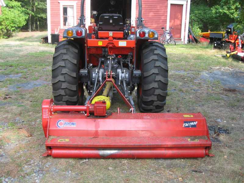

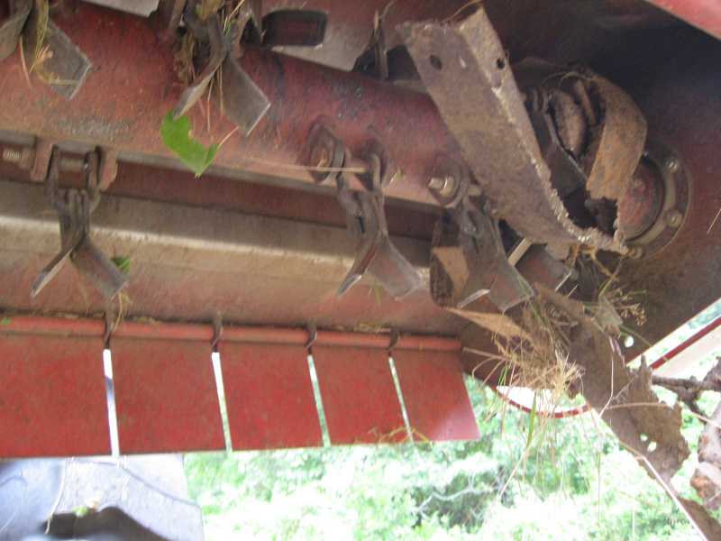

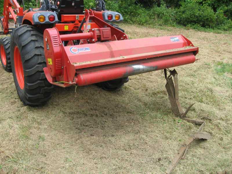

I have a Caroni TM1900 (75 inch cut) and love it. Tough as a bush hog and cuts just about like a finish mower. I got it from AgriSupply just as TractorLegend noted.
I have run over tires, wheels, angle iron (in photo), rocks, and assorted abandoned and decayed farm equipment. No problem. I only needed to stop once to untangle the angle iron and that was just a matter of a minute or so.

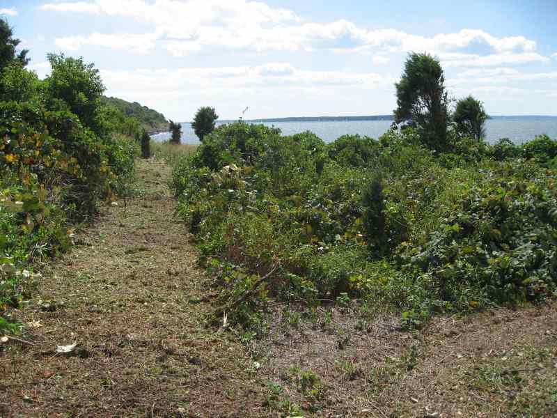

in that thicker scrub that Island Tractor has placed a pic of would you normally back the flail mower or must it be driven forward over it ?? and up to what diameter trees / scrub will it handle?? cheers
   / Flail Mower for DK35 #8
In thick stuff I usually do back in but not always. I don't have any trouble backing into 2 inch bushes. I slow down and let the sound of the mower beating on the bush guide me to how fast to back in. Here are a series of photos showing a stand of bushes then the remains of the first bush which had several approximately 1.5-2 inch stems.

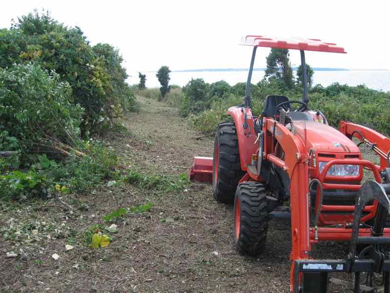

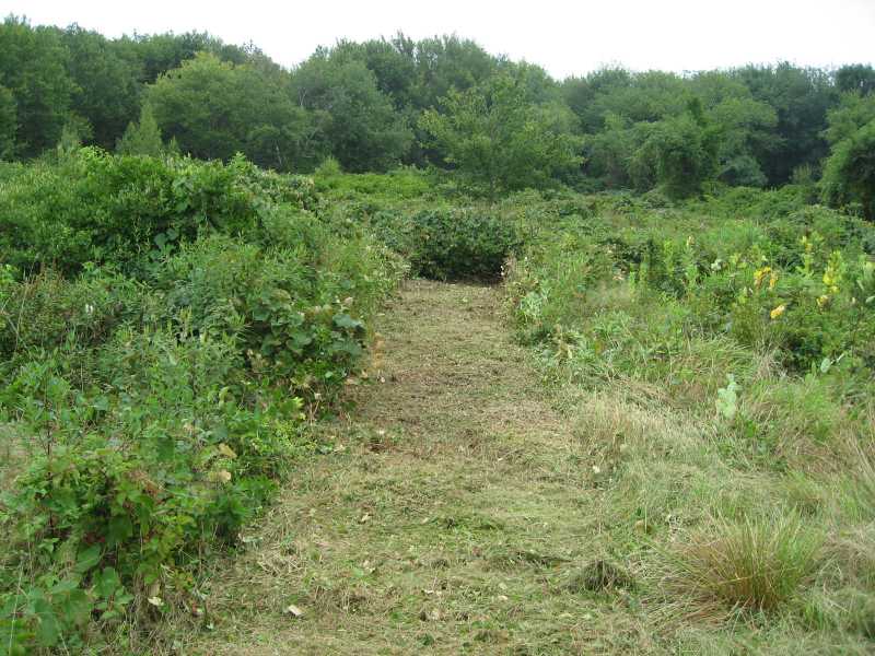

Here are another set of photos showing thick brush and the Caroni flail. I drove one direction (forwards) then turned around and came back widening the cut. In this area I knew the field used to be mowed and did not have a lot of debris in it so I lowered the closed grapple as a probe and just drove through. The cut is pretty fine and what is really noteworthy, compared to doing this with a bush hog, is that there are not a lot of broken sticks tossed around. The flail really mulches the brush much better than a rotary mower.
