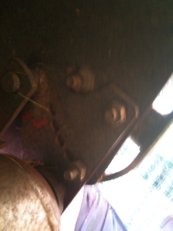

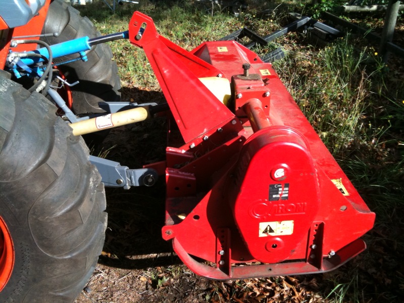

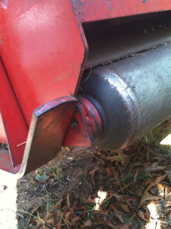

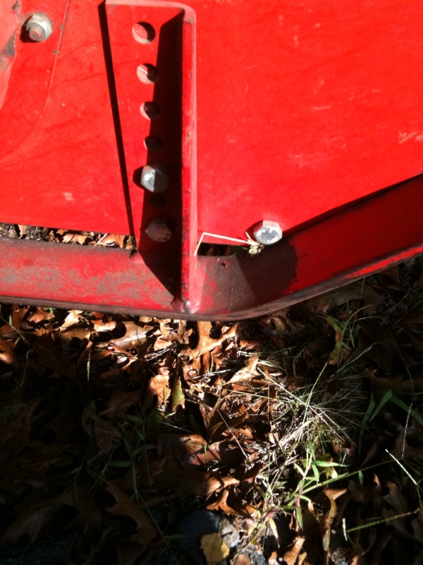

Big Bri, I know what you are talking about. JJ is correct that your flails should not be that low. There are two possible adjustments. First (easiest and temporary) is to tighten/raise the topping lift so the front of the mower comes up. As the pivot point is all the way at the end of the mower, that will raise your blades as the blade rotor is forward of the rear roller. That will fix it immediately when you are in the field. However, as that also means the mower cannot float on the topping lift, it is not the ideal solution.
The proper solution is to lower the rear roller. On the Caroni the rear roller pivots and you can choose between about five settings. I think most of the mowers are shipped with the roller in the "up" position (closest cut) to save space. Mine is set that way and I have not yet lowered it but I probably will soon. There are two bolts on each side that need to be loosened. The roller bracket pivots on the lower bolt so that just needs to be loosened. The upper bolt for the bracket also is part of the skid attachment so you'll need to remove that and then replace it after pivoting the roller downwards. I may not be doing a good job of technical writing here but believe me it is quite obvious once you look under the mower. Photos below may help.

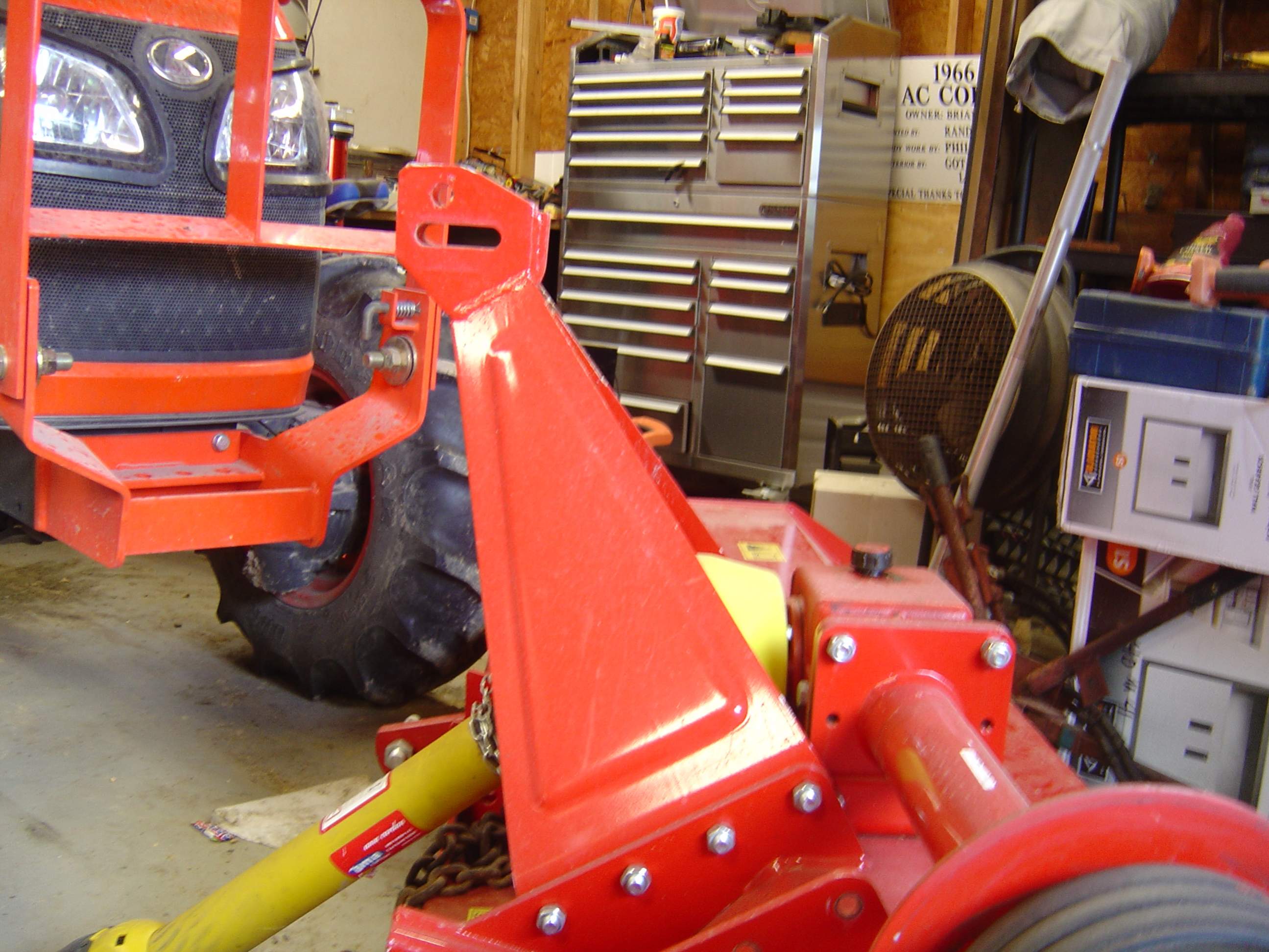

island, in the last pic you put up of the mower, the mount where the top link goes. Mine is a little different, my slot goes horizontal not up and down like yours. this is how mine was shipped. should i change it?
