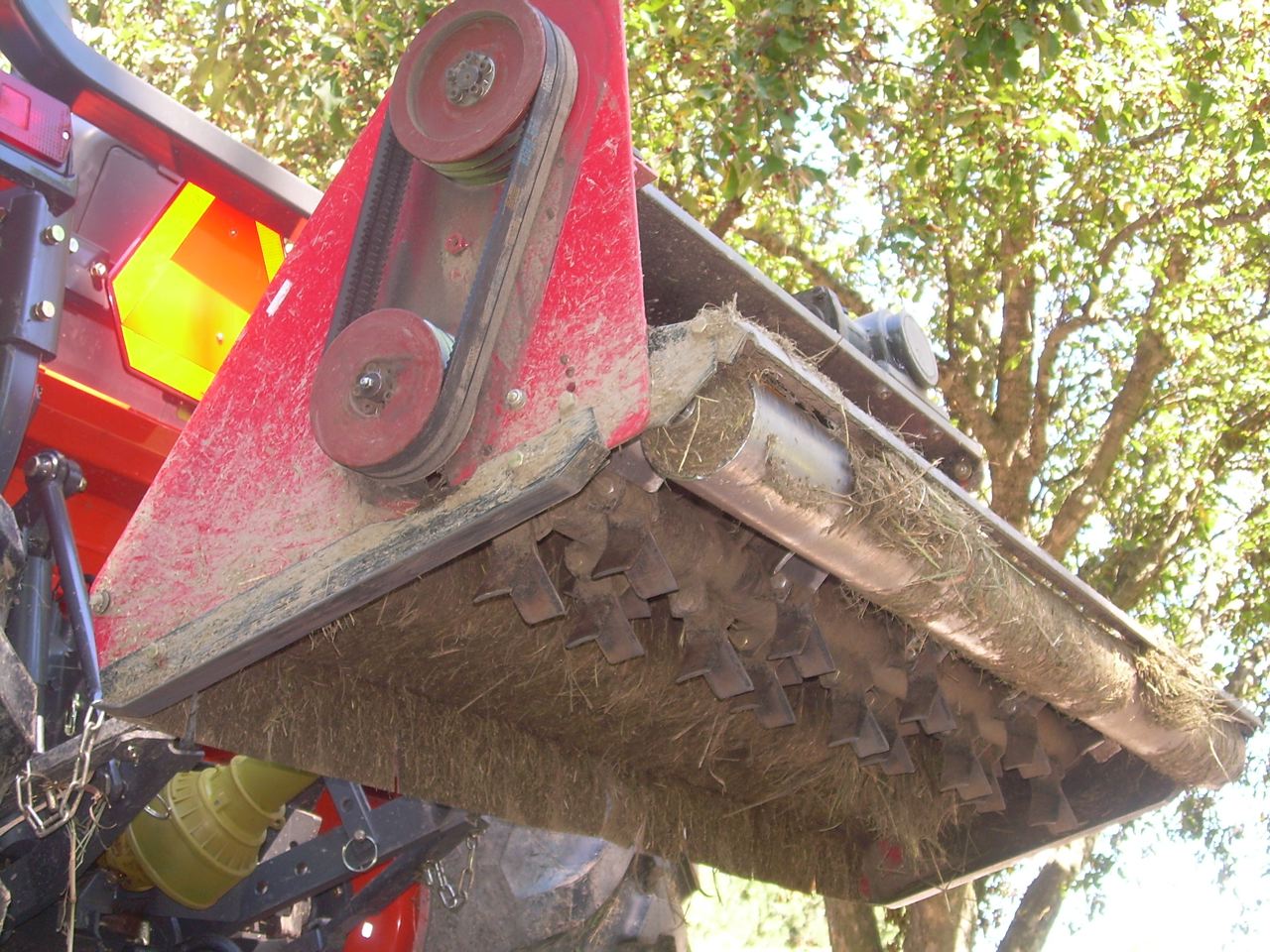

I recently bought a Bush Hog flail mower - - an older model. It's in great shape but I couldn't figure out how to adjust the mowing height. I bought a parts manual off ebay and have learned that this model had wheels mounted on a steel tube on the back. It has the steel tube running across the back but no wheels. Caroni flail mowers have skids mounted on the side. I could make and attach similar skids or make wheels for the mower similar to what it came with. Question is whick one works better? Do the skids leave ruts or cause problems? I do want to be able to adjust the height - - it cuts too close the way it is set up now.

Flail mower cut height is most easily set by adjusting the height of the long rear roller and then using the 3pt lower arms to level the mower. I don't know the Bush Hog model and how it is set up but that is how the Caroni flail cut height is set. The skids are really more for protection than cut height and they are not even necessary.

To protect the mower from digging into the ground on bumps/hills. With the roller in the back, the front end can bottom out, so the skids are meant to be the lowest point of the mower to prevent the knives from grounding out. A set of gauge wheels out front would also do the job, but skids are simple and cheap.

Pardon the dirty picture :) but those skids almost never touch the ground, just the roller. The roller is adjustable via the bolt holes, which controls cutting height. You will also want to raise the front of the mower slightly higher than the rear via the top link.

Thanks for the info and picture. I looked at my mower in more detail and the roller is adjustable with three holes in the frame - - doesn't seem like much adjustment. The lower arms that connect to the three point hitch also were adjustable but somebody welded them in a fixed position for a lower cutting angle. Looks like I have some grinding to do but should be able to raise the mower between the roller adjustment and the bars. I now have no idea why it came with wheels on the rear bar. Maybe to raise the mower way up?
