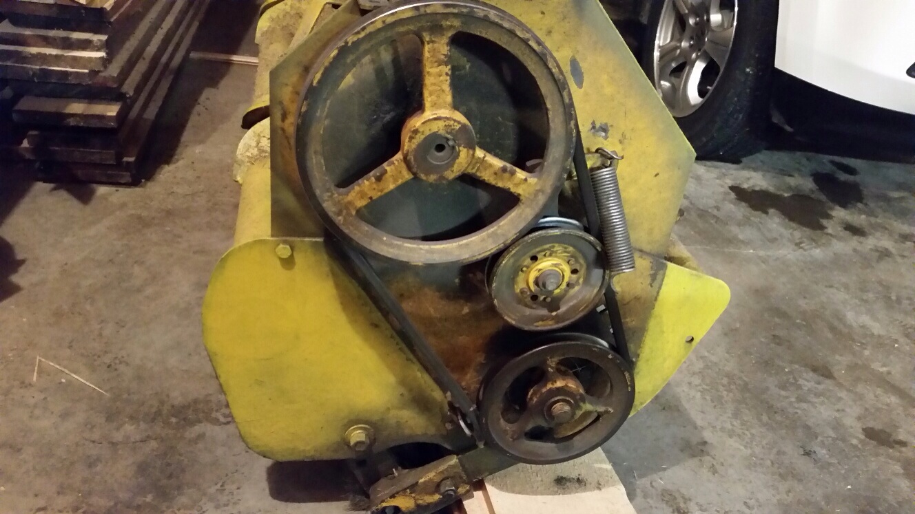

I have revisited the flail drive system and compared with one on the other thread. They are identical in the way the idler pulley is mounted and the spring end mount. The one with the broken spring is the one on the other thread and the one with the working spring is mine. I do not see any other way it can mount. The spring pulls upward toward 11 o'clock in the photos. Comments?? 20171001_133538.jpgimage tractorbynet.jpg

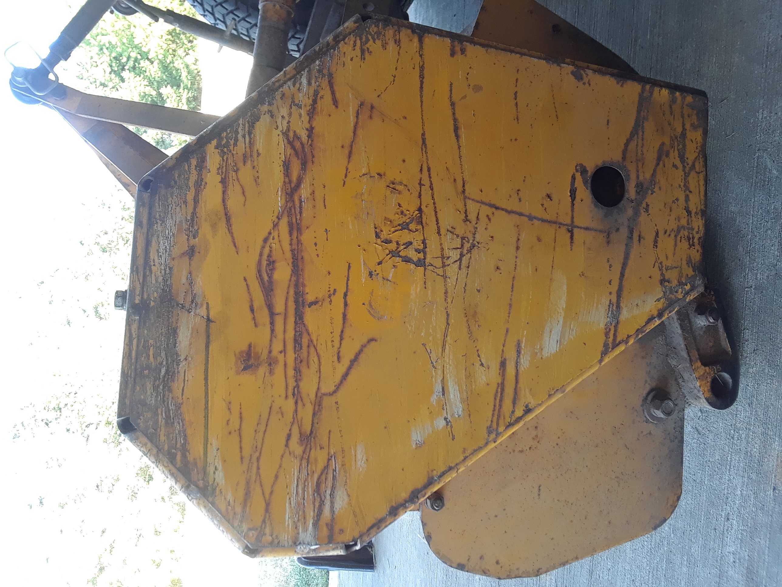

The photo of the guard is from mine. It has right hand drive. 20171002_160450.jpg It is for sure a Mott. 48"

You have 2 springs there it should only have one long one.
   / Flail Mower Identification #13
Looking at your photo you posted, that definitely is an inside idler pulley. Belts look to be set up correctly other than as Leonz stated probably one tension spring instead of the 2.

Thanks, Leonz and DoubleDeere, also found the zirk was missing from the idler pulley shaft and it was frozen up. So, double spring / frozen shaft, good thing I did not throw a belt. Cleaned it up and installed the zirk and greased the heck out of it and it works fine. Looks like the belt is too narrow. It sits well down in the pulley. Anyone know what the right belt is for it?
I am thinking the previous owner tried to install the new spring and it was too short so he doubled up. It does work but not with much tension. Will have to see if I can stretch that spring. Thanks
   / Flail Mower Identification #15
Yep I missed that one, looks narrow. If you haven't already you might want to take a look over in the let's talk flail mowers thread. Steave gives a link in post 4850 for belts and they have a section how to size them I believe B43K - B-Section Kevlar (K-Plus) V Belts. I also have an attachment and link to PDF's that you may find useful in posts 4837 and 4841. They are about v-belts and idlers (belt tensioners).
